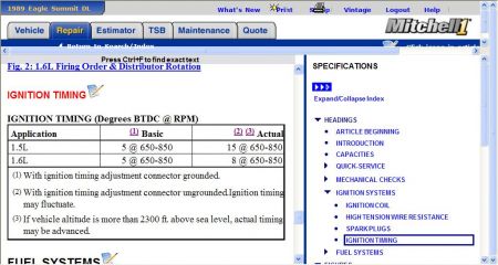

I need to find out where to set the timing marks for the crankshaft. looks like this( .10 . .T . )
89 eagle summit 1.5L

See below
https://images.2carpros.com/forum/automotive_pictures/12900_eagle_1.jpg
