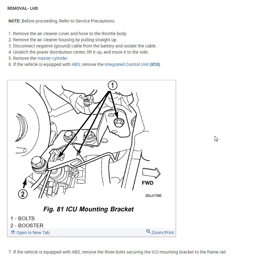

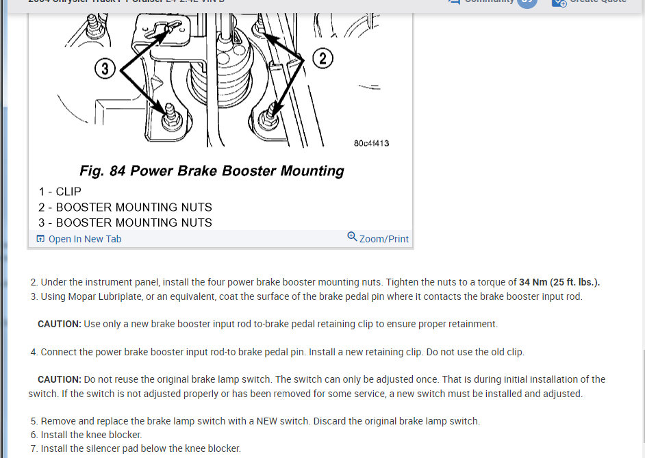

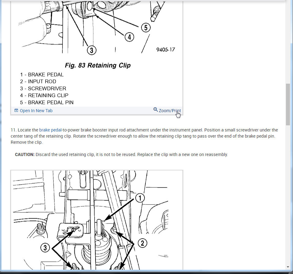

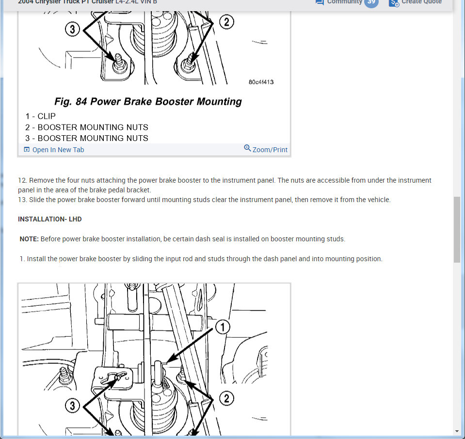

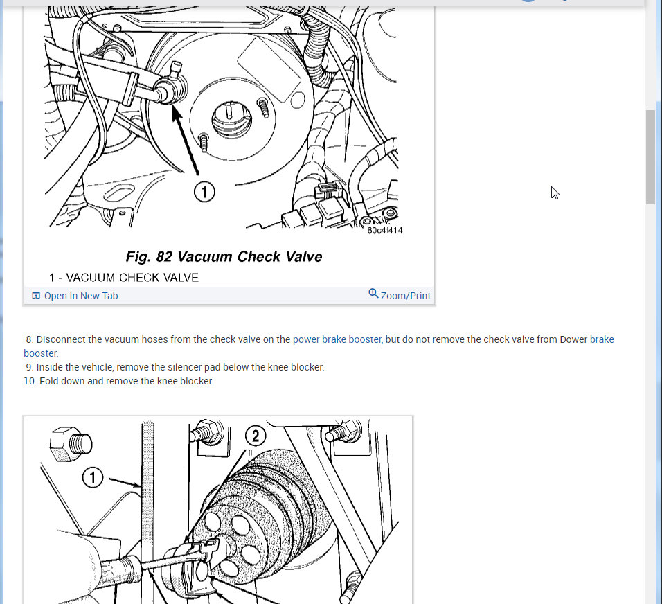

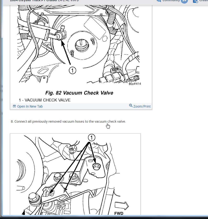

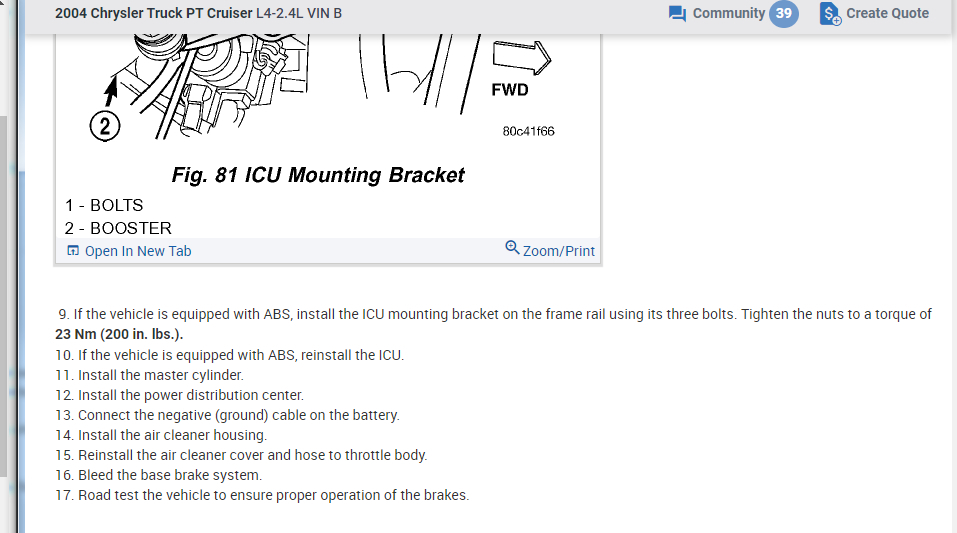

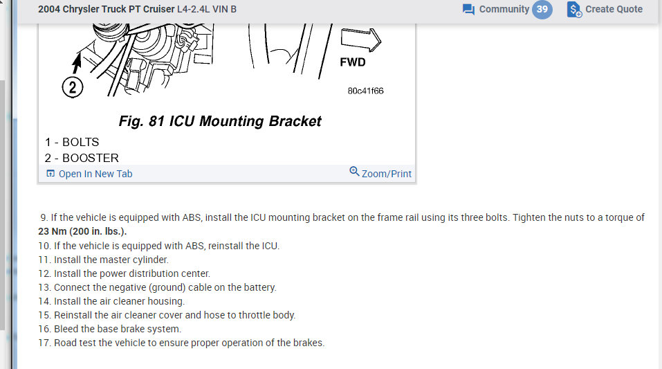

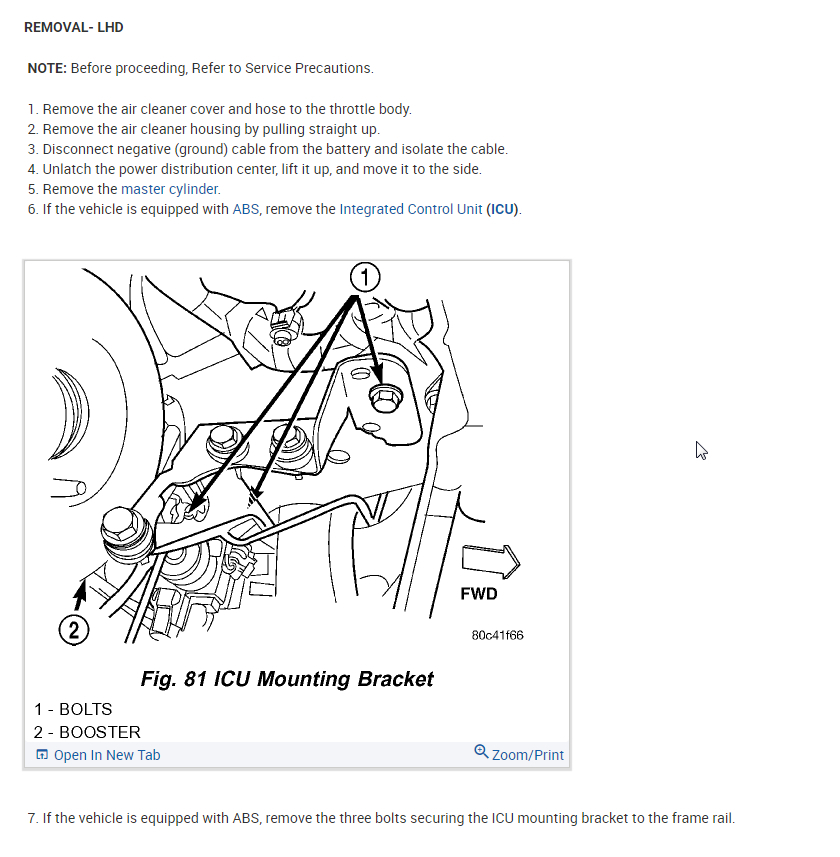

I cant get the brake booster loose what I am I doing wrong? What shall i do?
Dec 25, 2017 at 3:51 AM
Below you will find the instructions from the manual on how to replace this. Please run through this material and let us know if you have other questions. Check out the diagrams (Below). Please let us know if you need anything else to get the problem fixed. Thanks
