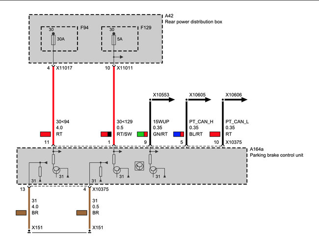

So if the reset doesn't work and you have a mechanical fault code i would advise trying to disconnect the EMF control unit leave it disconnected for 10 minutes and then plug it back in and retry.
After that if there is no change then i would advise checking for power and ground at the control unit connector.
With the unit plugged in and ignition on check for voltage between pins 11 and 13.
Then check for voltage between pins 1 and 4
Let us know what you get here. You should have battery voltage - approx. 12V

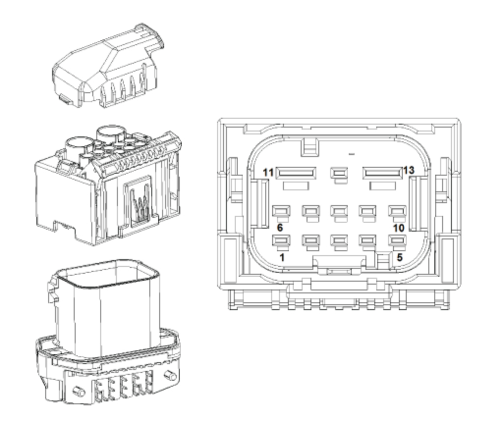

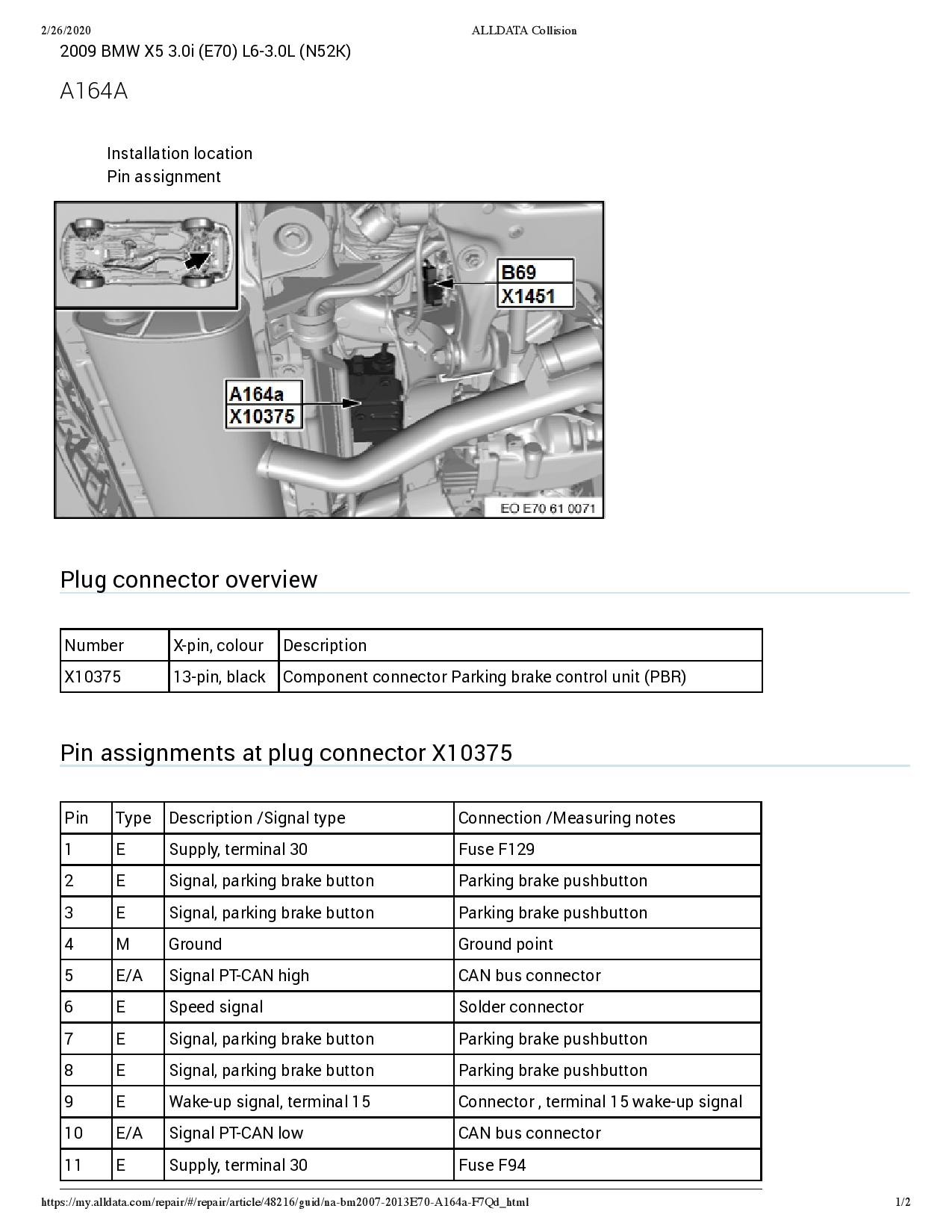

Hey NASER NASER,
The park brake control unit is one unit mounted above the differential as you describe.
There will be two park brake cables coming out of the unit and one plug connection.
The plug connection is X10375 shown in the pictures below.
You shouldn't need ignition on to check for power here as they show permanent feeds on the diagram. I would test with ignition on just to be sure.

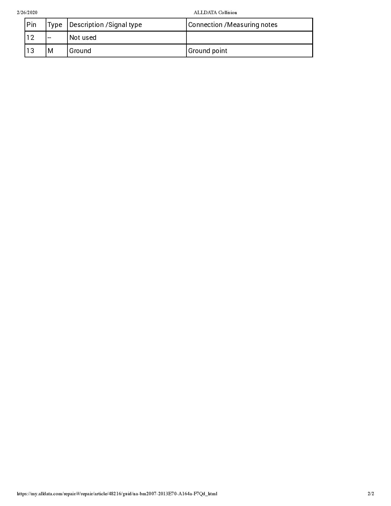

Please unplug the unit, turn the ignition on and check for power between the pins 11 and 13, pins 1 and 4 as i said previously.
Pins 11 and 13 will be the main feed/ground for the motor and pins 1 and 4 will be control unit power and ground.
It sounds like you have input from the switch so if these power and grounds check out okay i would then inspect the park brake mechanical system. If this checks out okay i would replace the park brake control unit.
Regards, Joe

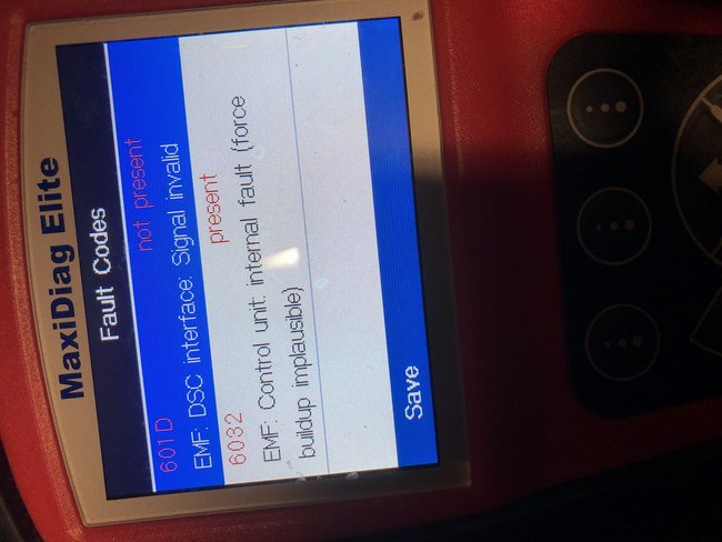

after putting everything together with a new cable for the passenger side and a new motor inside the control box, I tried to pull the e-brake and still the same message, but this time there is not even any noise as if it is trying like it did before it used to make at least a noise. When I removed the control box I let the car down and was driving it until I get the passenger side cable....and I was getting a code for EMF or something like that which is because the e-brake connector was not connected to anything, so I drove it for 10 days, not sure if some dirt got in the connectors and caused a fuse to blow or what, but connecting the harness does nothing, usually it will immediately give me a noise on the dash and the yellow light, but connecting it now won't do anything. still have the yellow light though.i tested the motor outside and everything was working fine...the 129 fuse in the back is okay.
Mar 25, 2020 at 7:21 AM
NASER NASER
  • 836 POSTS
It makes a clicking noise if i clear the code but then comes back and does nothing. then i cleared it two more times. now no noise at all and has this code.
Mar 25, 2020 at 9:02 AM
