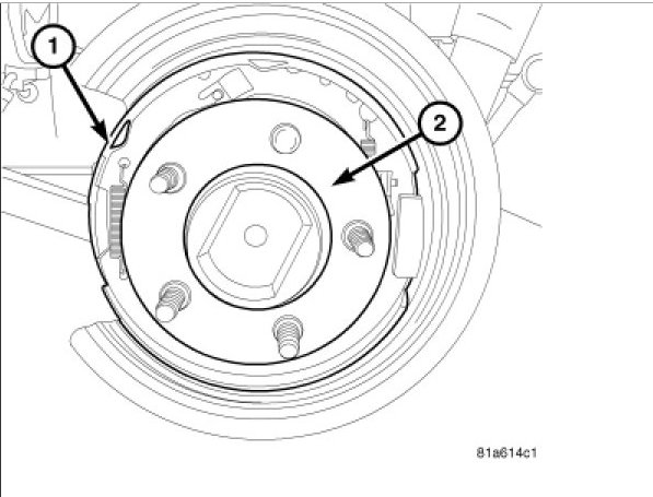

The e brake does not hold. It is not part of a recall. How do you adjust that brake? I pumped it and it did not adjust, there is no place to adjust with brake spoon, etc. Thanks for help.

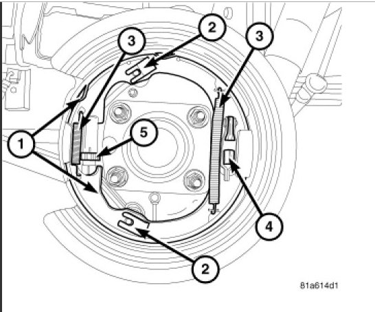

It could be because the parking brake shoes are worn out and this is why it is not holding. This happens when the car is driven with the parking brake on.
Here is a guide to help you see what you are in for when changing the parking brake shoes:
https://www.2carpros.com/articles/parking-brake-shoe-replacement
Here are some diagrams of how it will be on your car (below).
REAR DRUM IN HAT PARK BRAKE (ROTOR INSTALLED) USING ADJUSTING TOOL
Adjustment can be made with a standard brake gauge or with adjusting tool. Adjustment is performed with the complete brake assembly installed on the backing plate.

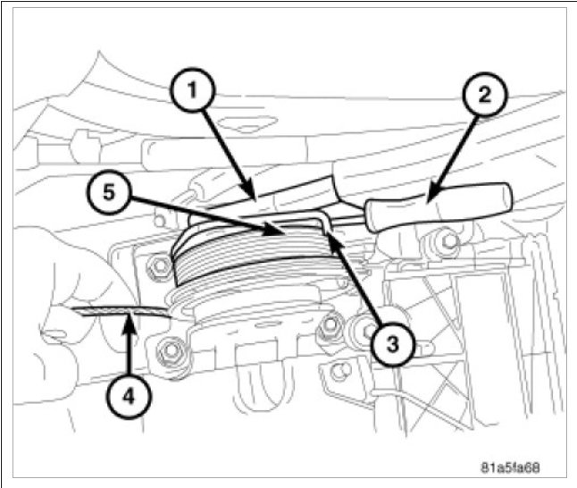

Loosen parking brake cable adjustment nut until there is slack in front cable.

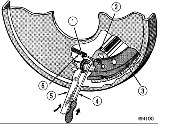

Insert adjusting tool through support plate access hole and engage tool in teeth of adjusting screw star wheel.
Rotate adjuster screw star wheel (move tool handle upward) until slight drag can be felt when wheel is rotated.
Push and hold adjuster lever away from star wheel with thin screwdriver.
Back off adjuster screw star wheel until brake drag is eliminated.
Repeat adjustment at opposite wheel. Be sure adjustment is equal at both wheels.

Adjust parking brake cable and lower vehicle.
Apply park brake hand lever and make sure park brakes hold the vehicle stationary.

REAR DRUM IN HAT PARK BRAKE (ROTOR REMOVED)
Under normal circumstances, the only time adjustment is required is when the shoes are replaced, removed for access to other parts, or when one or both rotors are replaced.

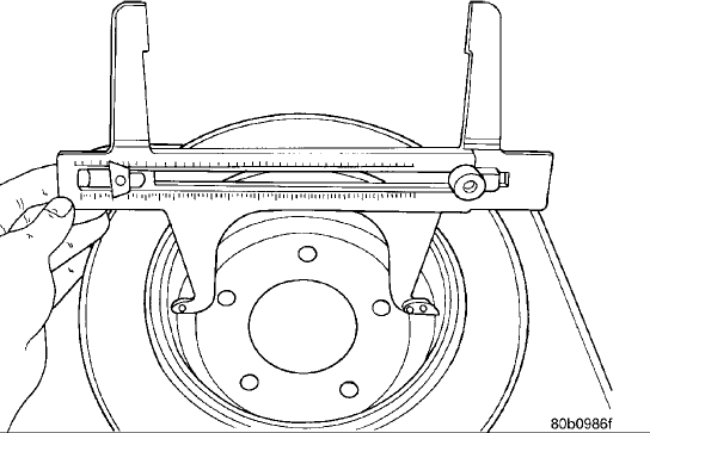

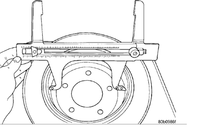

NOTE: When measuring the brake drum diameter, the diameter should be measured in the center of the area in which the park brake shoes contact the surface of the brake drum.
Using Brake Shoe Gauge, Special Tool C-3919 (1), or equivalent, accurately measure the inside diameter of the park brake drum portion of the rotor.
Using a ruler (2) that reads in 64th of an inch, accurately read the measurement of the inside diameter of the park brake drum from the special tool.
Reduce the inside diameter measurement of the brake drum that was taken using Special Tool C-3919 (2) by 1/64 of an inch. Reset Gauge, Brake Shoe, Special Tool C-3919 (2) or the equivalent used, so that the outside measurement jaws are set to the reduced measurement.
Place Gauge, Brake Shoe, Special Tool C-3919 (2) , or equivalent over the park brake shoes. The special tool must be located diagonally across at the top of one shoe and bottom of opposite shoe (widest point) of the park brake shoes.
Using the star wheel adjuster, adjust the park brake shoes until the lining on the park brake shoes just touches the jaws on the special tool.
Repeat step 8 above and measure shoes in both directions.
