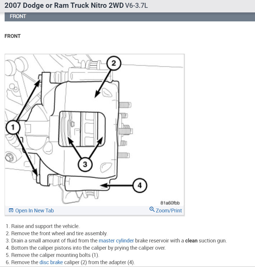

Please send detailed instructions on replacing front and rear brake pads on a 2007 Dodge Nitro and information on parking brake.

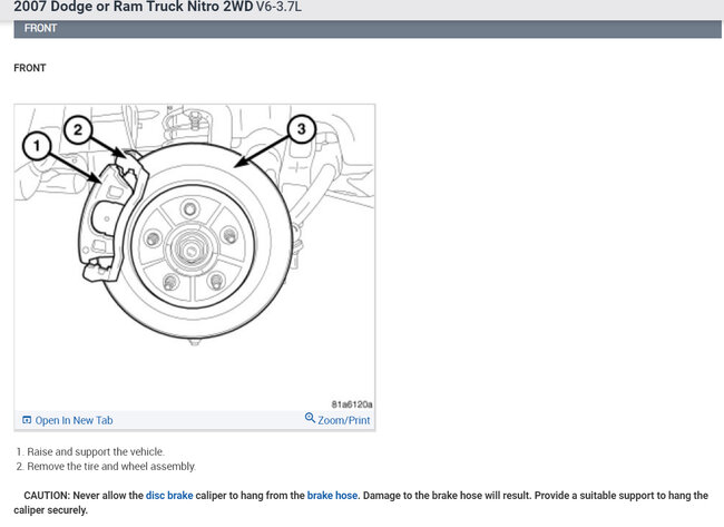

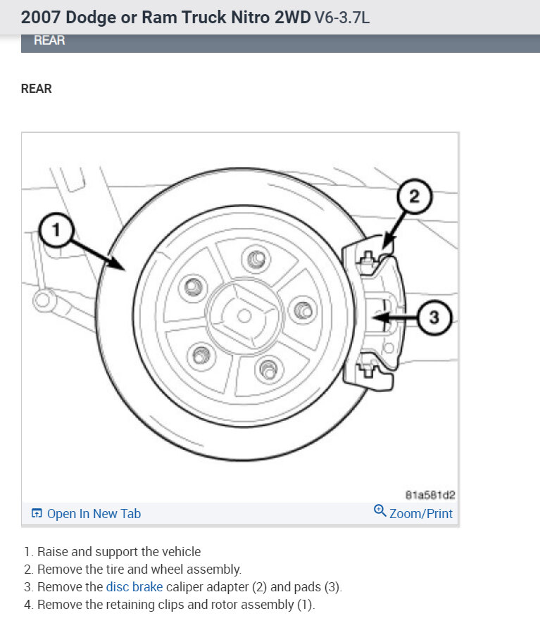

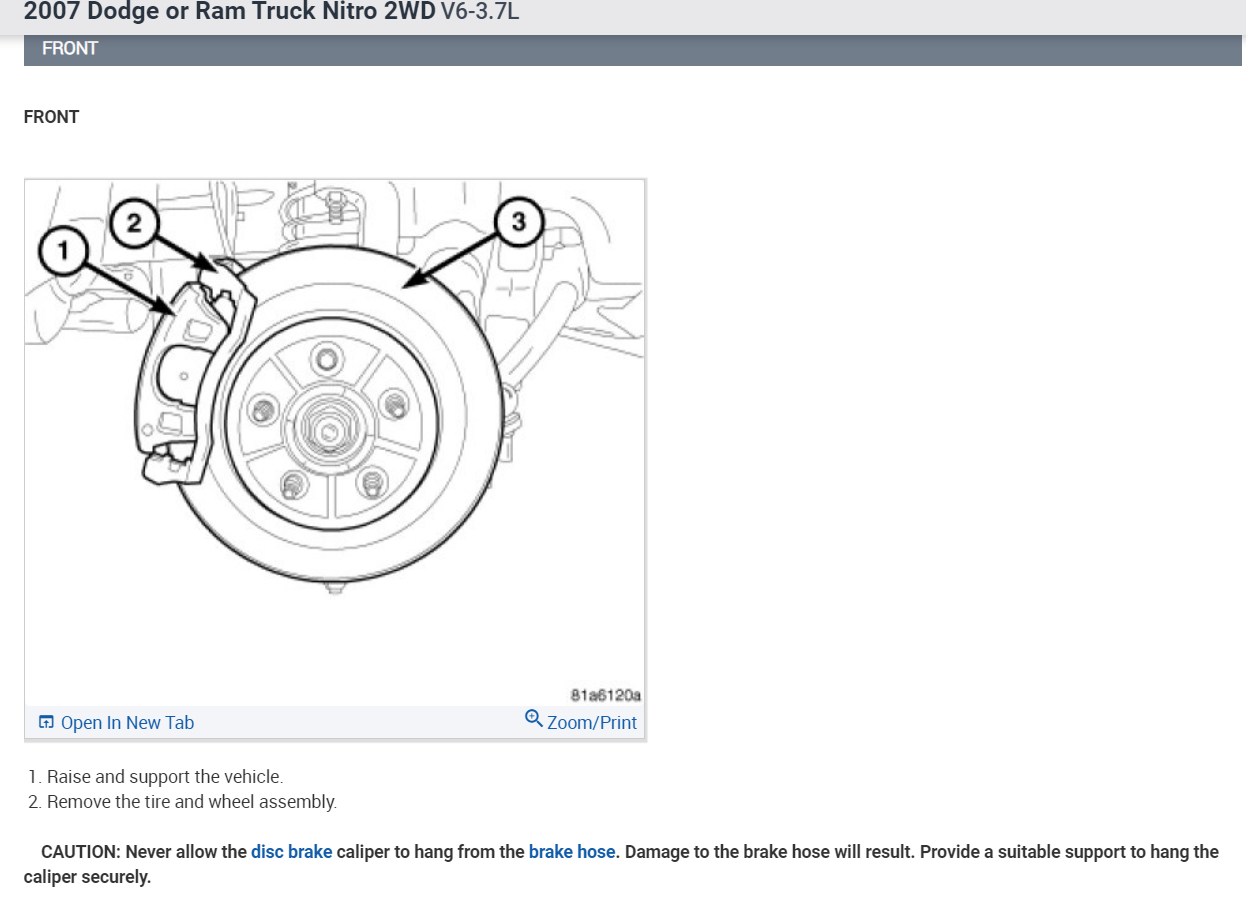

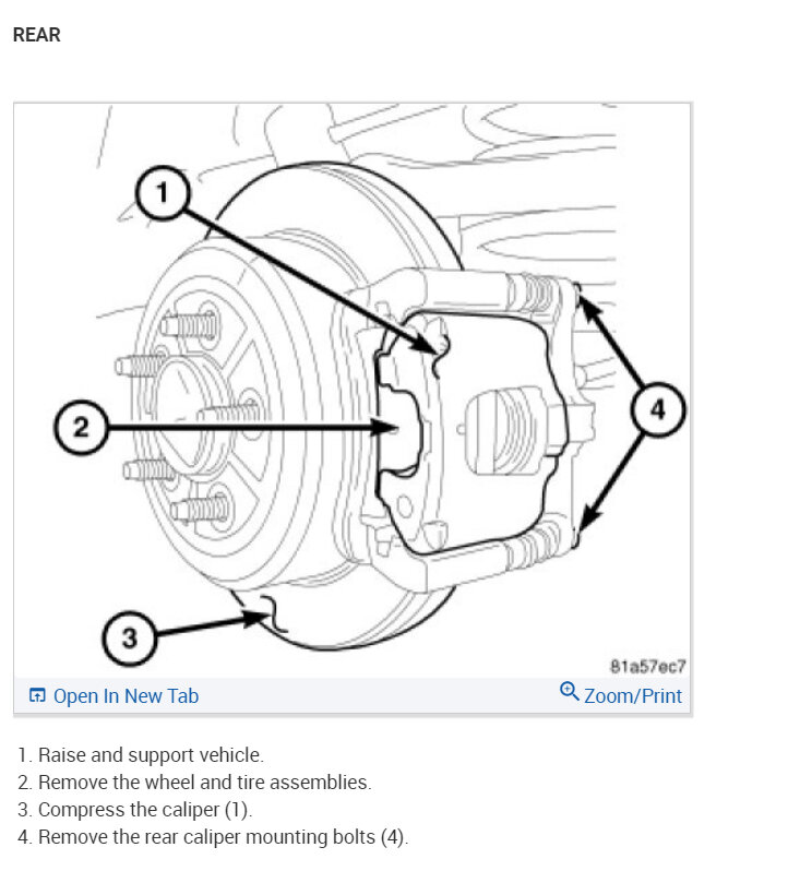

Here are two generic guides to help walk you through the brake job and instructions in the images below.
and
https://www.2carpros.com/articles/how-to-replace-rear-brake-pads-and-rotors
and
https://www.2carpros.com/articles/parking-brake-shoe-replacement
Check out the images (Below). Please let us know if you need anything else to get the problem fixed.
