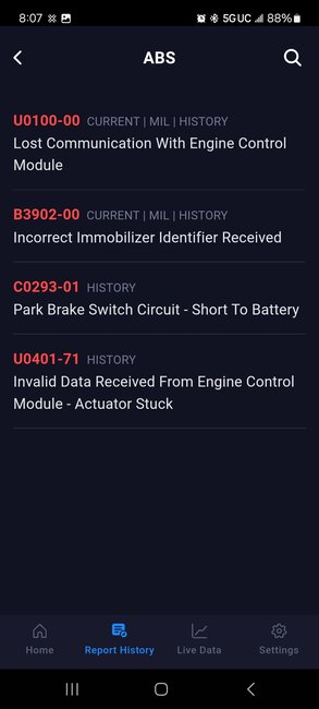

I bought an OBD II. Here are the codes. Seems they caused the problem during the repair. I hope he doesn't try to charge me labor to correct it.

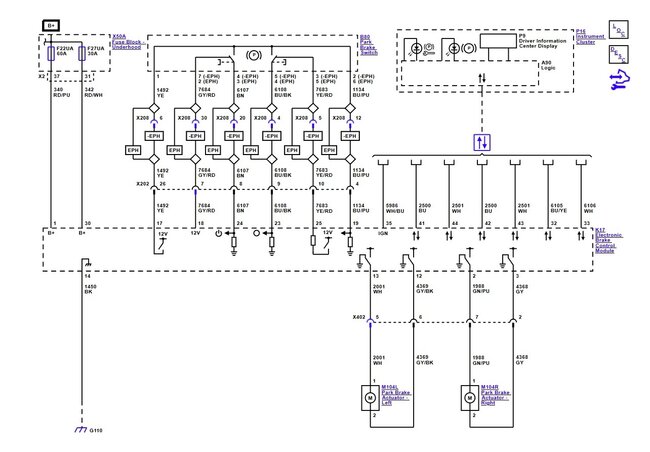

Possibly a bent pin or bad EBCM. The codes indicate a couple of problems but the brake code is a history code so it will take some testing with a bi-directional tool and doing the reset to see what is going on.
