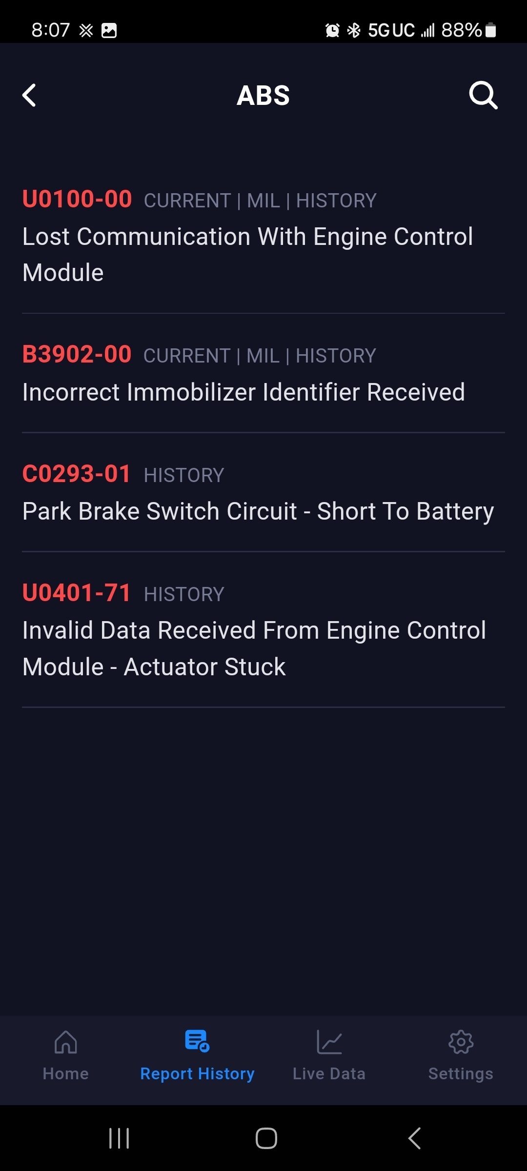

I bought an OBD II. Here are the codes. Seems they caused the problem during the repair. I hope he doesn't try to charge me labor to correct it.

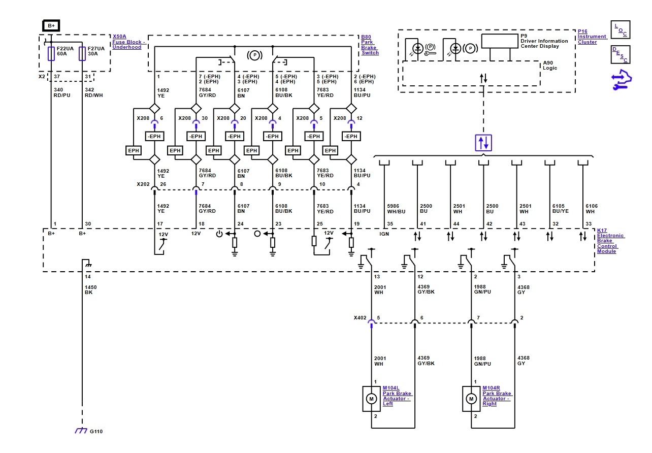

Possibly a bent pin or bad EBCM. The codes indicate a couple of problems but the brake code is a history code so it will take some testing with a bi-directional tool and doing the reset to see what is going on.

It could have been from the module if they replaced the entire unit. They would have put it into service mode and then may have forgotten the reset. It's also possible that it is something else, but because they did that work and it may simply be a missed step I would have them look at it to see if that is the case. It's also possible that the replacement module has a problem but without testing it there isn't any way to tell for sure.
