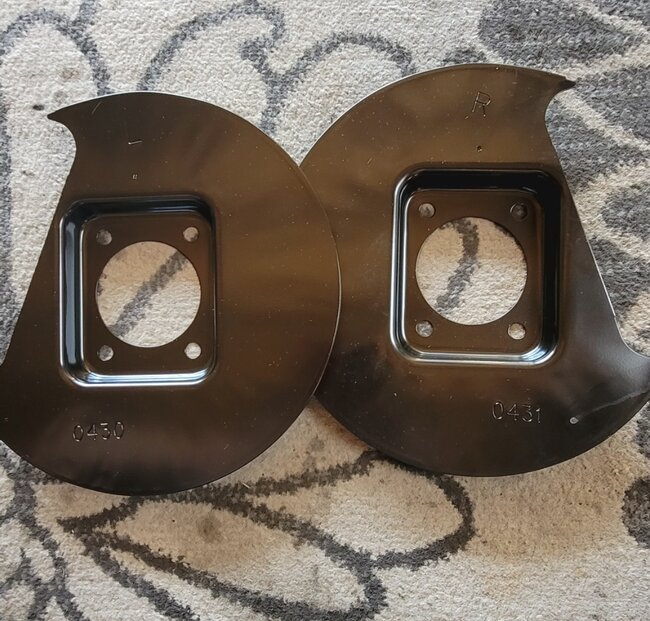

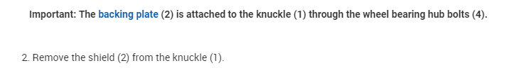

Hello, I'm wondering if I got the right covers for my back rear since I have parking brake assembly in the back. These parts numbers are 25990034 and 25990033 brought rocks auto.

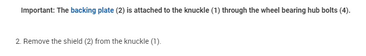

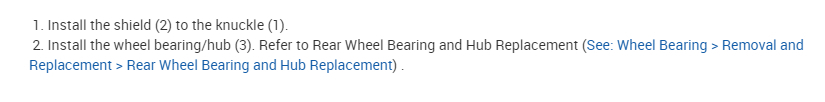

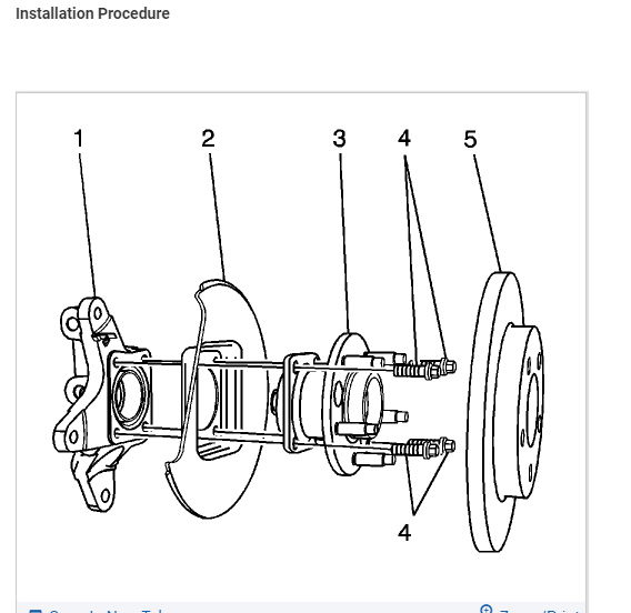

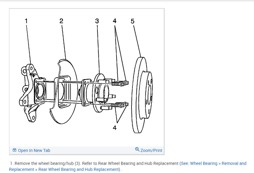

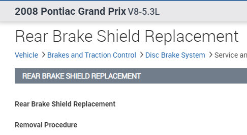

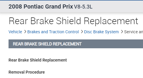

The part numbers you provided are OEM part numbers and are the correct ones for this vehicle.
I don't know if they are needed, but I attached the removal and replacement directions for this job below.
Let me know if this helps or if I can help in any way.

Okay. what about when I installed them, what about my parking brake shoe and actuator will it be okay to install with them also?
Apr 14, 2023 at 2:31 PM
  • 110,244 POSTS
Everything should be usable. The part, being OEM, should be the same part as the vehicle came with.
