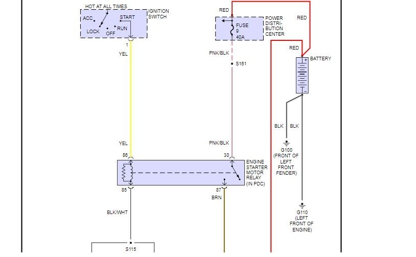

Would not start so I tried to jump and switched out the battery. It still did not start. I have checked all the connections and had a loose connection on the battery ground. Now it will not start with the key. I can manually engage the starter relay on the fuse box and it will start right up. I have changed out the relay fuse and the same thing happens. I can not get the starter relay to engage on its own. Any idea what I can try?

Good morning,
I attached a wiring diagram for you to view. Can you get a volt meter or test light to do some voltage tests?
Check the fuse listed for power on both sides.
Pin 86 should have voltage in the start position.
