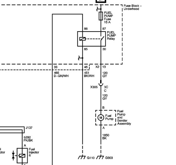

Installed new fuel pump and still no fuel pressure to crank?
FREDMAC2018
  • 2008 GMC ACADIA
  • 3.6L
  • V6
  • 2WD
  • 170,000 MILES

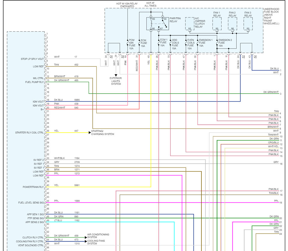

Installed new fuel pump and still no fuel pressure to crank. Fuses and relays are good. Is there a crank relearn I have to perform after changing pump?
Monday, March 12th, 2018 AT 11:02 AM
13 Replies
  • 52,797 POSTS
Good afternoon.
No, there is not re learn. It is a plug and play.
Did you verify power to the pump prior to replacing it?
Monday, March 12th, 2018 AT 1:36 PM
FREDMAC2018
  • 7 POSTS
No I did not. I guess I will have to drop the tank again and check it.
Monday, March 12th, 2018 AT 2:20 PM
  • 52,797 POSTS

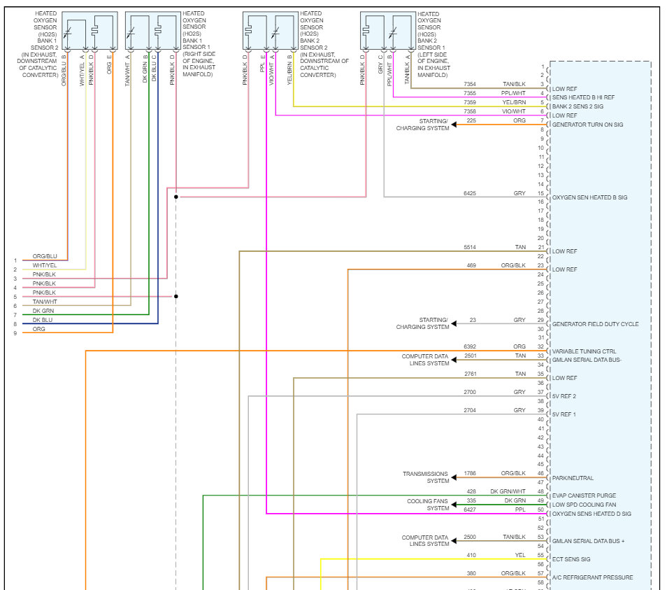

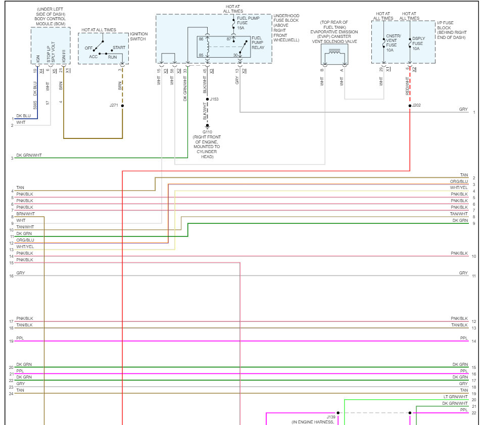

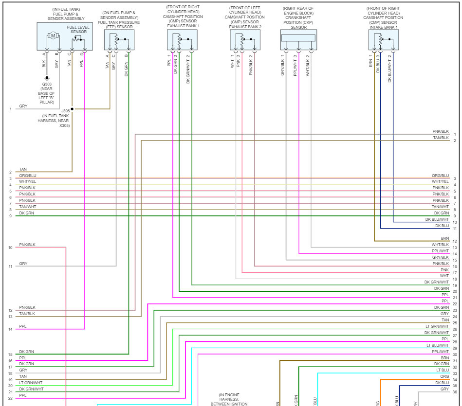

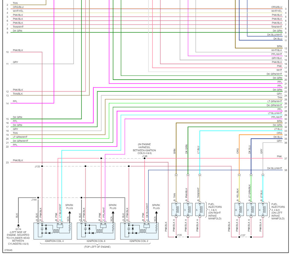

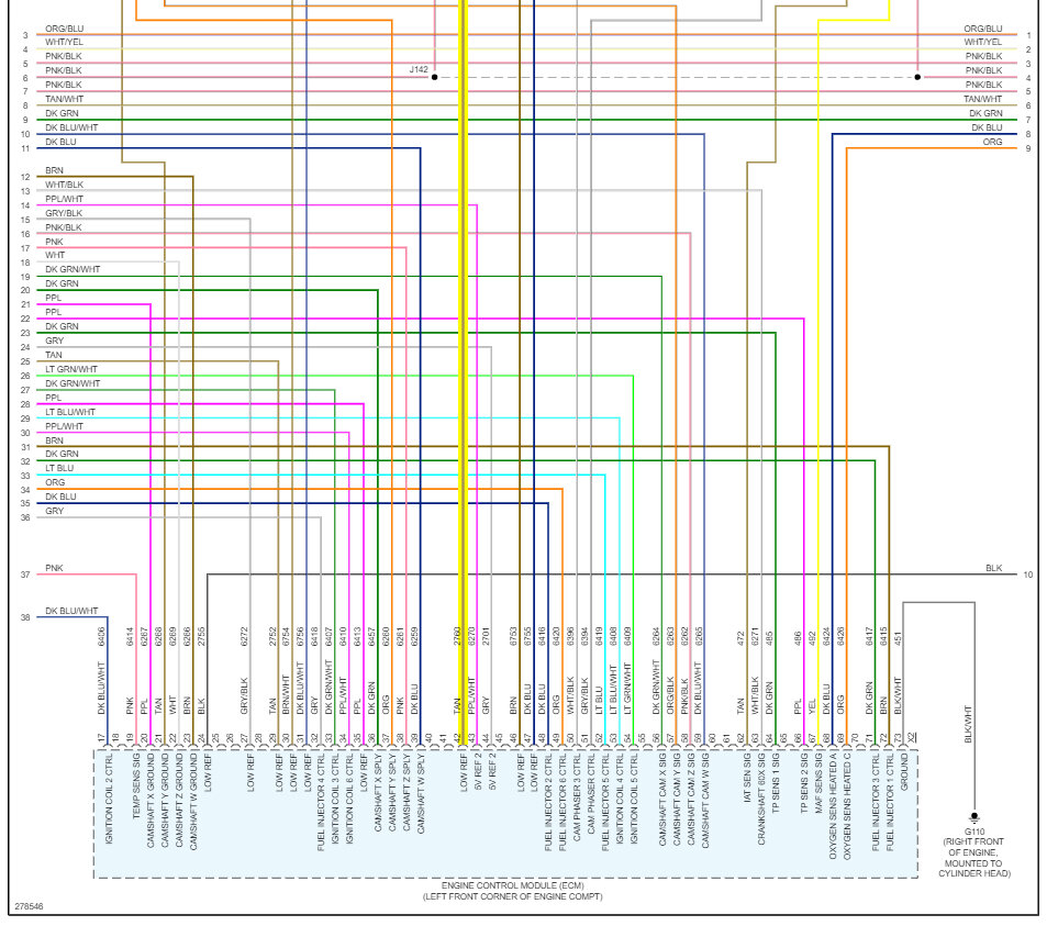

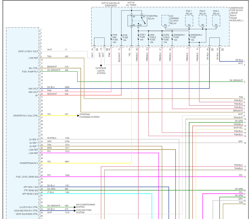

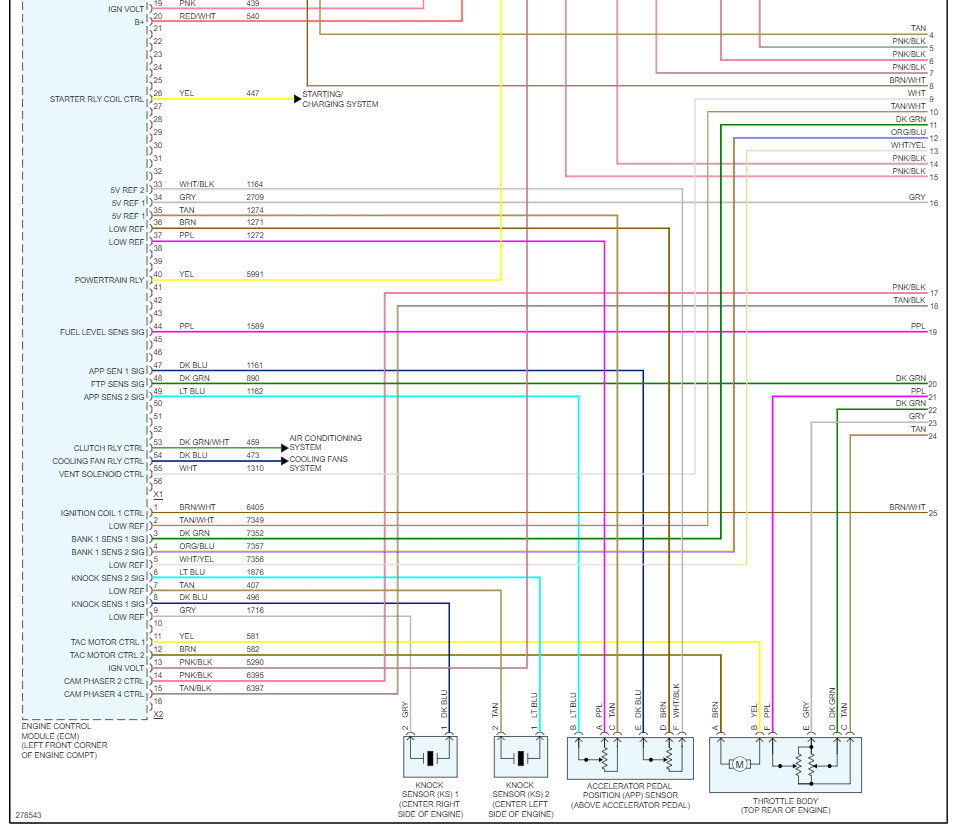

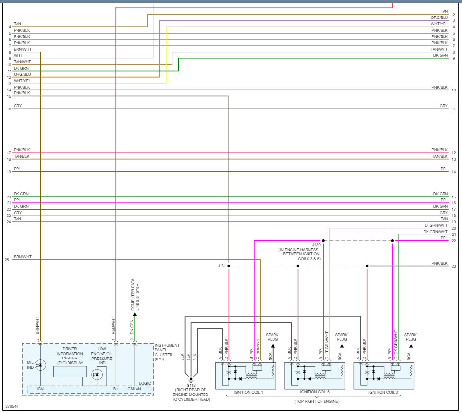

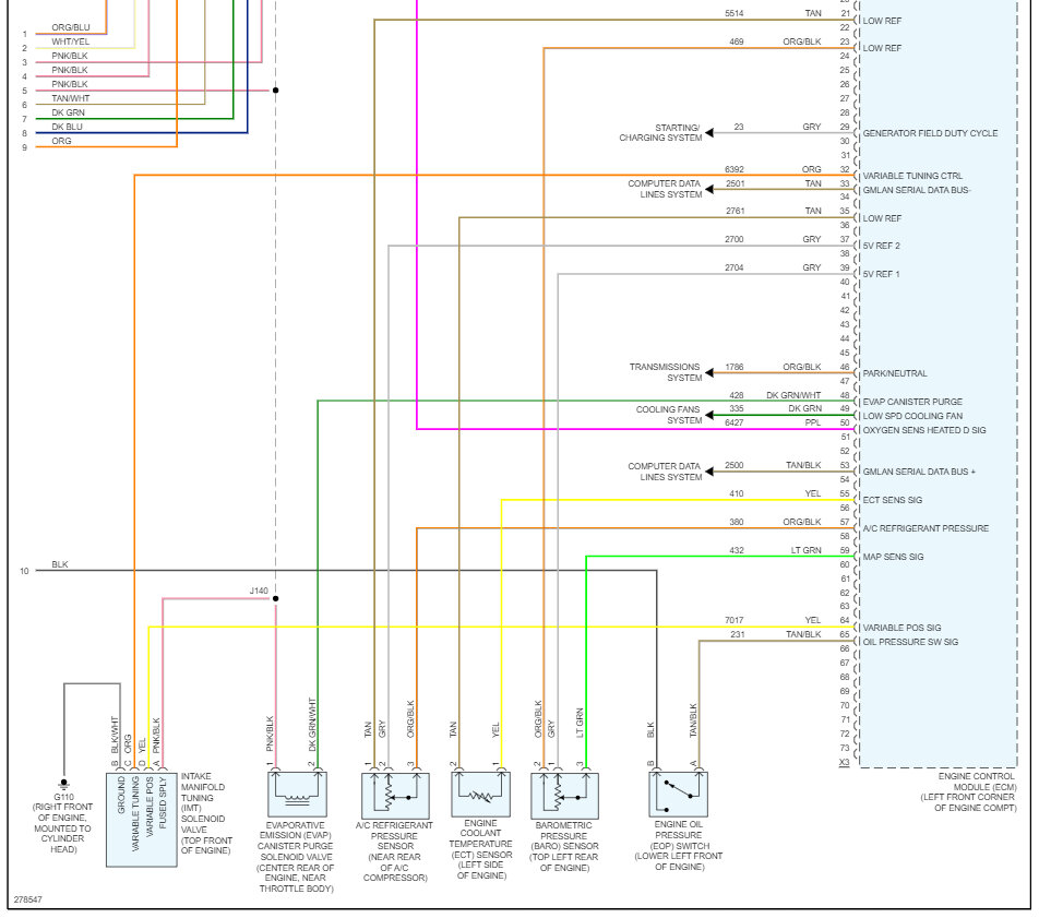

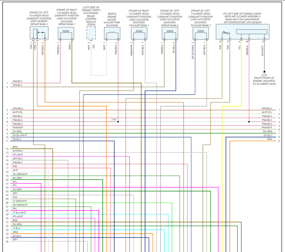

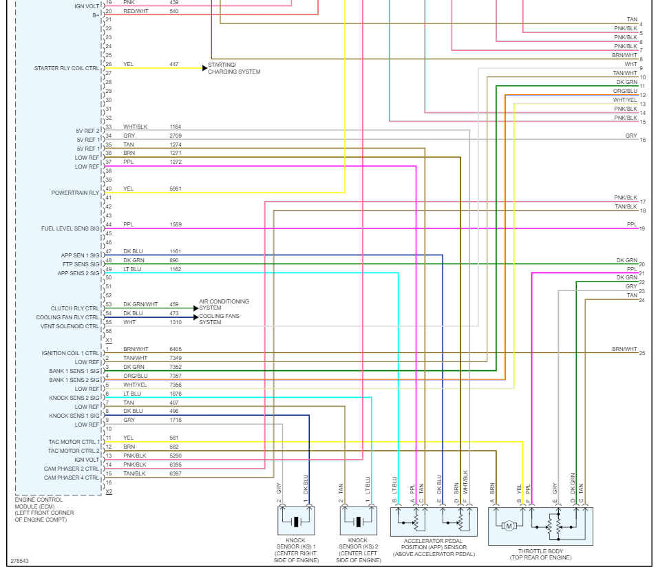

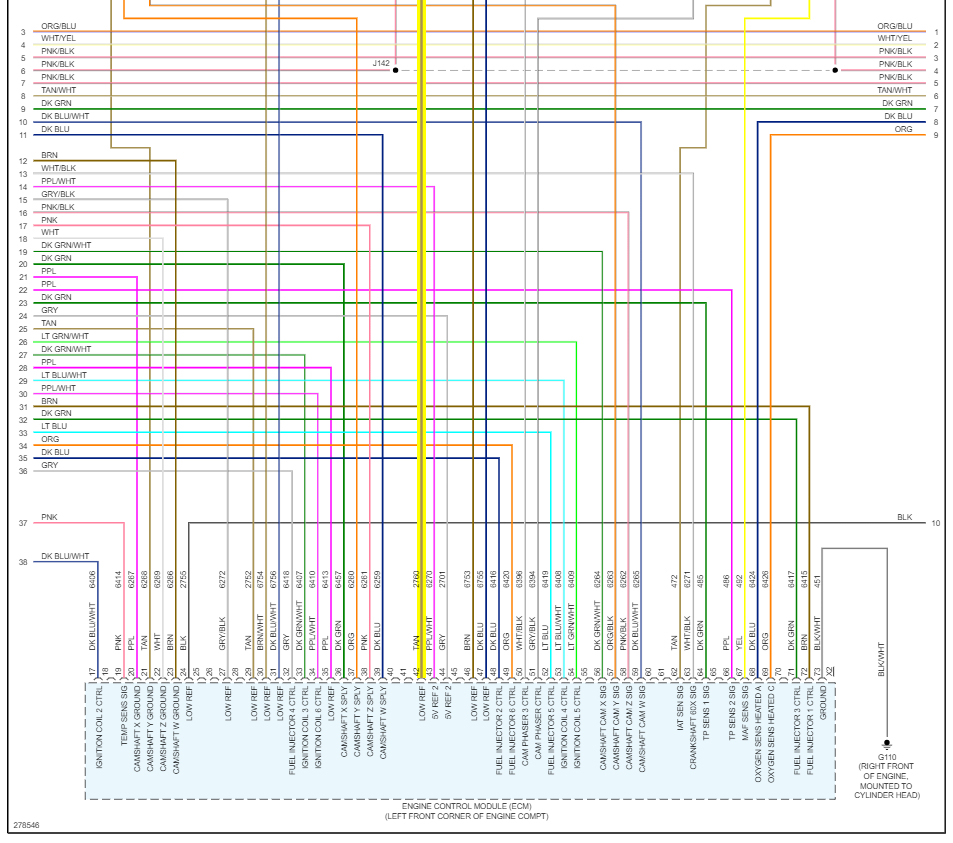

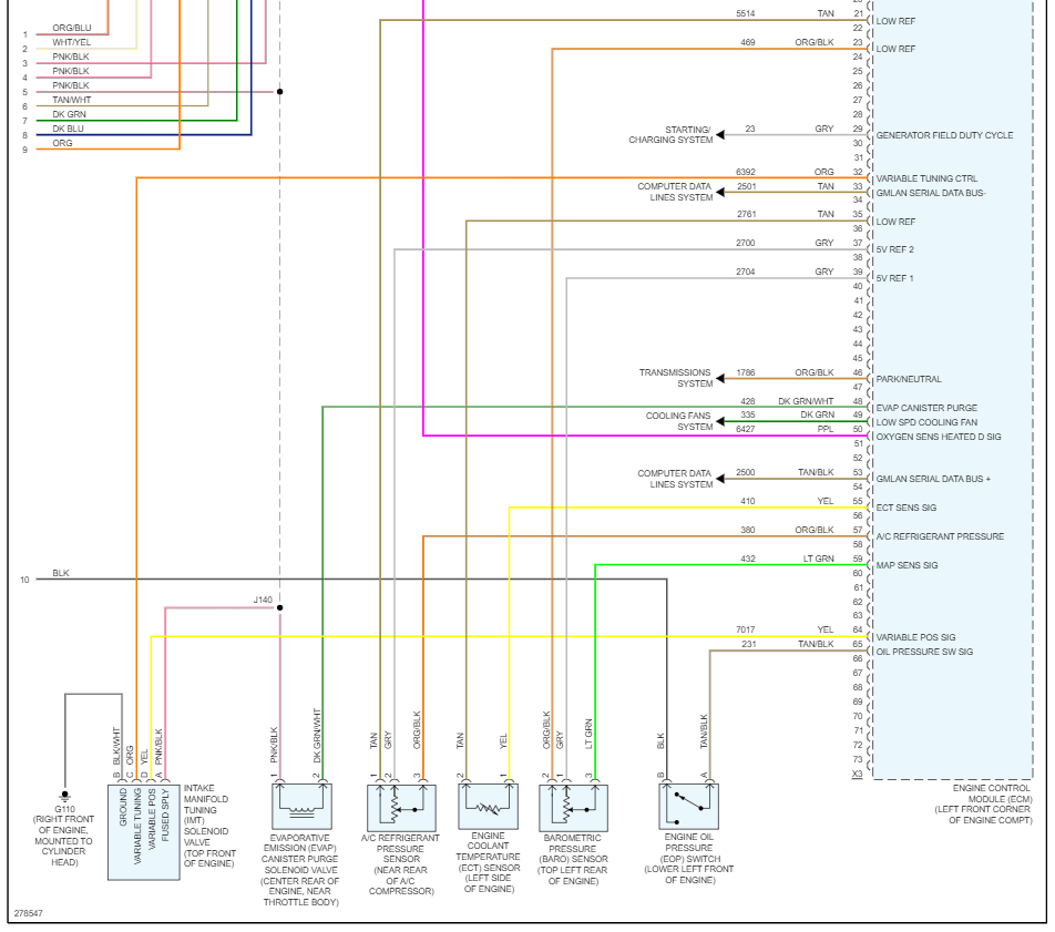

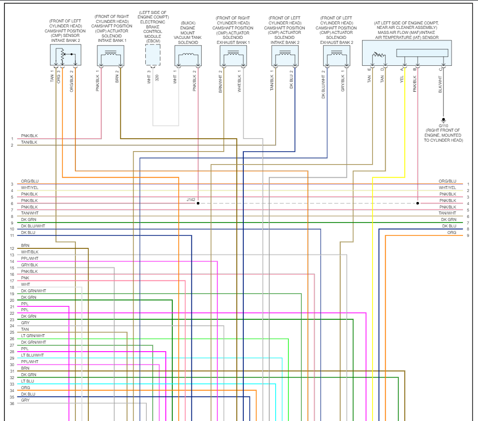

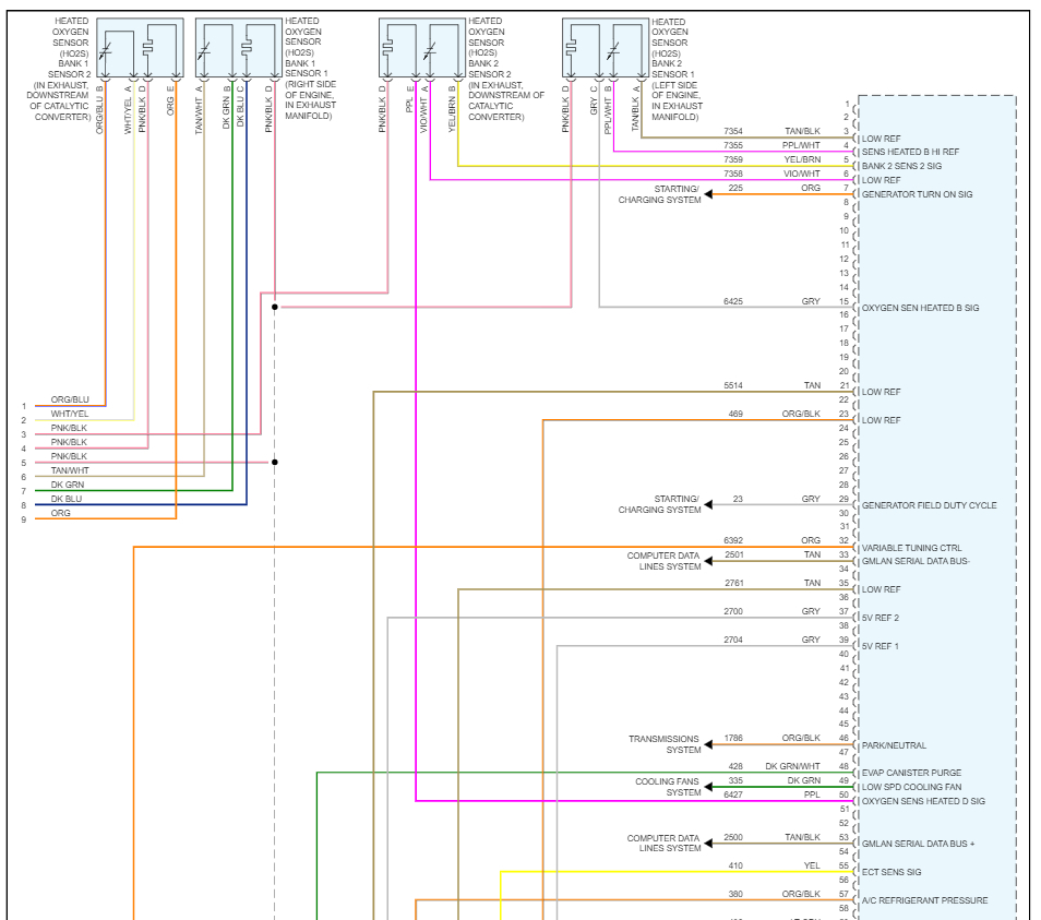

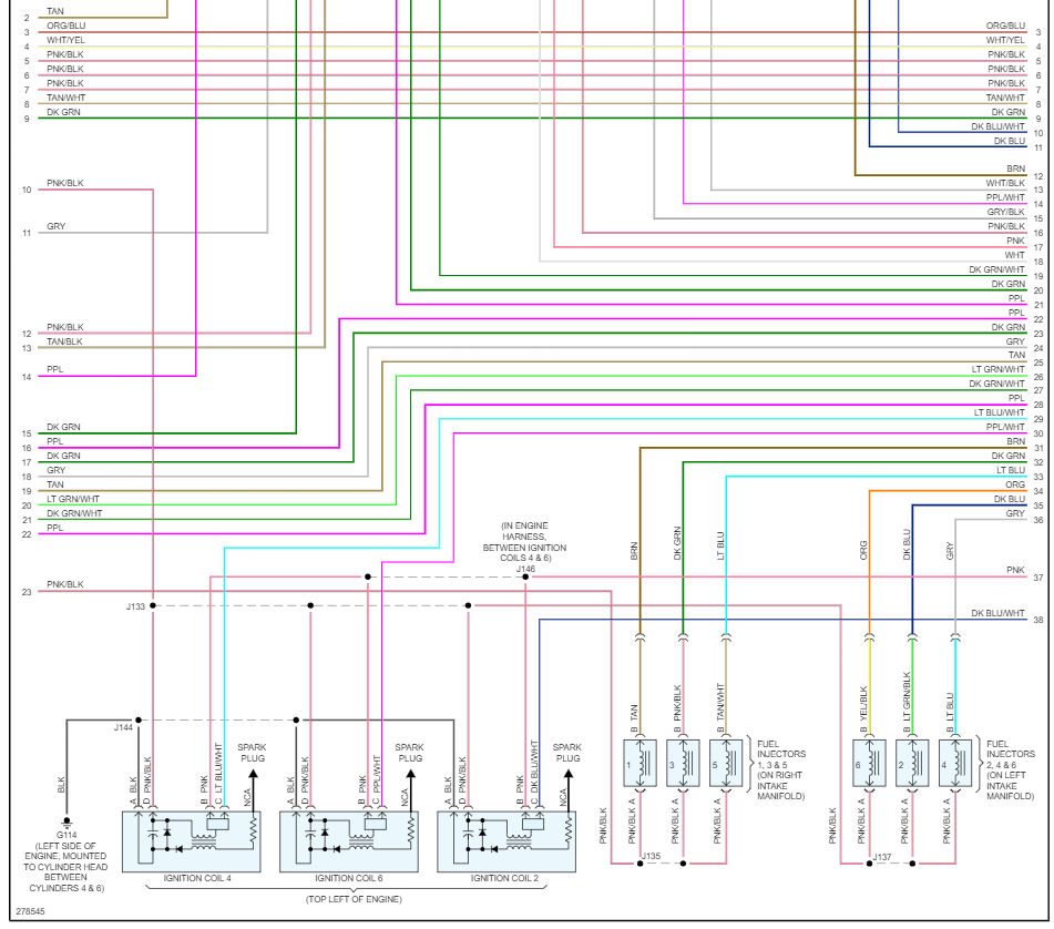

Before you do that, I attached a diagram for you to view to be sure you are getting power to the pump. At the fuel pump relay, jump terminals 30 and 87 and see if the pump runs. Here are the engine and fuel pump wiring diagrams so you can see how the system works. Check out the images (Below). Please let us know what happens.

Okay thanks. I will try it today.

It turned out to be the wiring harness was bad. I have ordered a new one. Thanks
