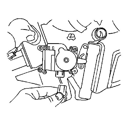

On the way to work this morning cold air blows on the driver side and heat on the passenger side no matter what I put the temperature on the driver side only stays cold.

It sounds like the blend door actuator for the left side has failed. What I would recommend is to remove it and see if it responds when you actuate it to work.
Here is a link that shows in general how one is replaced:
Here are the directions specific to your vehicle for replacement. the attached pics correlate with the directions.

1. Remove the left closeout panel.
pic 1
2. Disconnect the left air temperature actuator electrical connector from the actuator.

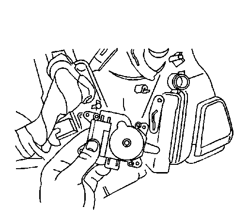

3. Remove the left air temperature actuator screws.
pic 2
4. Remove the left air temperature actuator.
