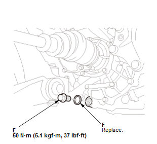

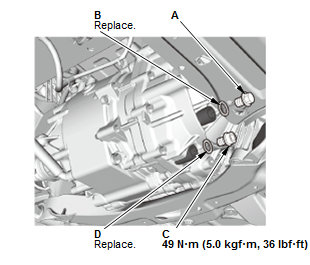

1.
Remove the filler plug (A) and the sealing washer (B).
2.
Remove the drain plug (C) and the sealing washer (D) of the gear box side, remove the drain plug (E) and the sealing washer (F) of the motor side, and drain the ATF.
NOTE: Remove metal particles from the magnetic surface of the drain plug.
3.
Install the drain plugs of the gear box side and the motor side using new sealing washers.

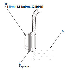

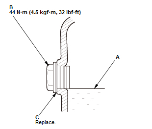

1. ATF - Refill
pic 3
1.
Refill the gear box with the recommended fluid to the proper level (A). Always use Honda ATF DW-1 Automatic Transmission Fluid (ATF).
NOTE:
Using a non-Honda ATF can affect durability performance and the cooling performance of the gear box.
Keep all foreign particles out of the gear box.
Automatic Transmission Fluid Capacity:
1.1 L (1.2 US qt) at fluid change
1.2 L (1.3 US qt) at motor/gear box assembly replacement
2.
Install the filler plug (B) using a new sealing washer (C).
