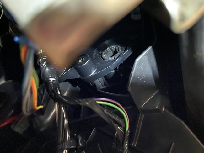

I have subsequently removed the new actuator, and to answer your question about the mechanism under the dash... No. The female receptacle for the actuator gear will not move whatsoever, and I took note that it appears to not even be seated deep enough (or far enough out, I'm not sure which) in the air distribution box. The female receptacle has two semi-circular wedges at the top and the bottom that fit perfectly into the hole it was designed for obviously, and just seems to be resting just deep enough in the formed hole so as to not allow any rotation. I attempted to push it in a little, but there's no give, and found that I could pull it outwards enough so that the wedges sat on the outside (basically on the cabin interior side of the box). I wasn't sure which was proper, so I sought advice here before doing anything else.
Are the guide wedges of the female gear receptacle supposed to be on the outside edge of that whole before installing the actuator?

A pic may help. LOL If you get a chance, I would like to see it.
As far as your question, the connector should ride deep enough that the actuator can move it. If it is outside the box, are you able to install the actuator?
It sounds like it would just drop in again out of reach of the actuator. When you have it pulled outward, are you able to move it?

CAREY BLINDENHOFER
Hi Joe,
The pic was hard to get a bead on due to the awkward location.
This was the best I could do.
If the tabs are on the outside of the hole, you can move the connector, but I wouldn’t say it was moving the interior flap, but I definitely didn’t try too hard as it’s very difficult to grip, and I didn’t want to break anything.
Aug 9, 2023 at 5:59 AM
  • 110,248 POSTS

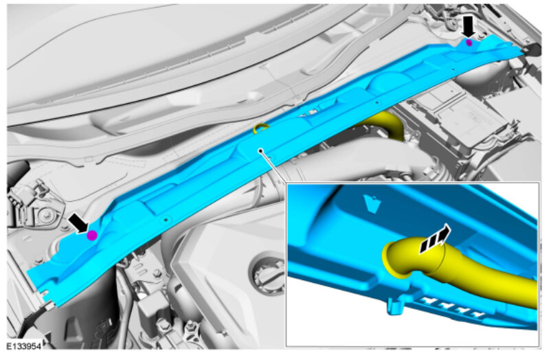

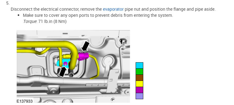

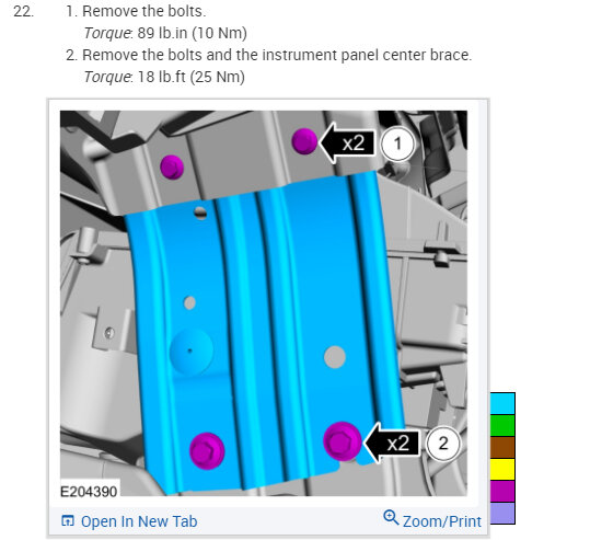

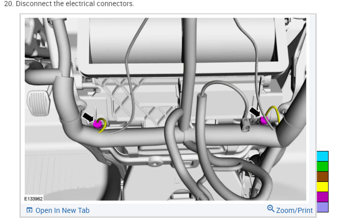

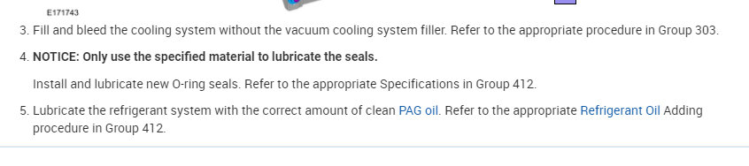

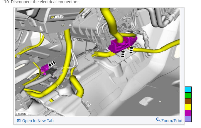

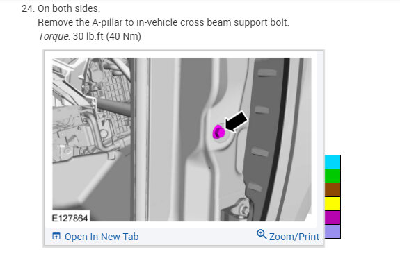

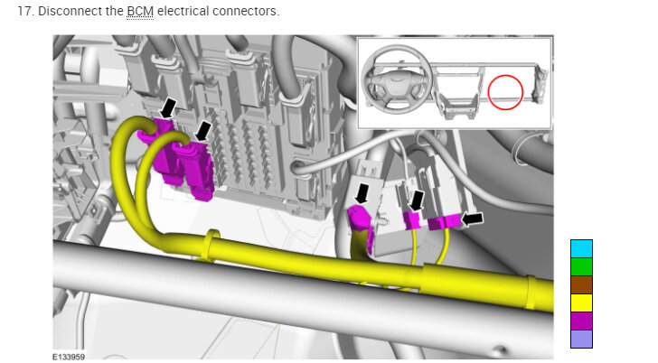

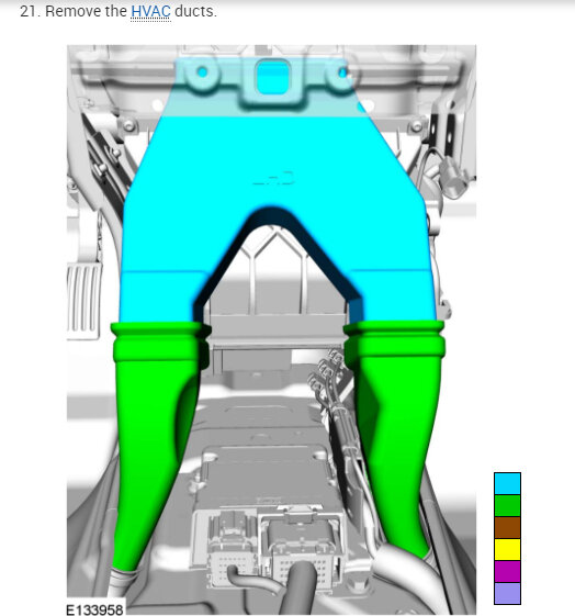

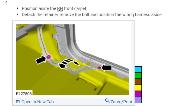

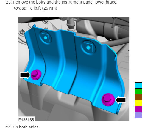

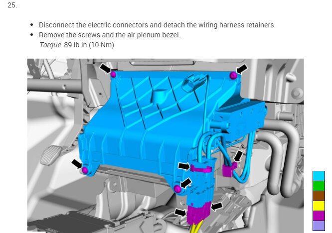

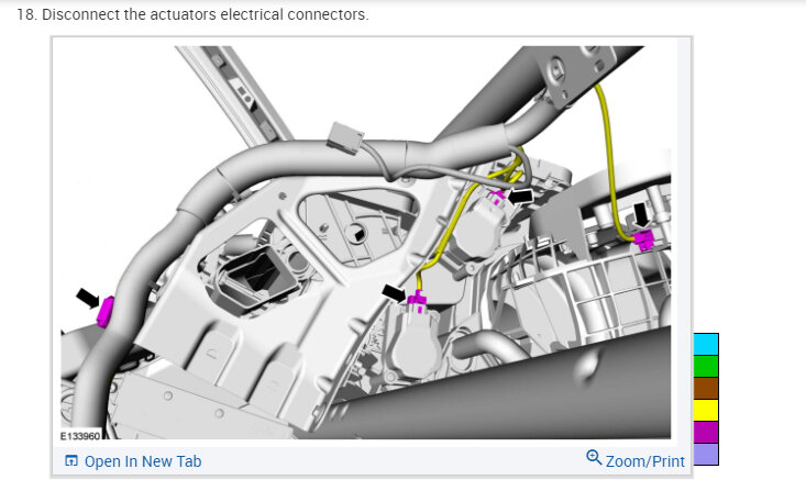

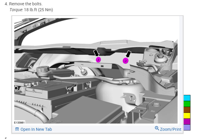

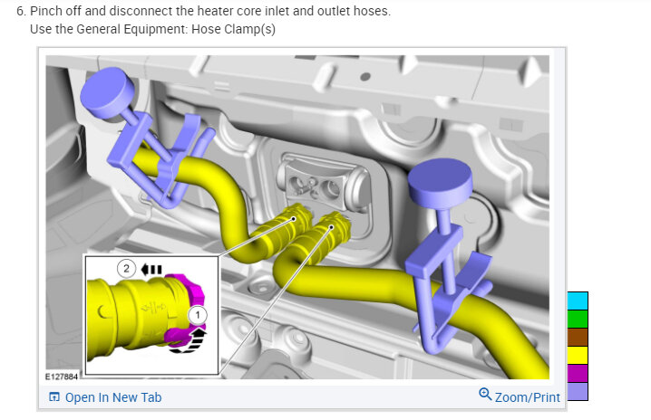

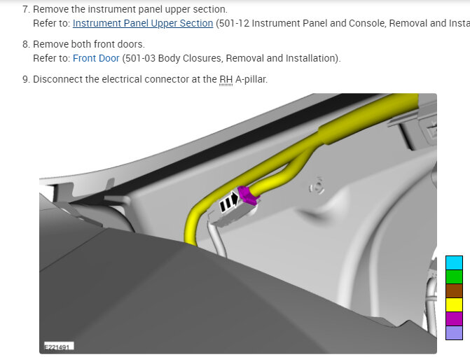

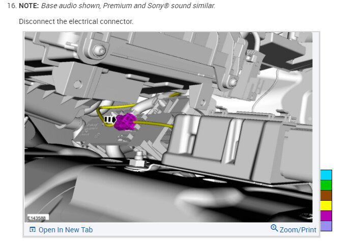

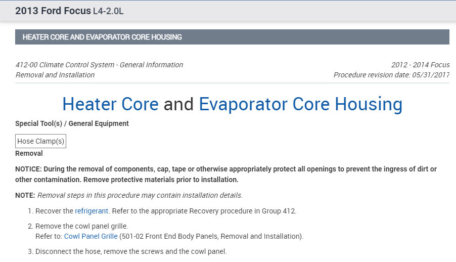

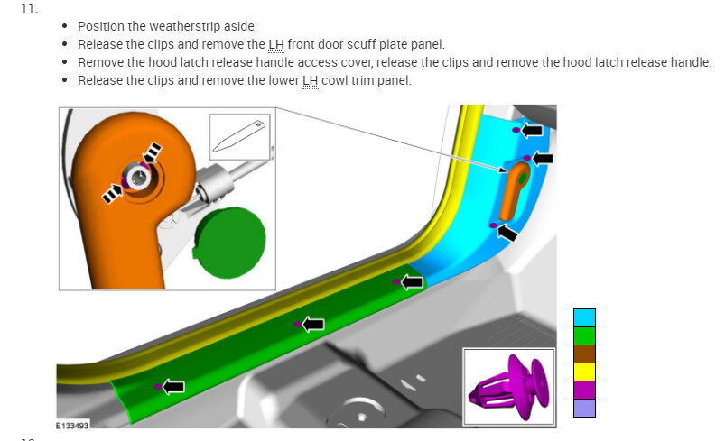

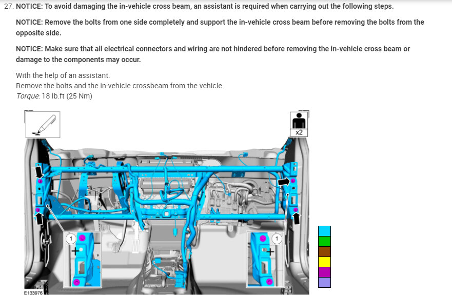

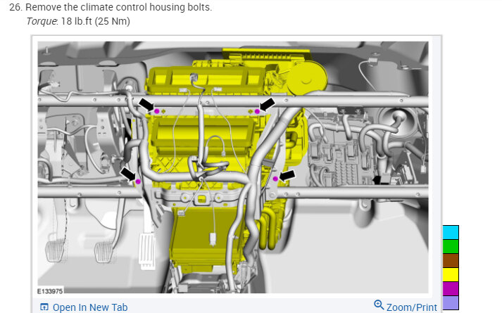

The pic is fine. I have a feeling that part is either cracked or the door is stuck. The only thing I can suggest is if you can't access it to see if the door moves, we likely need to remove the unit which requires removing a lot of parts. Also, the heater core and evaporator will need to come out at the same time. Heck, they even tell you to remove both front doors. Ugh! See step 8 in pic 6.
I attached the directions below for the removal of the housing for you to see. It is a bit overwhelming but doable.
Question: Are you able to fully remove the part with the tabs for inspection?
