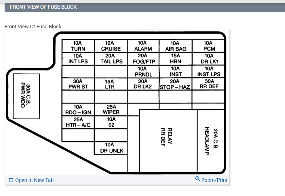

my climate control display not working?
154,000 MILES • 3.8L • V6 • 2WD • AUTOMATIC
BODYMAN2
Aug 16, 2022 at 6:58 PM
  • 55,732 POSTS

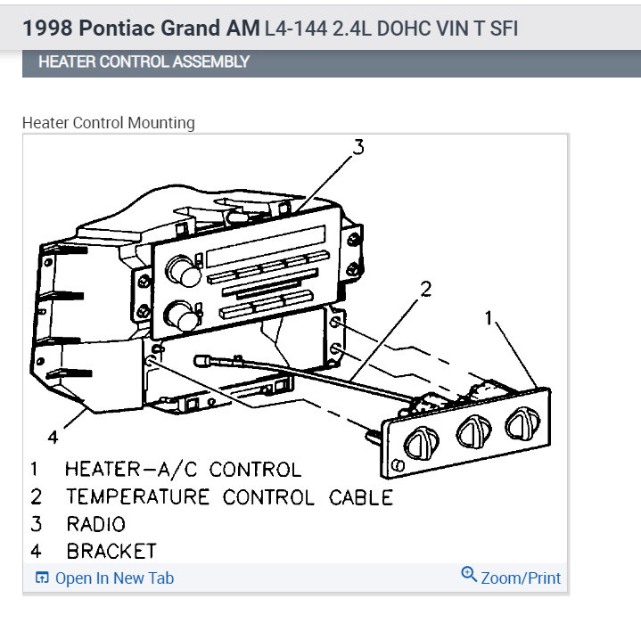

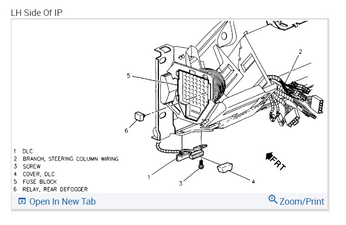

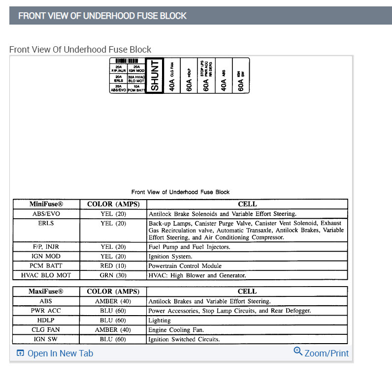

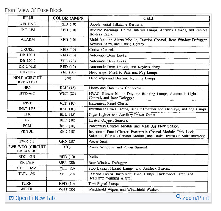

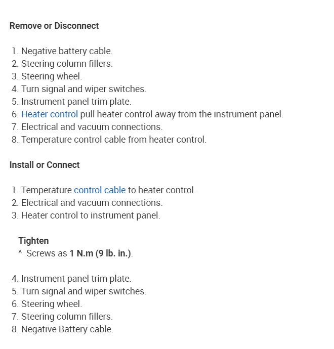

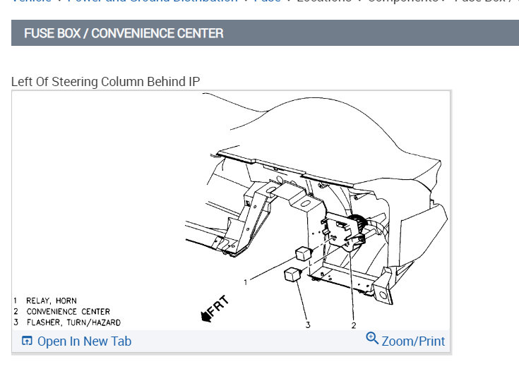

It could be the HVAC controller is out. To be sure let's check the fuses that work the system which are shown in the images below. Also, I included a guide to help check the fuses and the fuse locations as well:

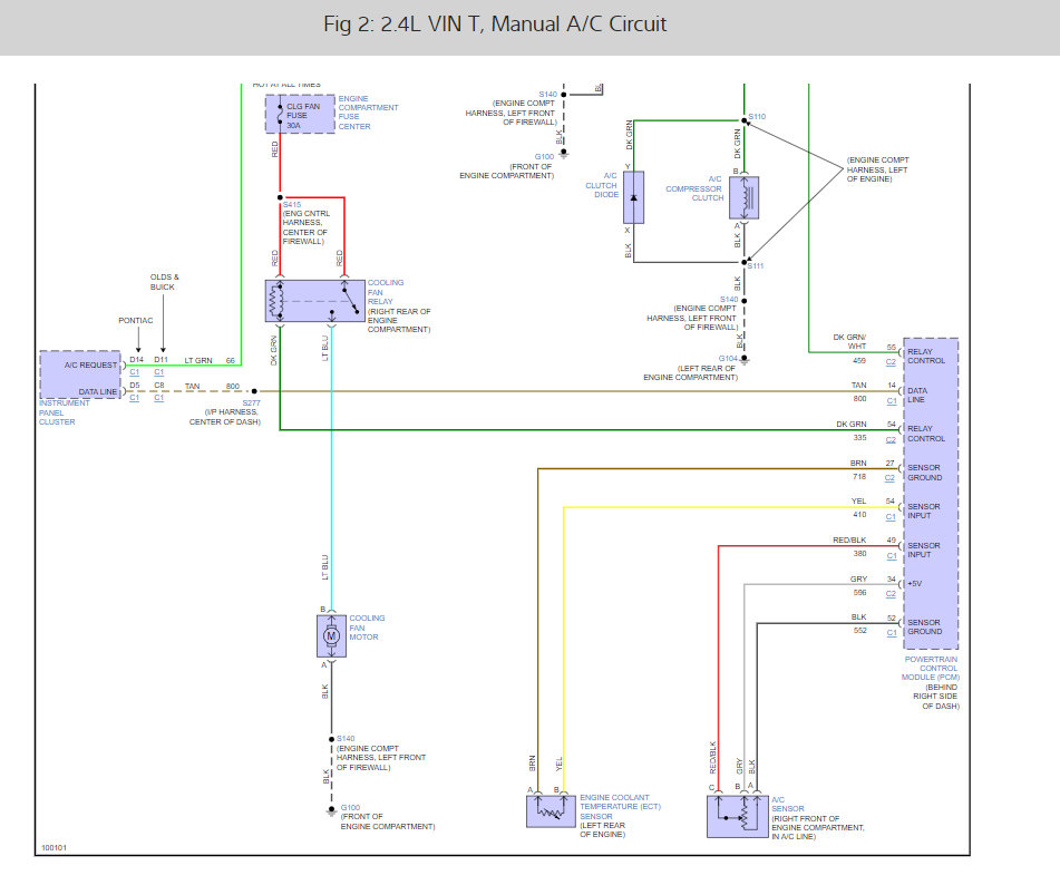

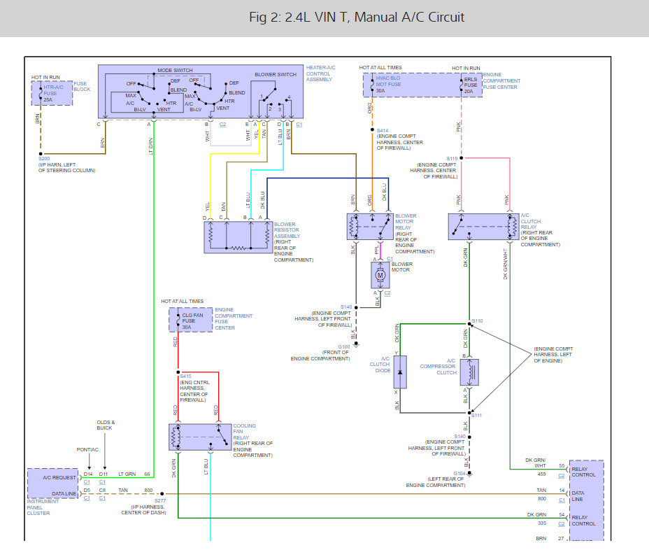

Here are the HVAC wiring diagrams so you can see how the system works and the fuses. If everything is okay replace the HVAC module. Check out the diagrams (below). Please let us know what you find.
