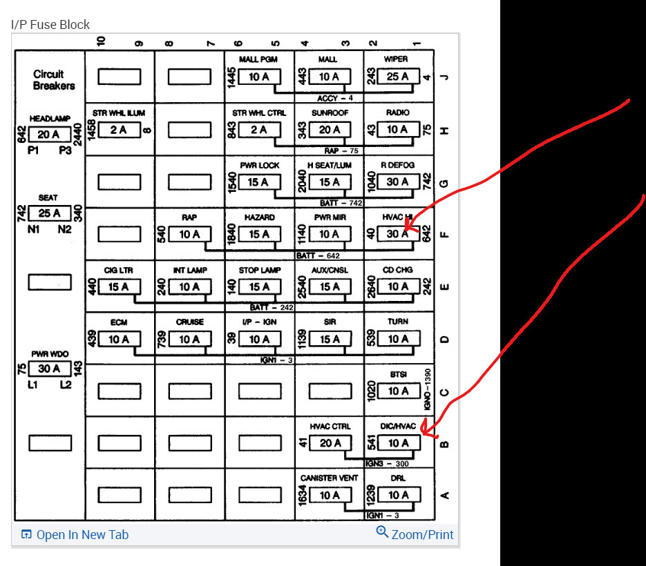

Dual climate control display not working.
Aug 28, 2022 at 10:13 PM
  • 55,433 POSTS

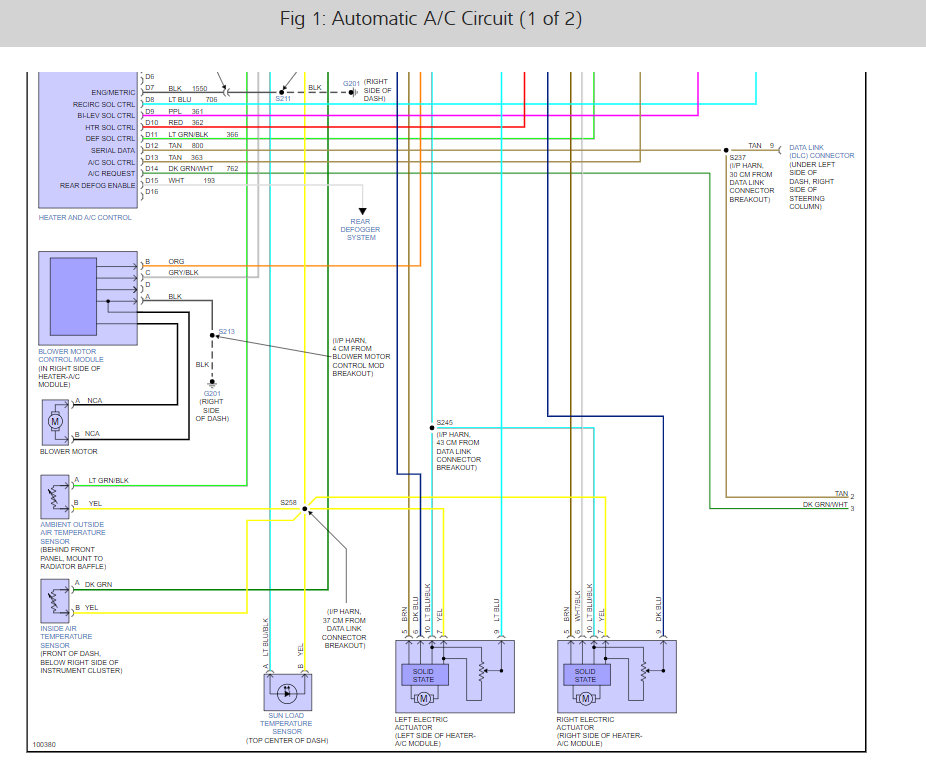

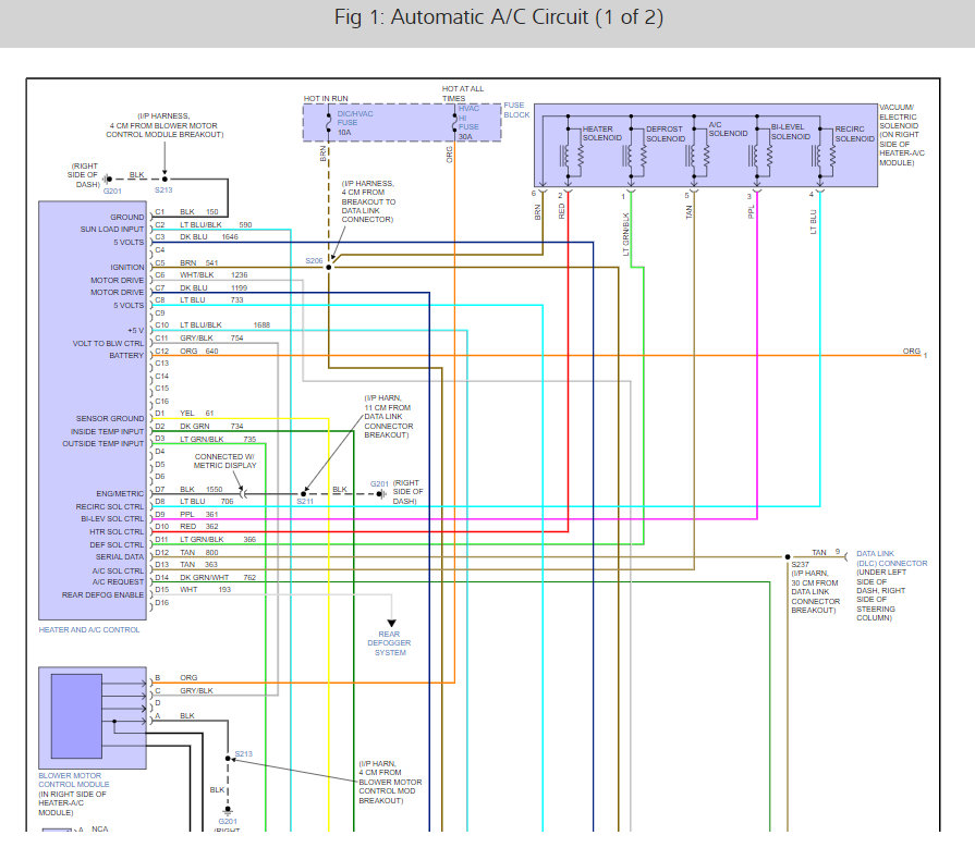

It could be the control panel that is out, but we should check the power fuse (DIC/HVAC and HVAC HIGH) first.
Here is a guide to help you with the HVAC wiring diagrams below so you can see how the system works:
