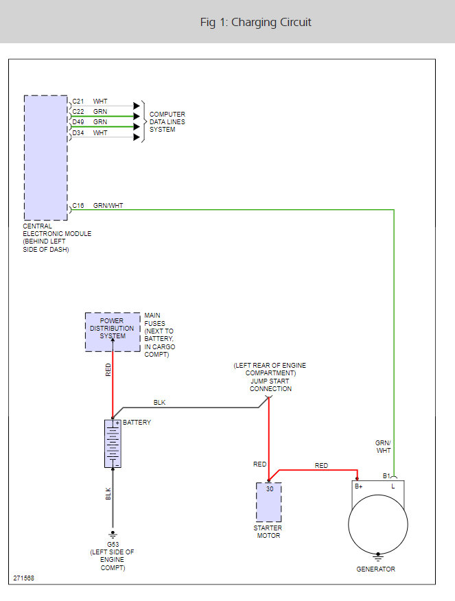

Alternator light come on after a few minute the car running. I've installed two Alternator from the Dealer and checked the continuity wire which goes from Alternator to PCM.

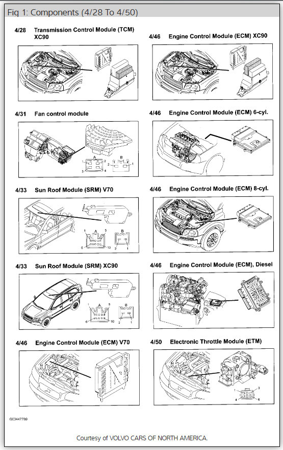

It sounds like it is the PCM that has gone bad but to be sure here is a guide and a alternator wiring diagram to help you do some testing.
If it checks out get a used PCM and swap it out which should fix it.
Please let us know what happens so it will help others.
