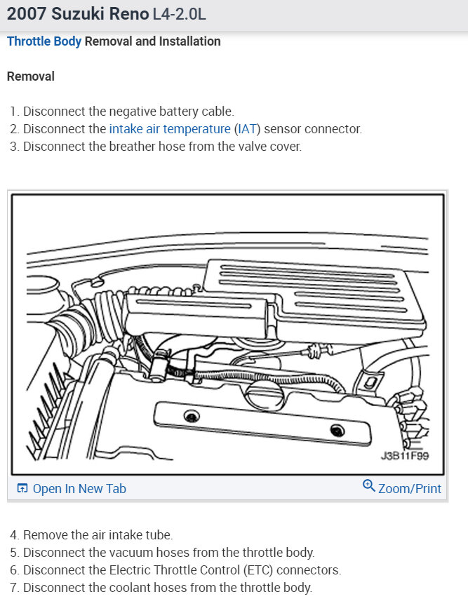

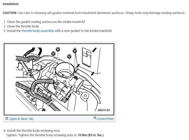

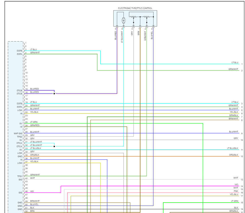

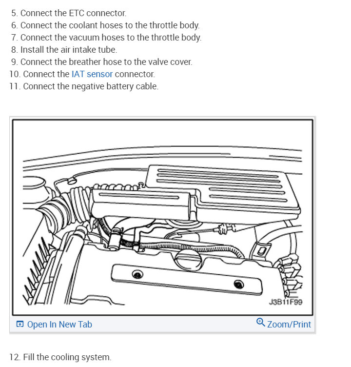

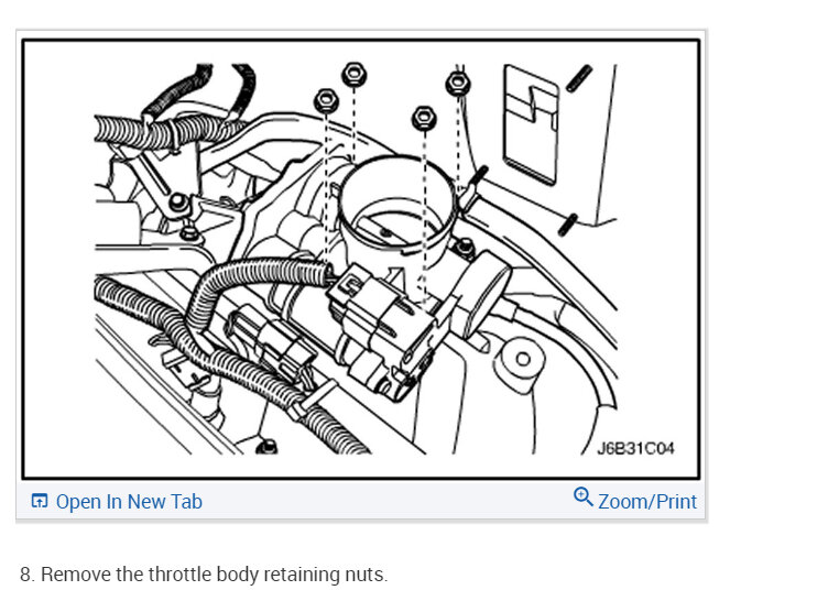

The P2101 trouble code in a 2007 Suzuki Reno relates to an issue with the electronic throttle control (ETC) system.
Here is how to fix the problem. Before you replace it, I would try a service because this can help the throttle body start working again.
Make sure you clear the codes once the repair is complete. Check out the images (below). Please let us know what happens.

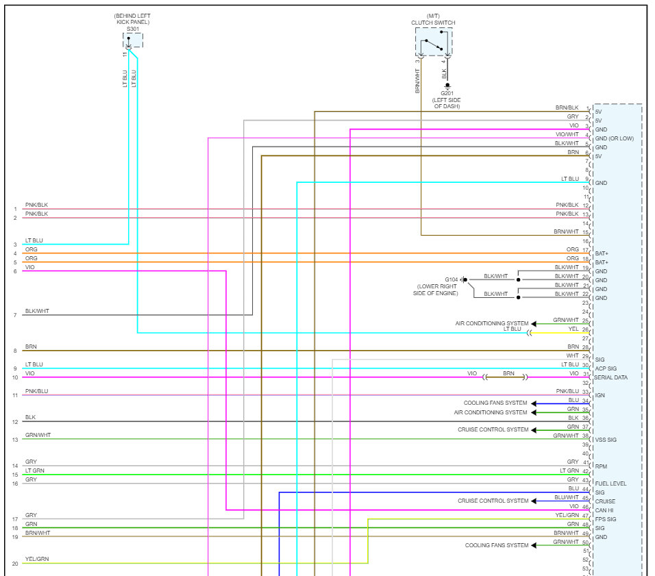

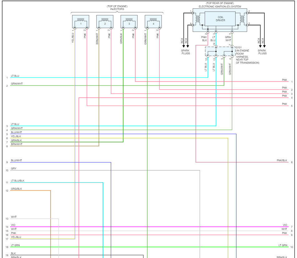

I did everything that you sent me, and I am still getting the same code. I also noticed that the throttle plate wasn't moving when the accelerator pedal was being pushed. I started rechecking the wire harness looking for any damage, but I haven't seen any. I was thinking about just taking the engine wiring harness completely out of the car and take it apart and really look at it. I had found a couple wires earlier that had a bare spot on them, so I had fixed those. Could you tell me which wiring harness diagrams are better, one from a service manual or OEM wiring diagrams? I have the wiring diagrams, but they aren't all colored, I would like to get the wiring diagrams that are colored. Thank You for all the help, I appreciate it very much.
Nov 12, 2023 at 12:13 PM
  • 55,784 POSTS

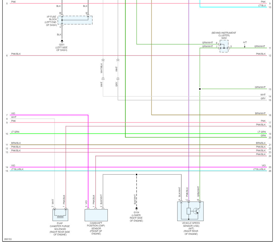

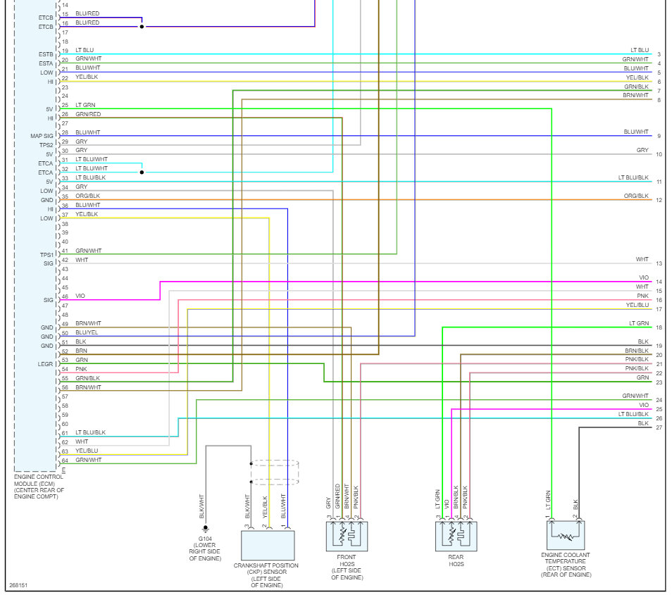

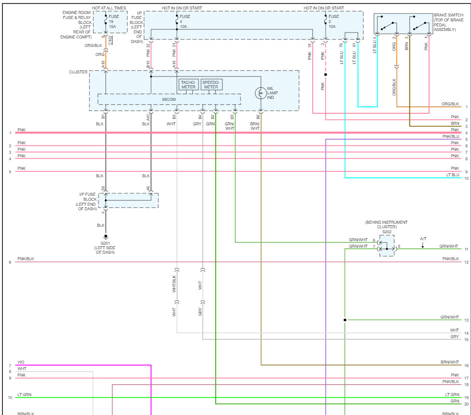

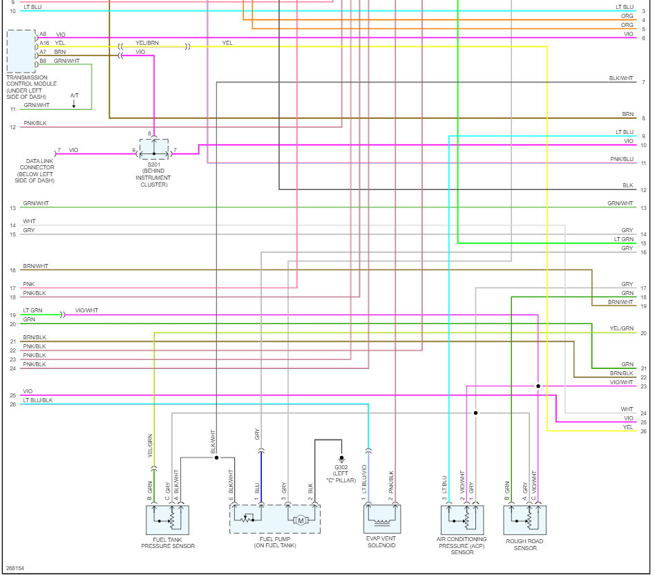

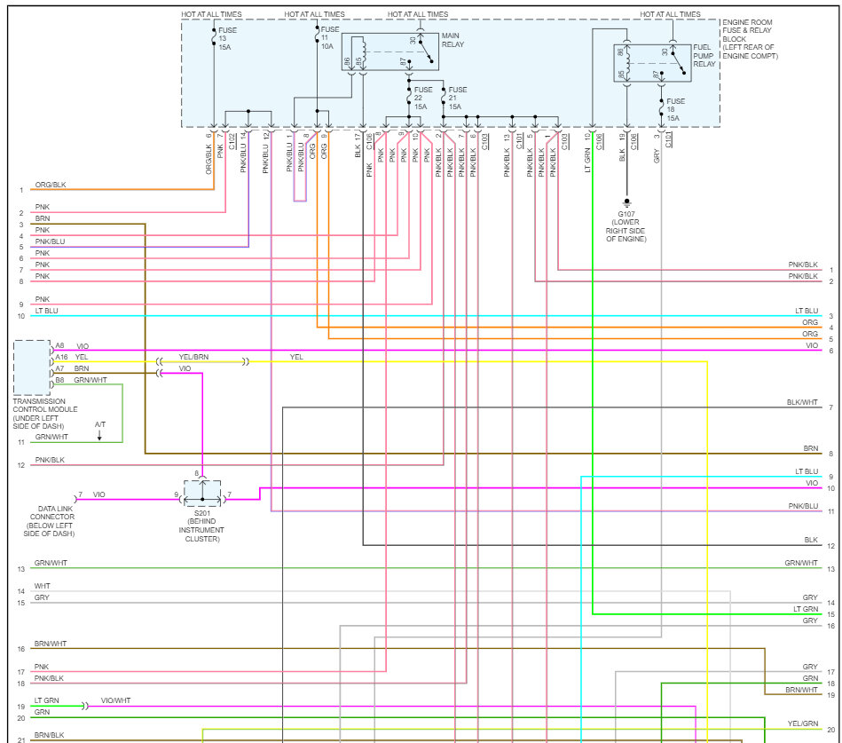

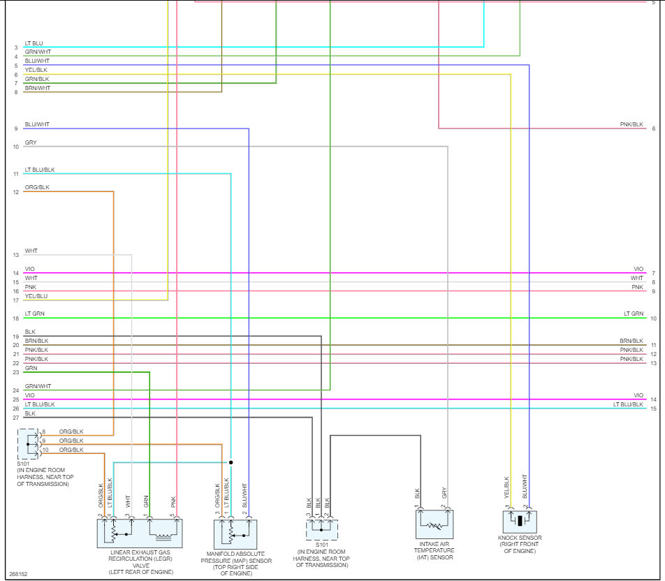

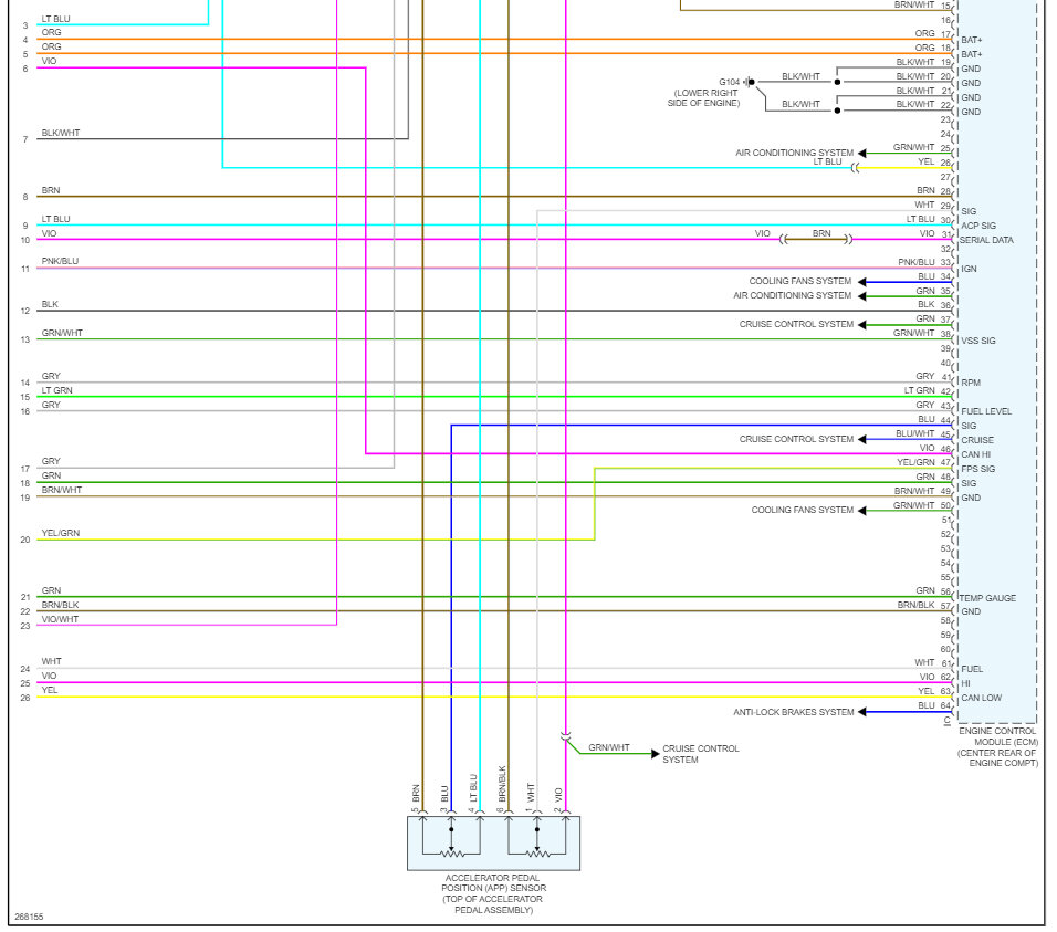

I would try replacing the throttle body if the wiring tests okay, cleaning the unit sometimes will not work. You don't need to remove the wiring harness to test the connections and to test for resistance to ground.
This guide will show you how, also here are the wiring diagrams so you can see which wires to test:
Here is the throttle body and engine wiring diagrams as requested. Check out the images (below). Let us know how it goes.

Ken,
I checked the wires and the TPS1, TPS2, 5-v ref, ground were all okay.
But the ETA and ETCB Did not have any readings at all.
Once again thank you for your help.

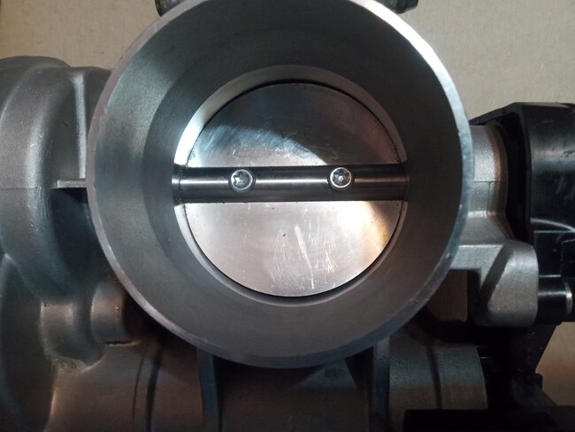

Here's a picture of my throttle body.
Nov 16, 2023 at 8:46 AM
  • 55,784 POSTS
Yep, it is super clean, good job but you may still have issues internally even though it tested okay. I would check the wiring between the throttle body and PCM and if okay replace the throttle body. There is an outside chance the PCM is bad.
