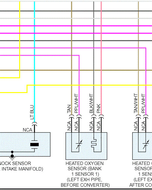

How do I know which wires are the signal wires on the sensor? it has 2 browns a pink and a purple with white strip. the ones I was using was the purple and one of the brown colored wires.And the reading was like .4 to .5 no higher I think I had the right huh.This stuff is all new to me I am just trying to help a good friend out so they can smog it and there behind doing this so.I appreciate all the help.

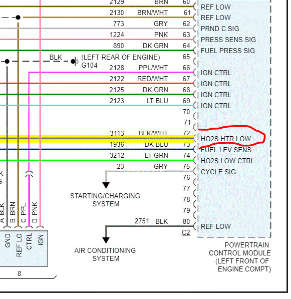

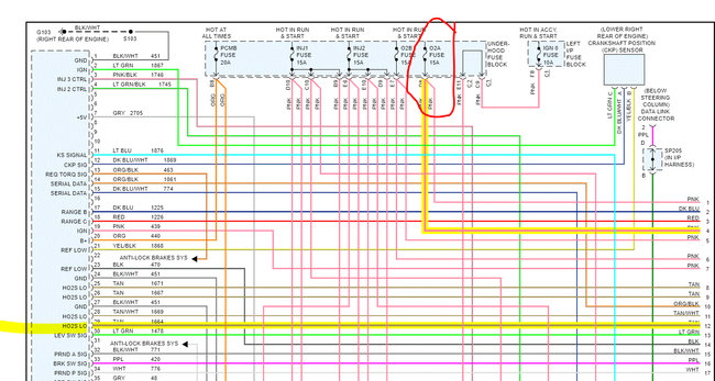

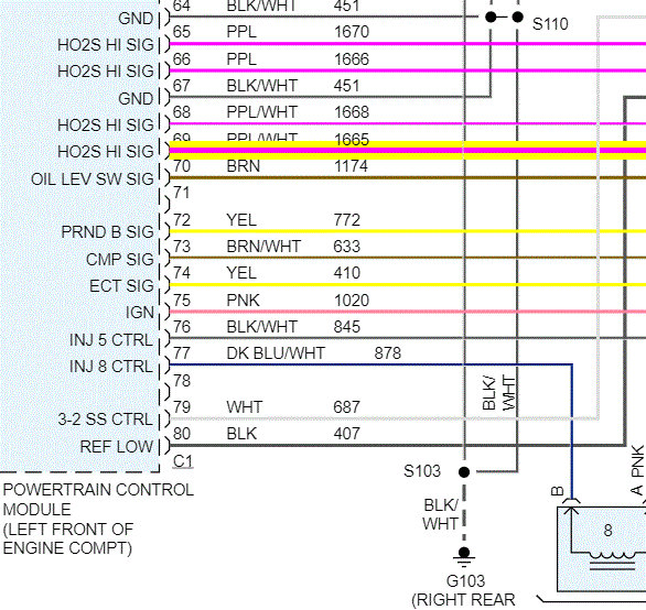

I attached pics below of the wiring. Pic 1 shows the sensor and wires from it. The remaining pics show where the wires go.
The purple with the white stripe is the signal. The pink is power by a specific fuse, the tan is low reference and the black/white is low also.
It sounds like you had the right wire for signal. Take a look through these and let me know if you have questions. Note that in the schematics, the wires right at the sensor indicate NCA. That means no color available. So right at the sensor the wire color may be different which will require you to go back to where it connects to see colors.
Hope this helps.
May 17, 2020 at 6:58 PM
