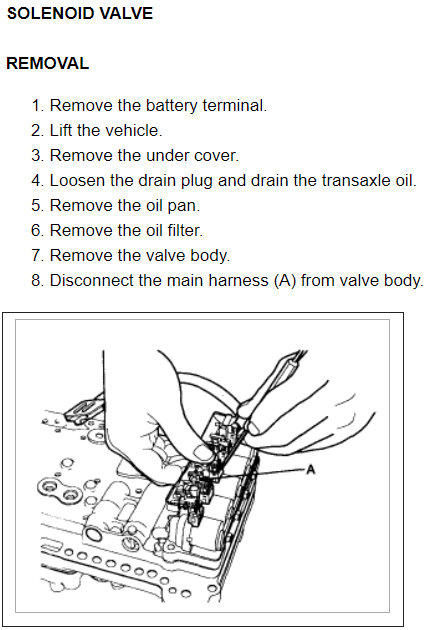

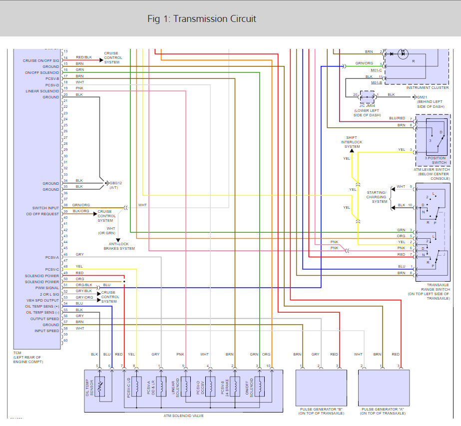

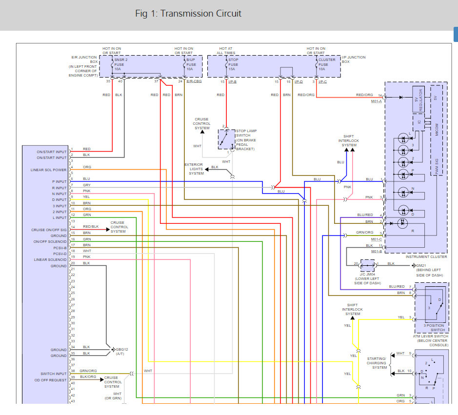

My husband thinks he can check the harness and replace the solenoid since the dealership wanted over $1,200.00 to do this, but we are having a hard time finding online instruction to assist him. Any help?
Mar 1, 2018 at 10:38 AM
  • 54,840 POSTS
Yes, we are on it. any information you need I can most likely find for you. Here is a guide to help him learn how to test the wiring:

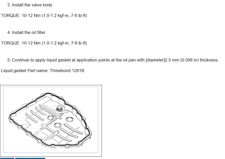

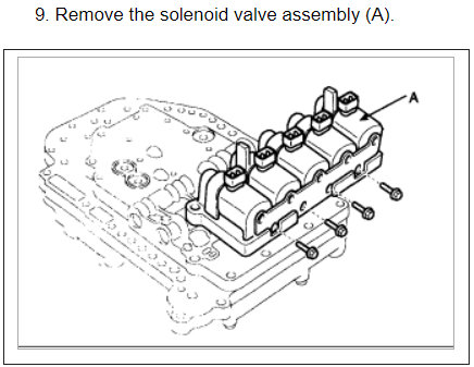

This guide will give him an idea for what it will take to remove the transmission pan:
Below are the transmission wiring diagrams to help him get started.
