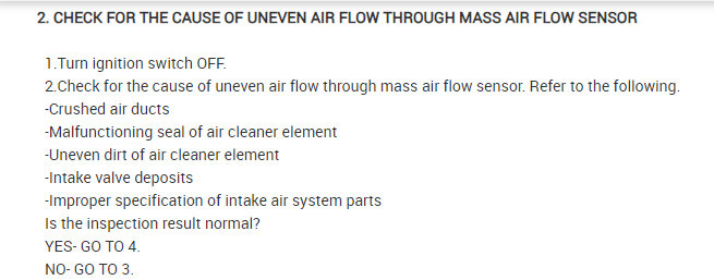

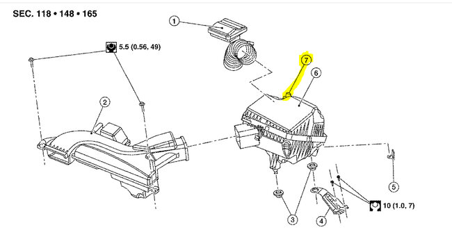

I had this code scanned
P0101
My car is driving normal, but my Check engine light is on.
I am requesting troubleshooting steps and if possible, a diagram to locate the affected parts to replace/repair.
Thank you
Apr 14, 2024 at 5:40 PM
  • 110,194 POSTS

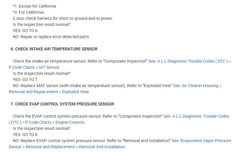

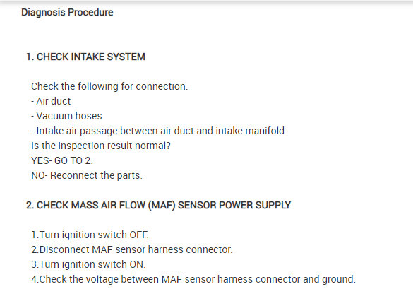

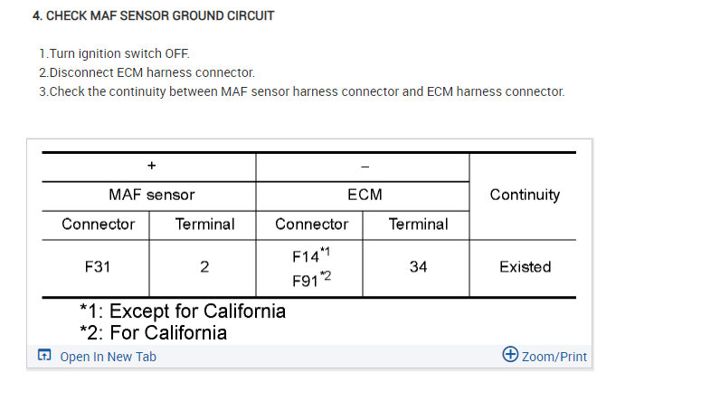

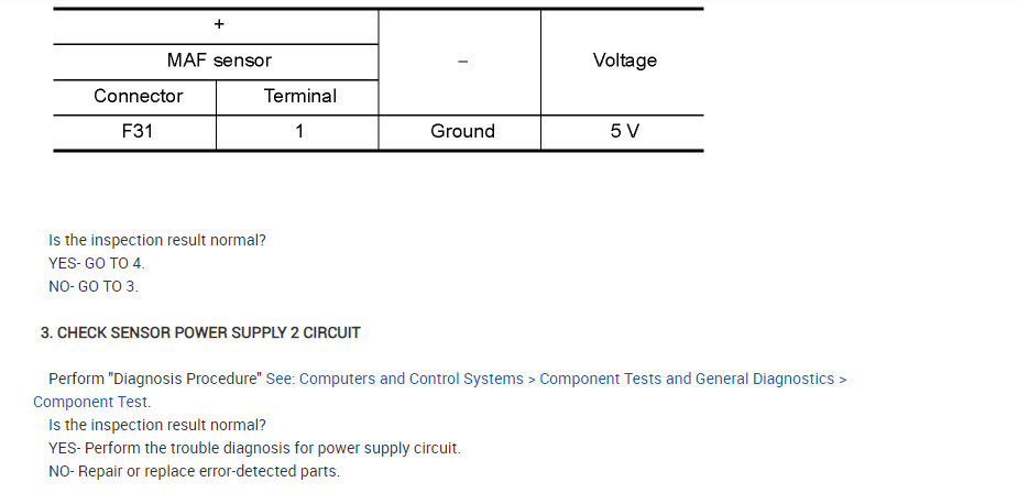

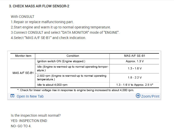

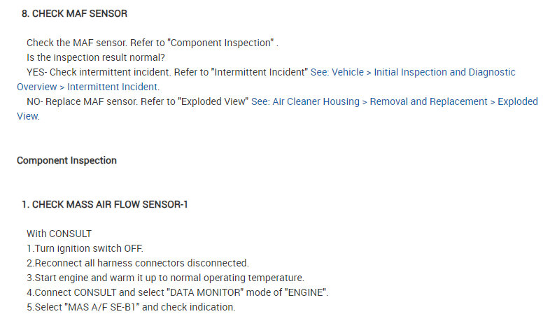

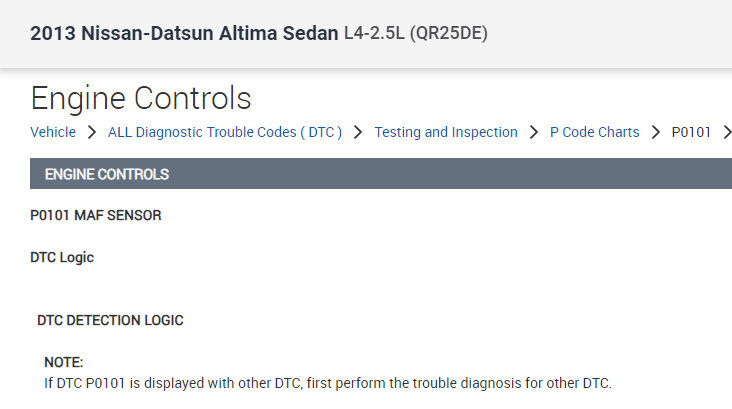

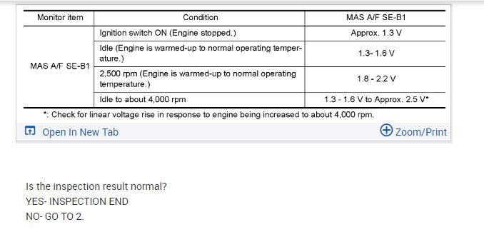

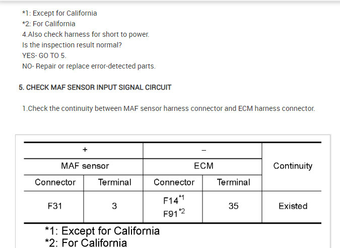

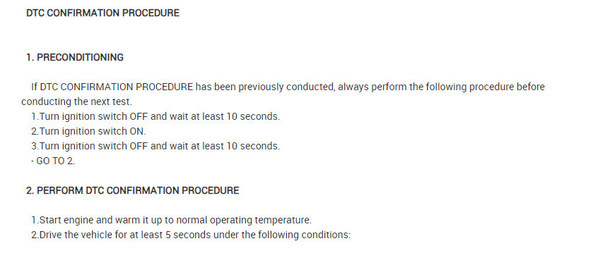

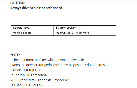

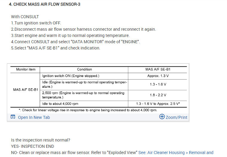

As far as the code is concerned, it is related to the mass air flow sensor (MAF). The code can be set by a few things. For example, an engine vacuum leak, a wiring or connector issue, a failed MAF sensor, intake air temperature sensor, and so on.
I attached diagnostics below. However, before you jump into the diagnostics, I would remove and clean the MAF sensor. They make a special cleaner specifically for them.
Here is a link that shows how to service it:
https://www.2carpros.com/articles/mass-air-flow-service
The mass air flow sensor is located in the air filter box. See pic 1 below. The remaining pics are the diagnostics related to the code.
