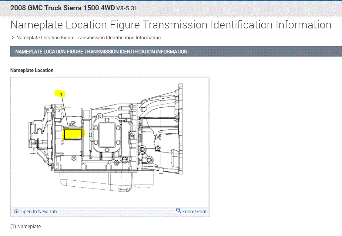

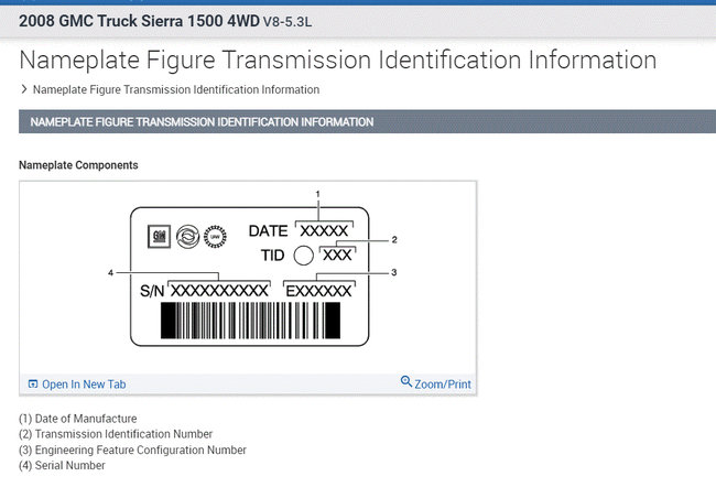

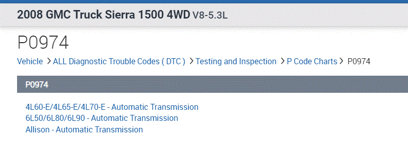

I would be happy to help. I need some clarification. First, as you are likely aware, the P0700 is a generic code that simply means there is a code stored in the transmission control module (TCM). The code that is of interest is the P0974. However, I need to know which model transmission you have to proceed.

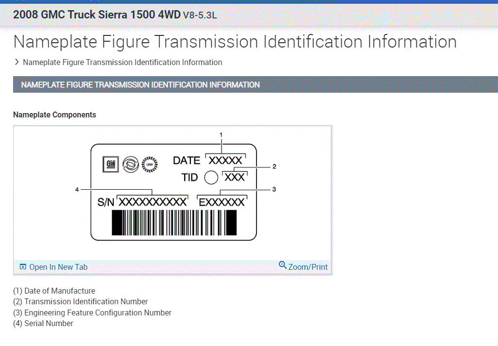

If you look at pic 1 below, it shows the options that were available on your truck. Pics 2 and 3 show where and how to identify the transmission type. This is what I need.
Let me know so I know which direction to go.

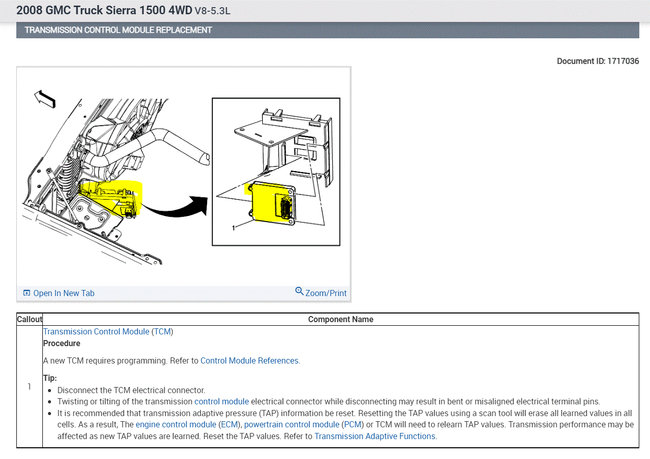

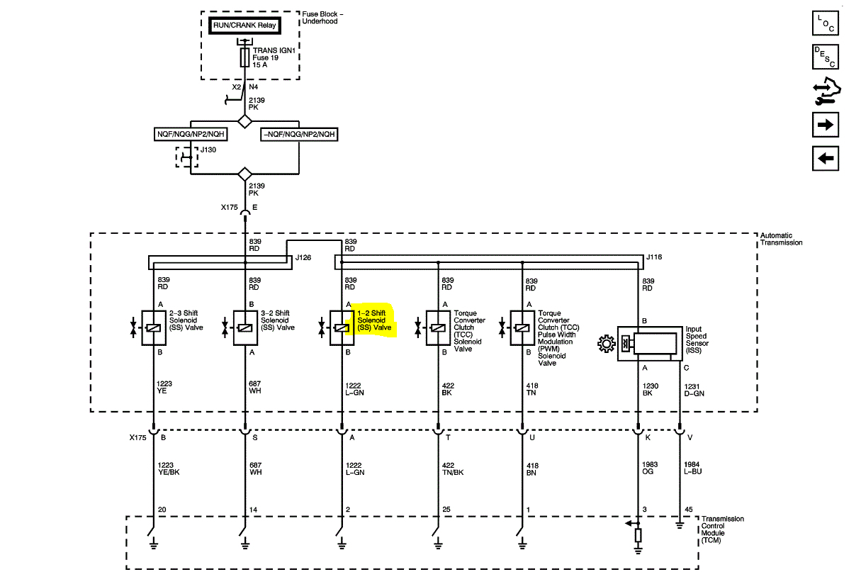

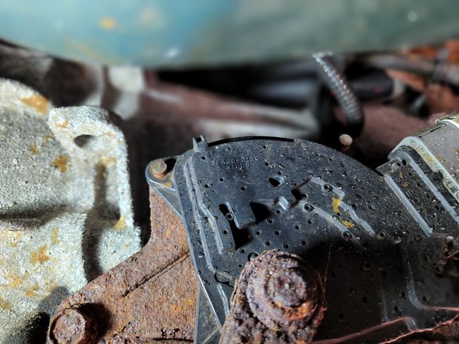

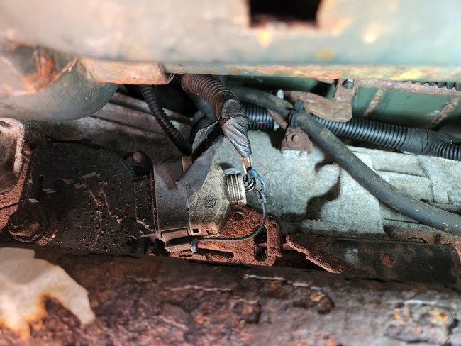

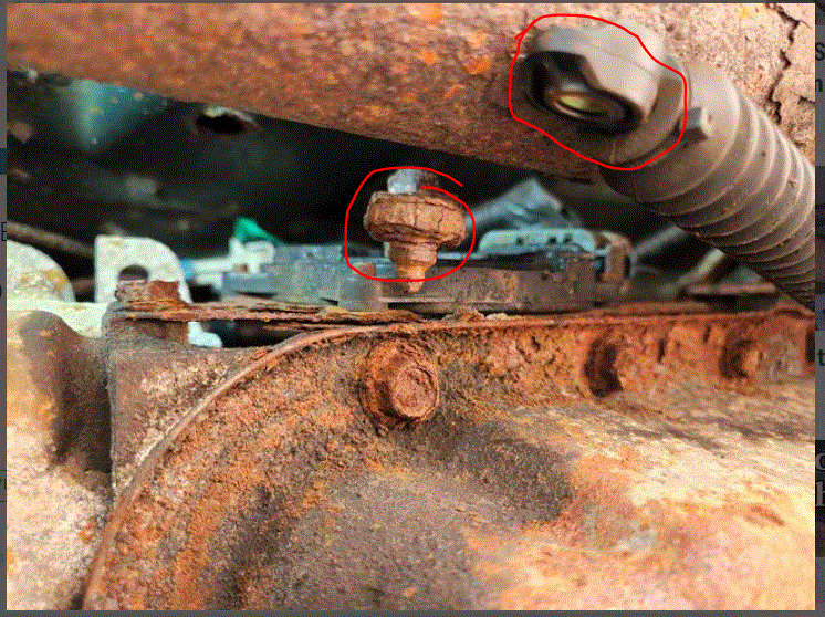

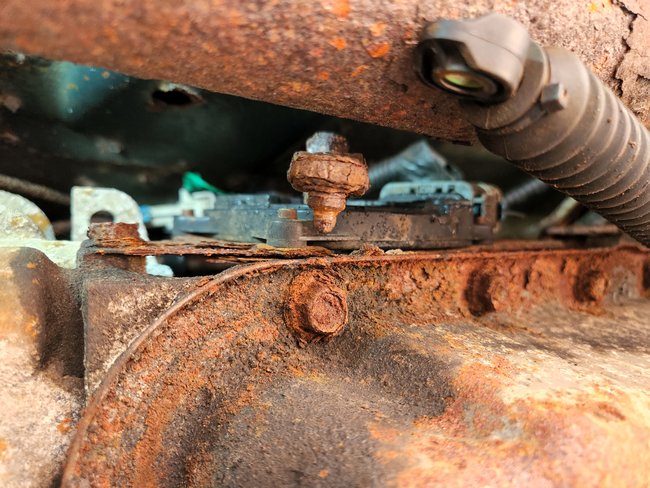

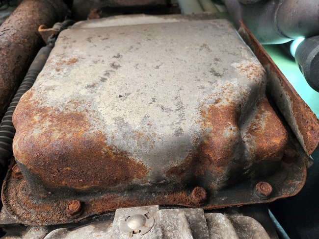

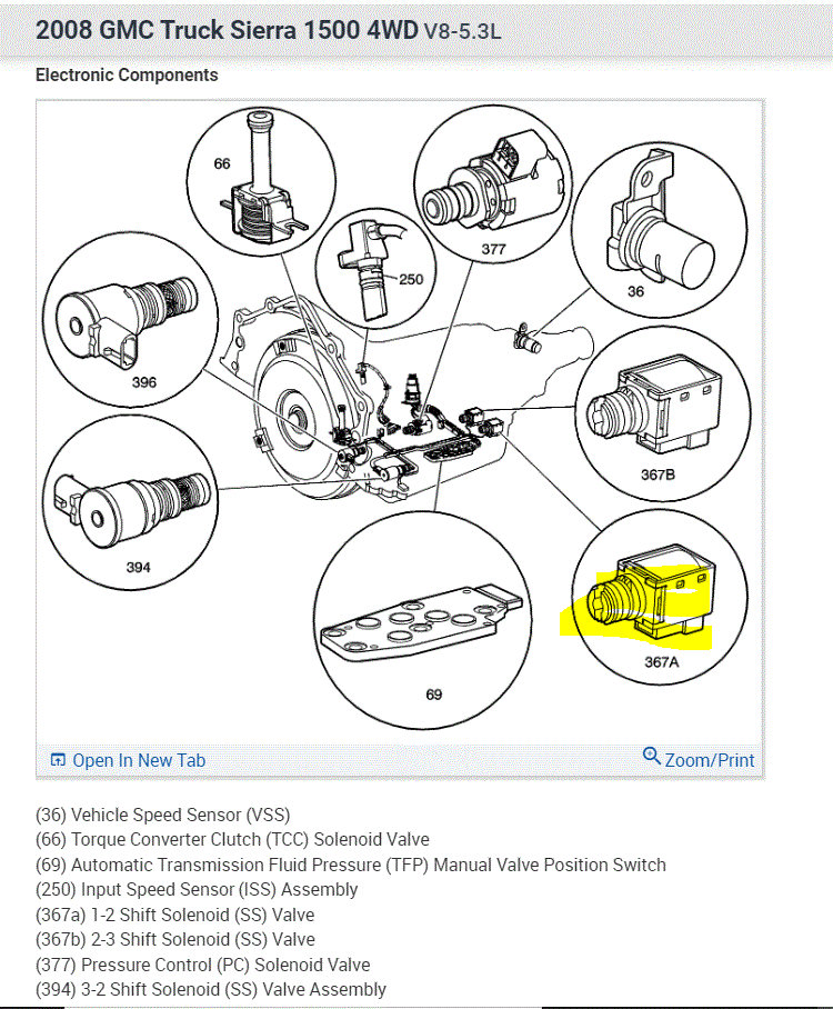

I copied one of your pics and circled the shift linkage. Does the vehicle go into gear at all? The linkage is disconnected. See pic 1 below.

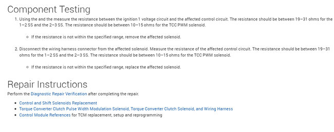

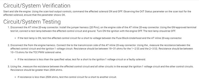

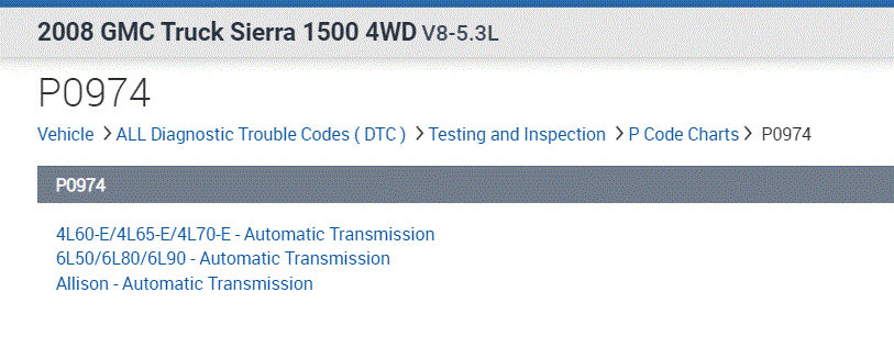

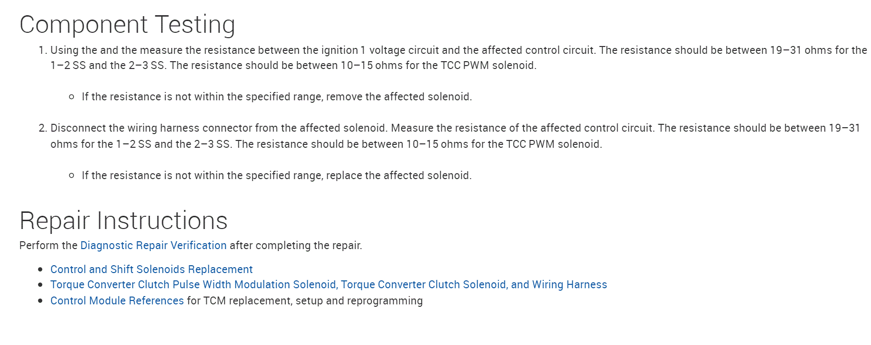

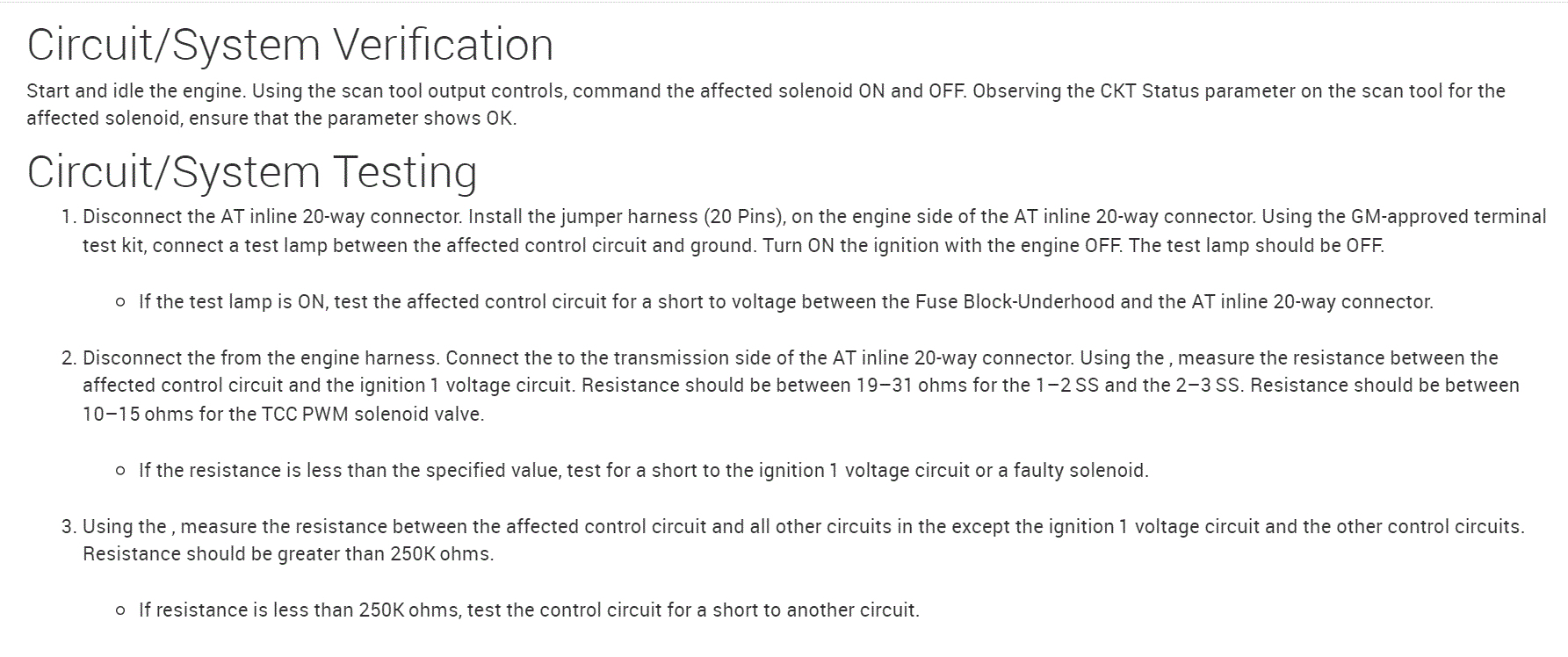

As far as the code, it indicates there is excessive voltage with the 1-2 shift solenoid. It could be shorted.

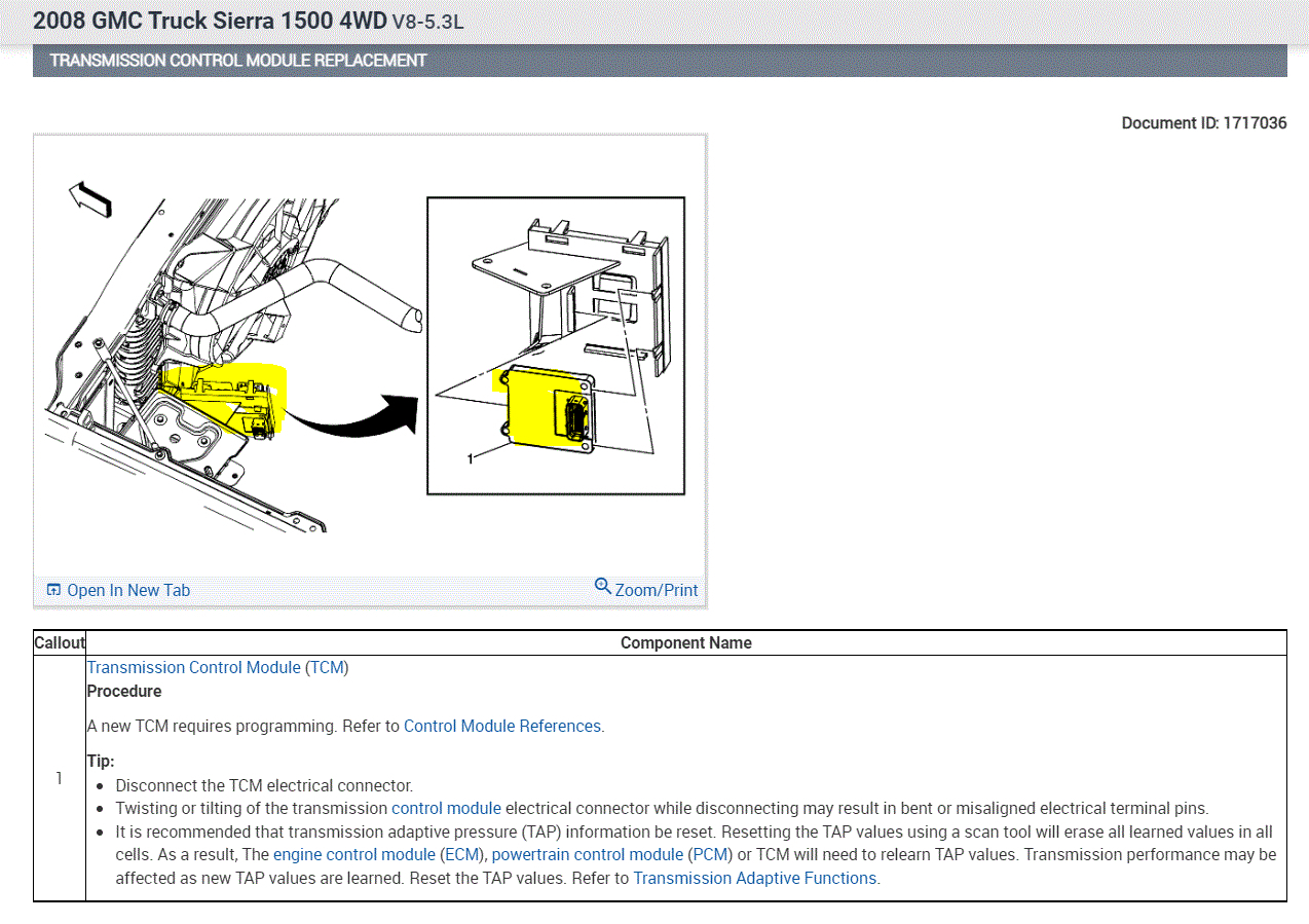

Pics 2 and 3 are the diagnostics for the code. Pic 4 is the wiring schematic for the shift circuits. Pic 5 shows the 1-2 shift solenoid location in the transmission, and the last pic shows the location of the TCM. It is right below the battery on the driver's side.
Check the wiring to the TCM. I've seen battery acid cause damage, so that could be an issue.
Let me know what you find.
Jun 24, 2022 at 1:07 PM

The information you sent was very good just that I am a DYI and don't have a fancy scanner to help me diagnose the problem. I was able to remove the transmission oil pan to get to the shift solenoids. Using a 9-volt battery I was able to test the solenoid and one of them was not clicking at all. the other two were. The bad one tested bad for resistance. I replaced the tree shift solenoids, new filter and oil. Erased the DTC codes and now i have no codes. previously i could not erase the P0974 code. I have not driven the truck yet because while i have the truck lifted on the stands, I am hoping you can help me with the four-wheel drive not engaging. I previously removed the actuator that engages the front wheel drive and tested it with 12 volts from the battery and the plunger does activate. I also replaced the transfer case motor and no difference. I also changed the transfer case module with another used one and nothing changed. Now the 4-wheel drive control selector is on Auto. I can move the selector all the way to Neutral and all the lights on selector light up including the neutral light. Can you please help?
