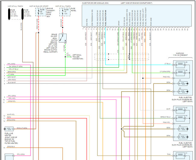

I just replaced the wiring harness with a different wiring harness and IDM and now I’m getting these codes when I do an injector test. The truck will not start anymore, and I also replaced the driver's side valve cover gasket before all of this. Originally, I was having an issue with the oil pressure I replaced the ipr valve and that didn’t fix it. I’m not sure what happened that now I’m getting all of these codes at once and it’s not just one side of the engine, I guess.
Sep 15, 2024 at 11:35 AM
  • 55,627 POSTS

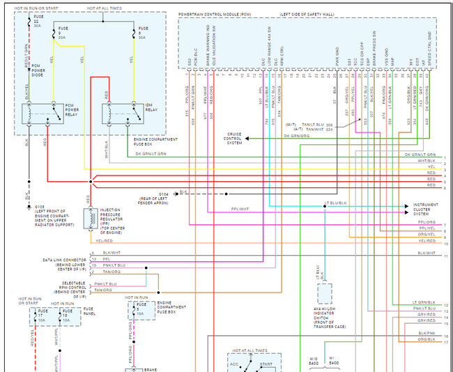

Yep, these are wiring harness codes, is everything connected? If so, I would get another harness.
P1271 - Cylinder #1 High to Low Side Open
P1272 - Cylinder #2 High to Low Side Open
P1277 - Cylinder #7 High to Low Side Open
P1273 - Cylinder #3 High to Low Side Open
P1274 - Cylinder #4 High to Low Side Open
Let me know if you need anything else, or upload images so I can see what's going on.

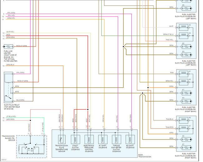

So I’m not sure if this has to do with anything but my glow plug relay only has power on one big terminal and the other doesn’t. I was doing research, and it says both should have power when the key is on. I’m not sure if the wires are on correctly do you have a wire diagram for this? Thank you
Sep 16, 2024 at 10:24 AM
PROMIKE94
  • 10 POSTS
And I put my old harness back in and I’m having the same out come with the injectors. I’m pretty sure the wires on the for from the other harness were on different so could I have burnt out this relay?

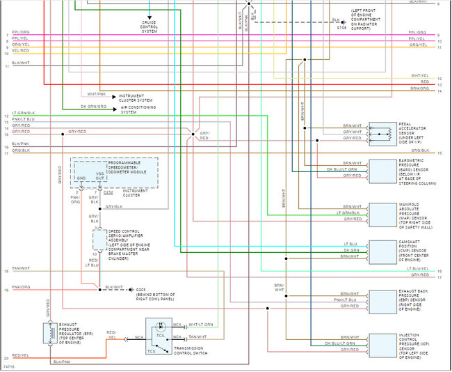

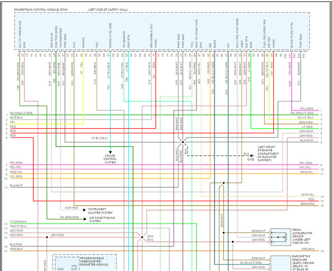

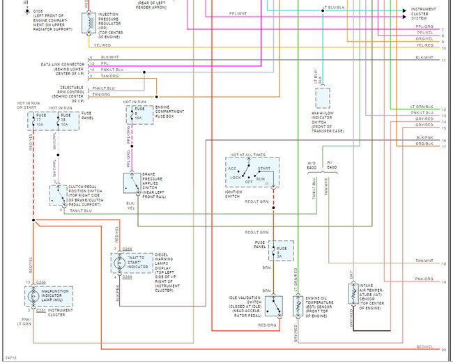

Yep, there should be power at two of the terminals for the glow plug relay, here are the wiring diagrams for the engine and glow plug relay so you can see how the system works and which wires to test.
This guide should help you as well:
Check out the images (below). Let us know what you find.
Sep 17, 2024 at 1:59 AM
