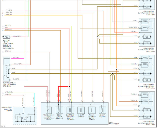

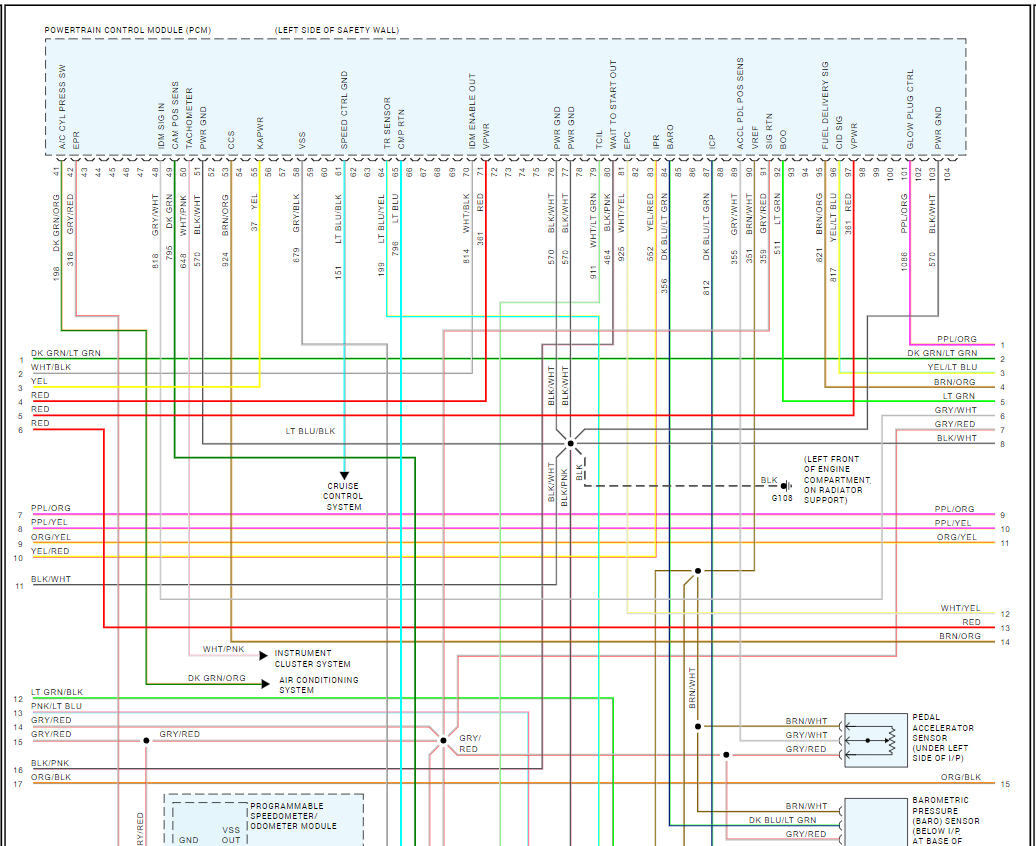

So I’m not sure if this has to do with anything but my glow plug relay only has power on one big terminal and the other doesn’t. I was doing research, and it says both should have power when the key is on. I’m not sure if the wires are on correctly do you have a wire diagram for this? Thank you

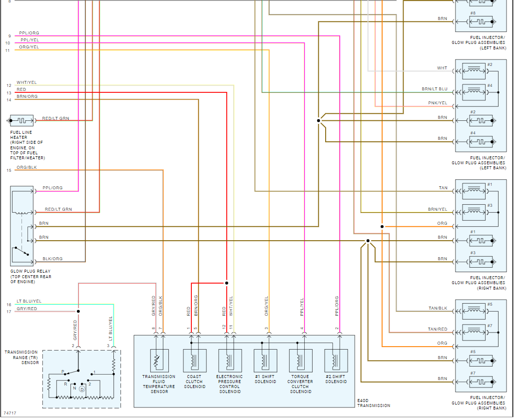

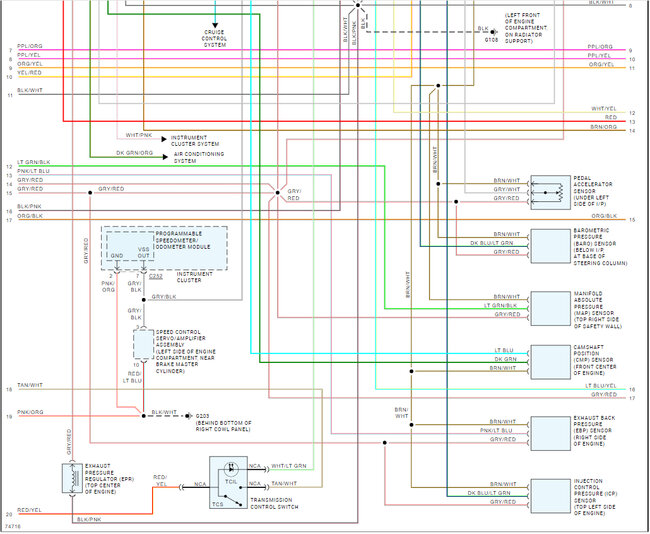

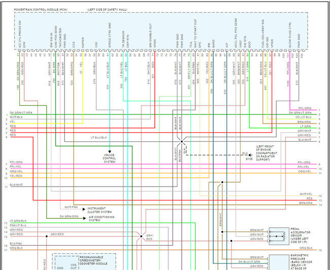

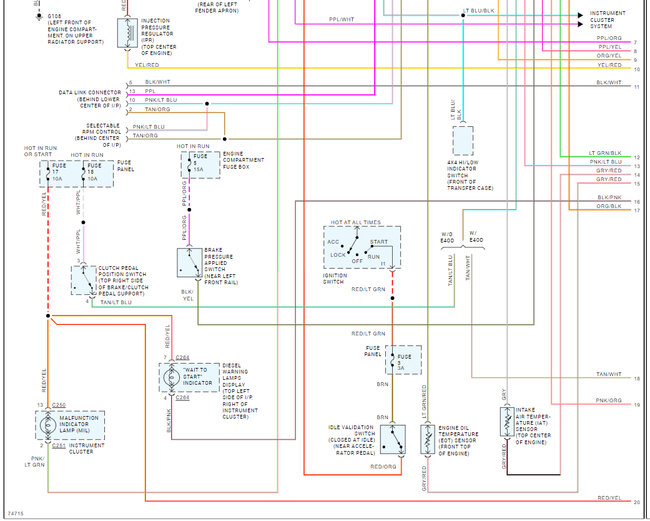

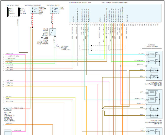

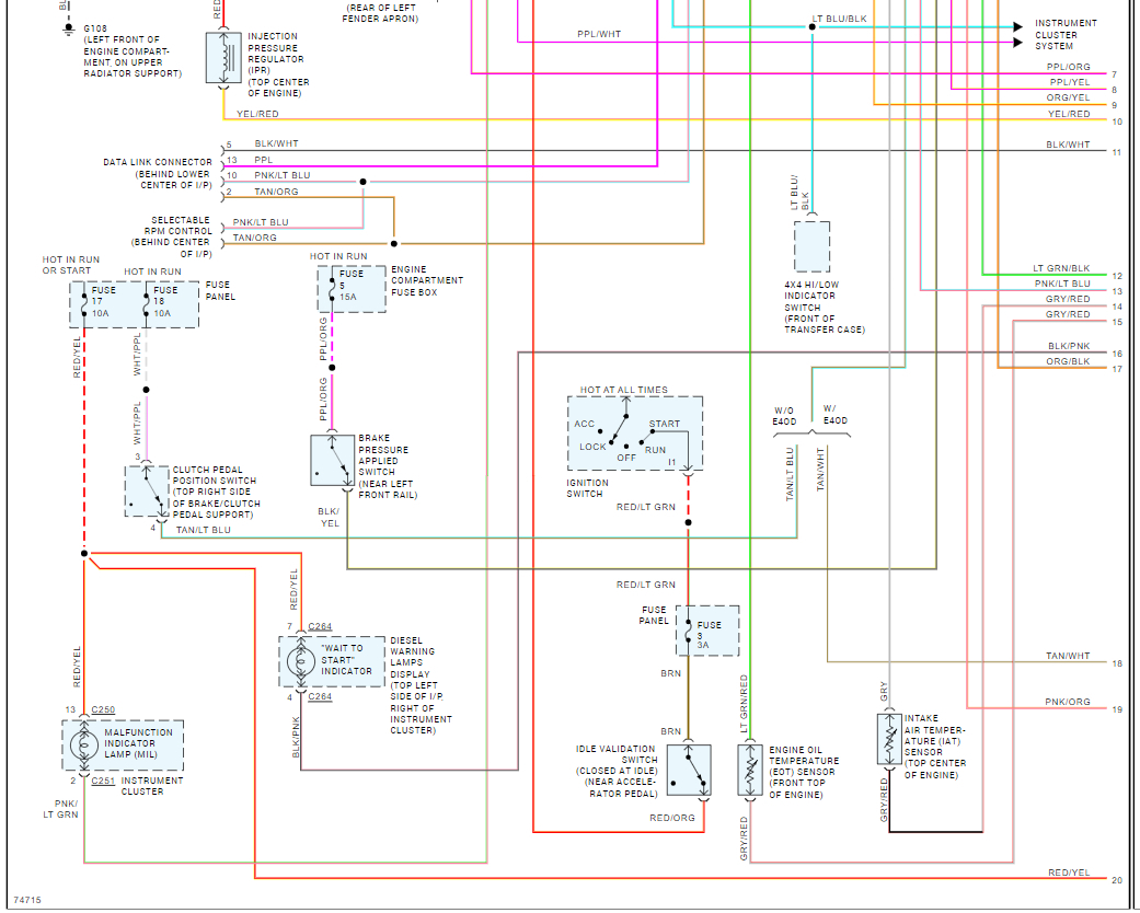

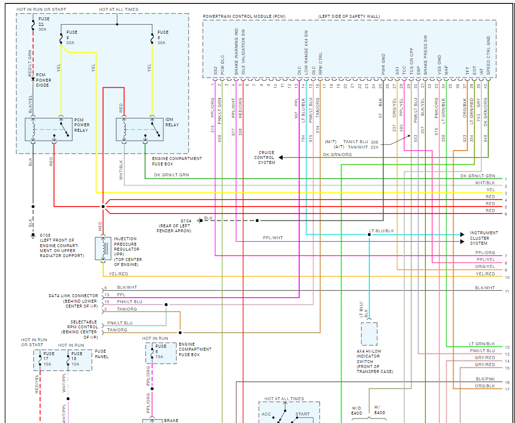

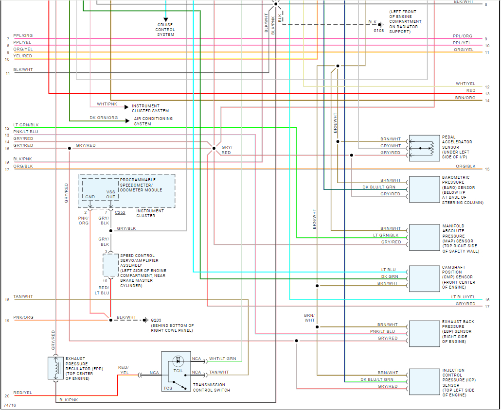

Yep, there should be power at two of the terminals for the glow plug relay, here are the wiring diagrams for the engine and glow plug relay so you can see how the system works and which wires to test.
This guide should help you as well:
Check out the images (below). Let us know what you find.
Sep 17, 2024 at 1:59 AM
