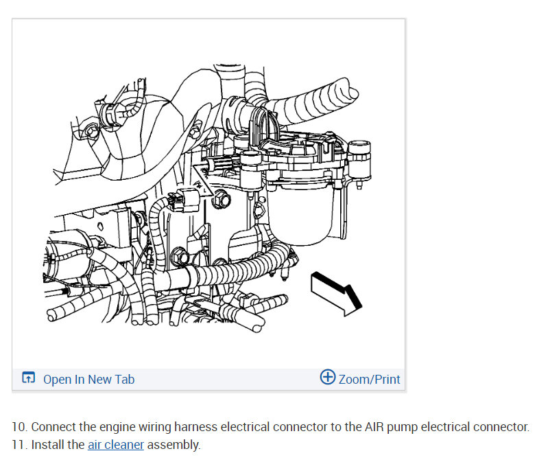

Here's what this code typically indicates:
P2433 - Secondary Air Injection System Air Flow/Pressure Sensor Circuit Bank 1 Sensor 1

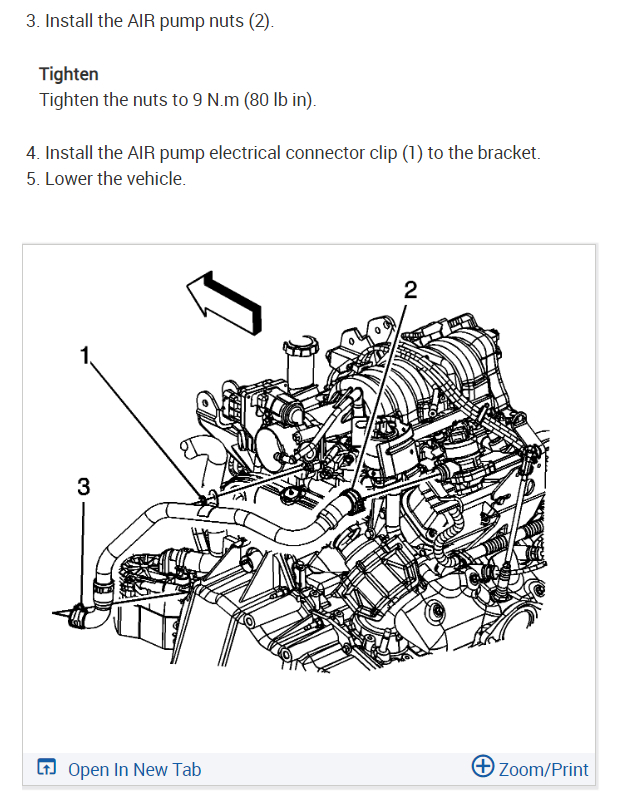

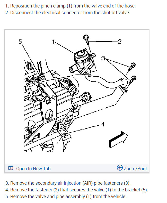

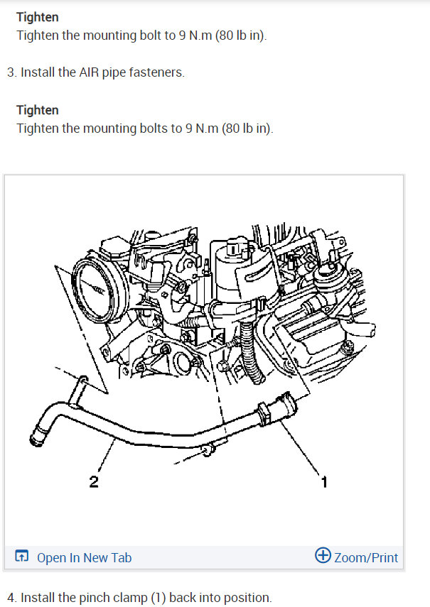

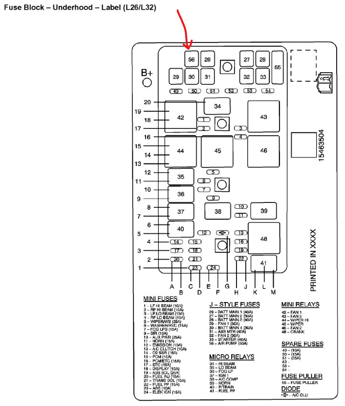

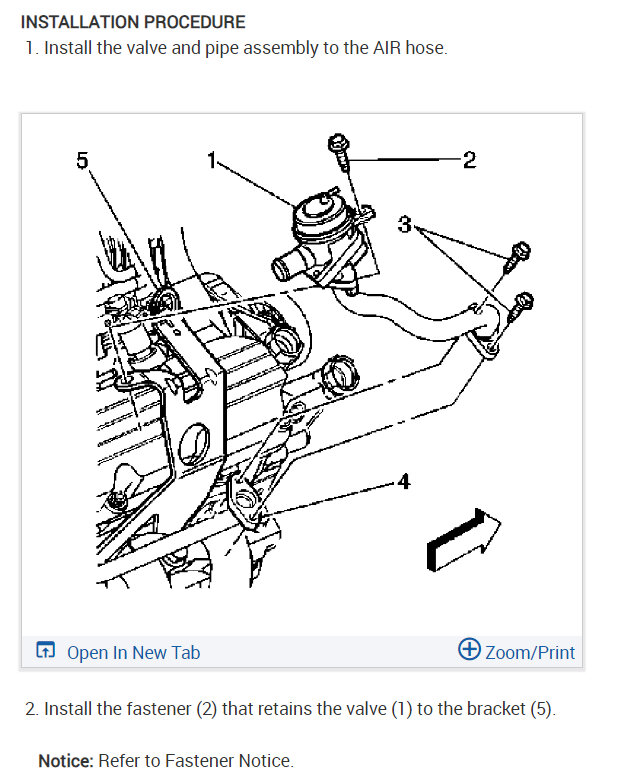

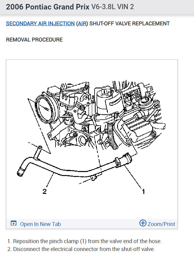

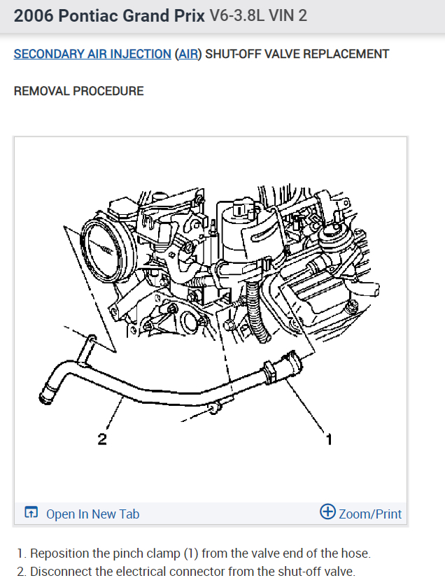

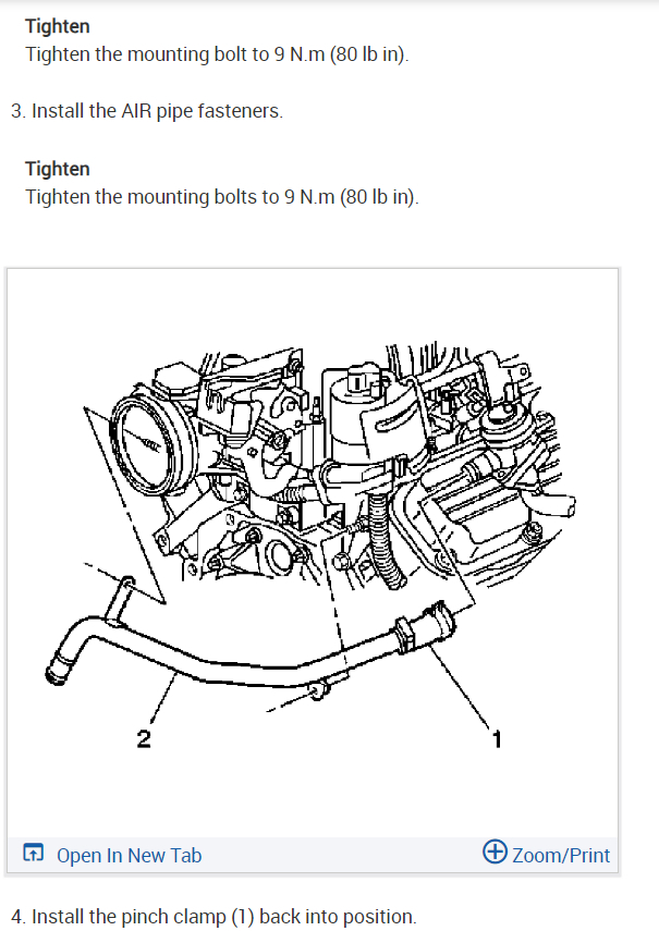

9 times out of 10 the problem will be the air injection control valve if the fuse and relay are okay, also, you should inspect the system to make sure there are no hoses or tubes that have holes in them or are not connected. Also make sure the Air pump relay is working as well.

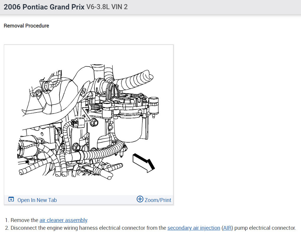

Left front of the engine compartment near the air cleaner duct.
The pressure sensor is inside the control valve, FYI. Check out the images (below). Please let us know what happens.

So, I should replace the fuse not the pump itself.
Nov 30, 2023 at 12:52 PM
  • 55,249 POSTS

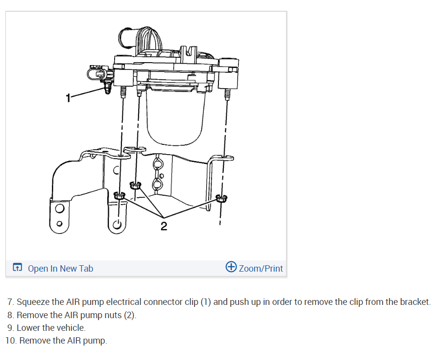

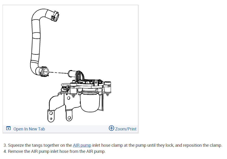

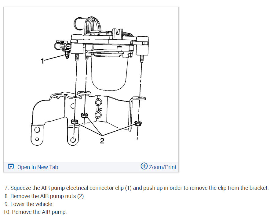

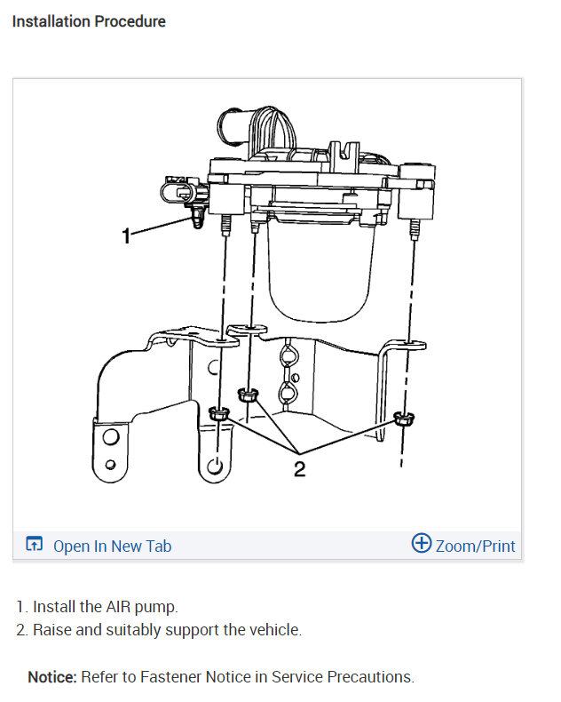

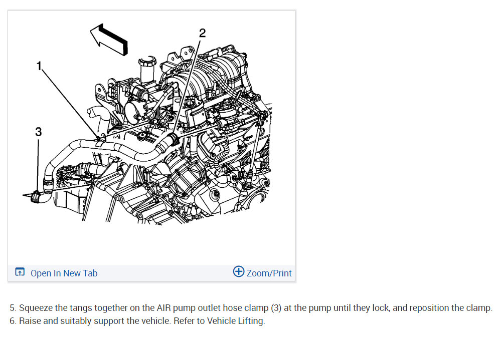

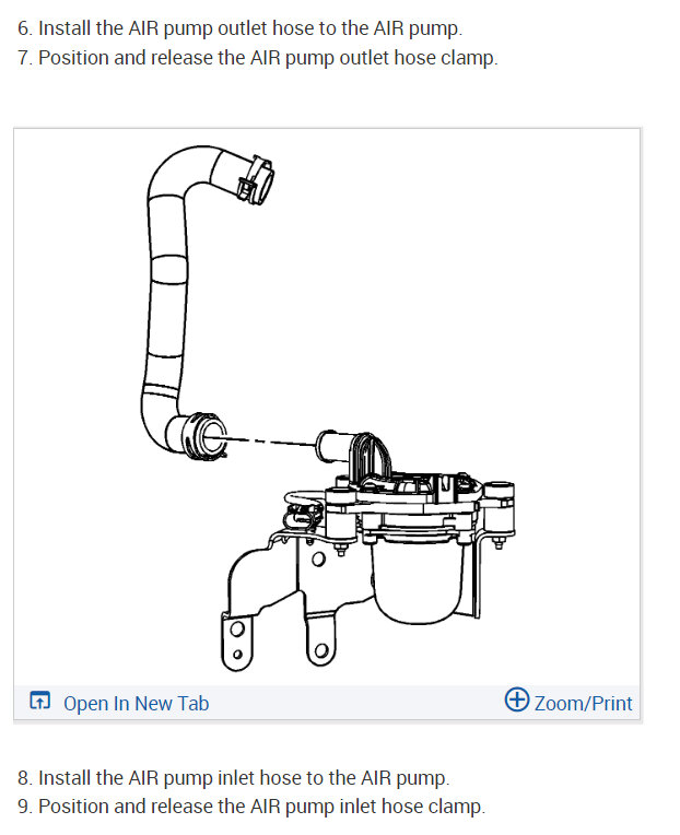

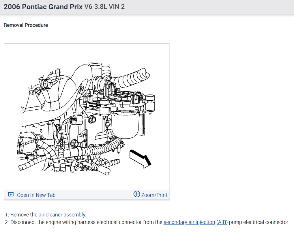

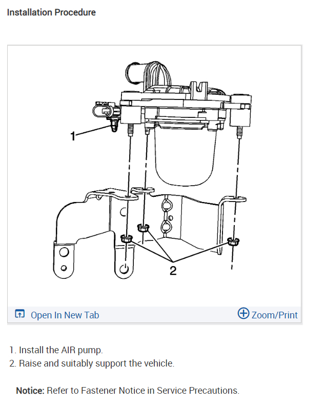

Is the fuse blown? if so yes replace the fuse if it blows again then replace the air pump, here is the location and instructions on how to do so. Check out the images (below). Let us know how it goes.
