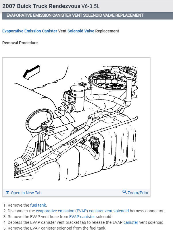

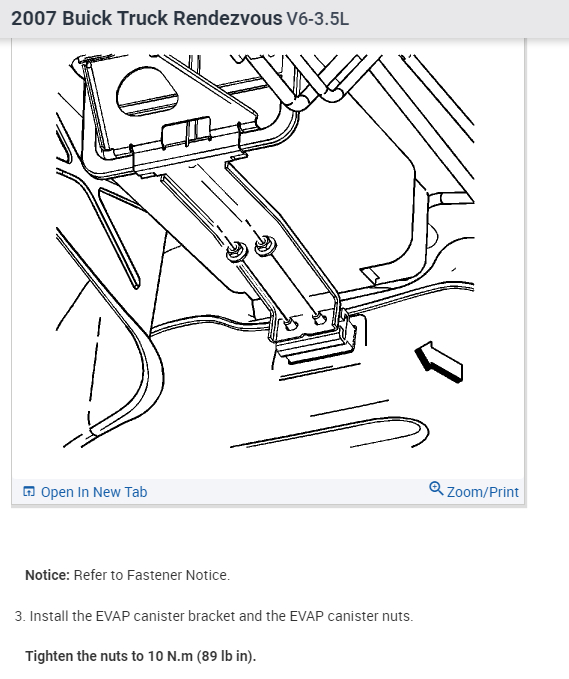

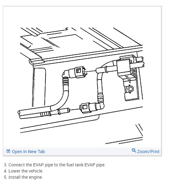

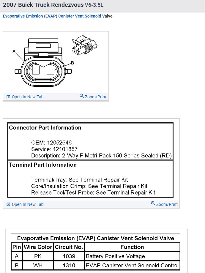

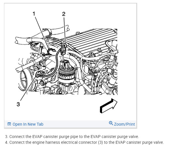

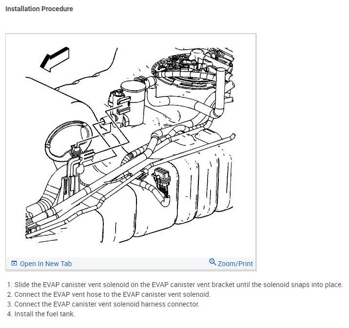

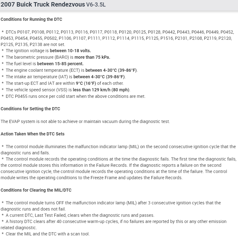

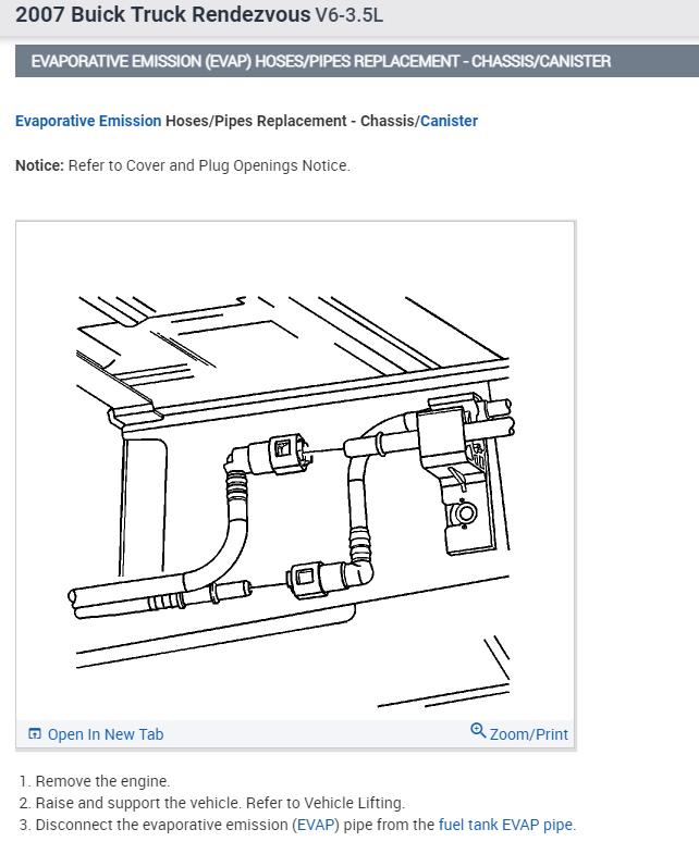

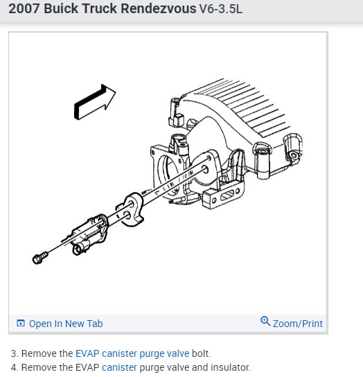

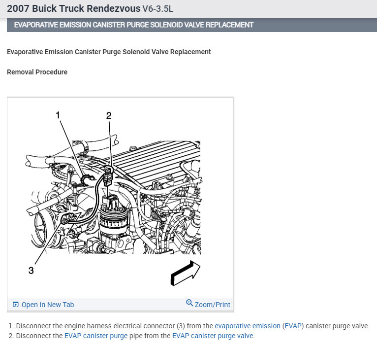

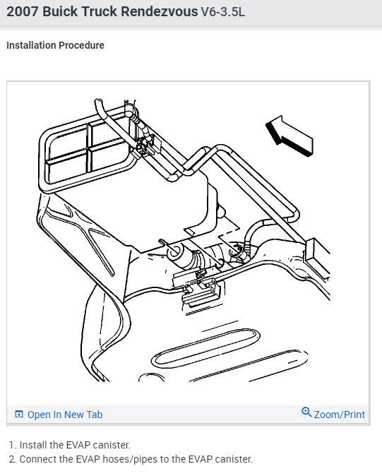

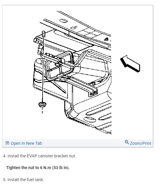

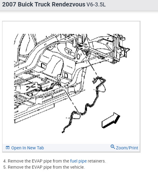

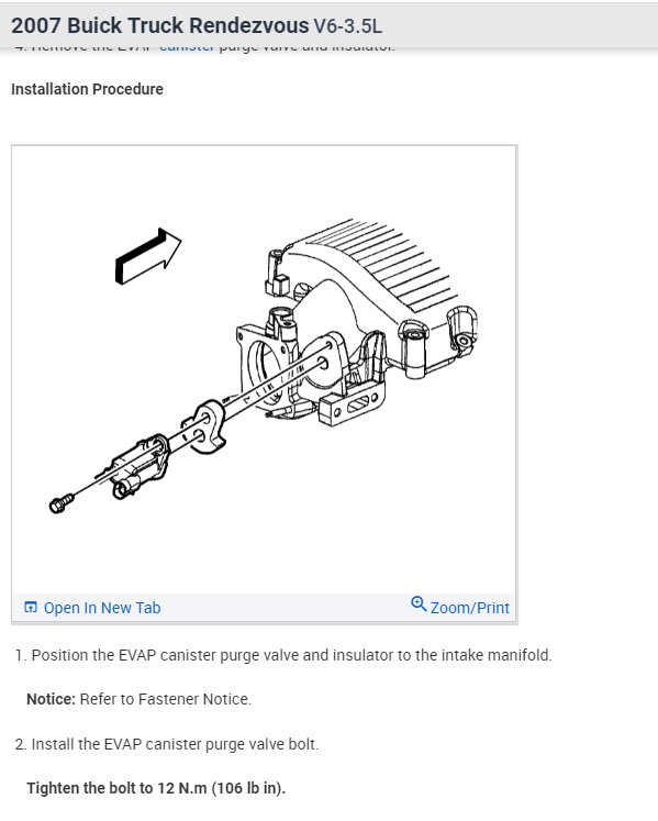

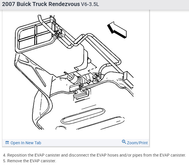

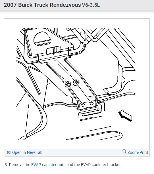

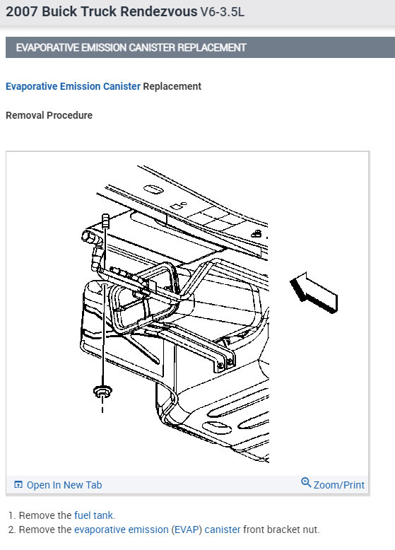

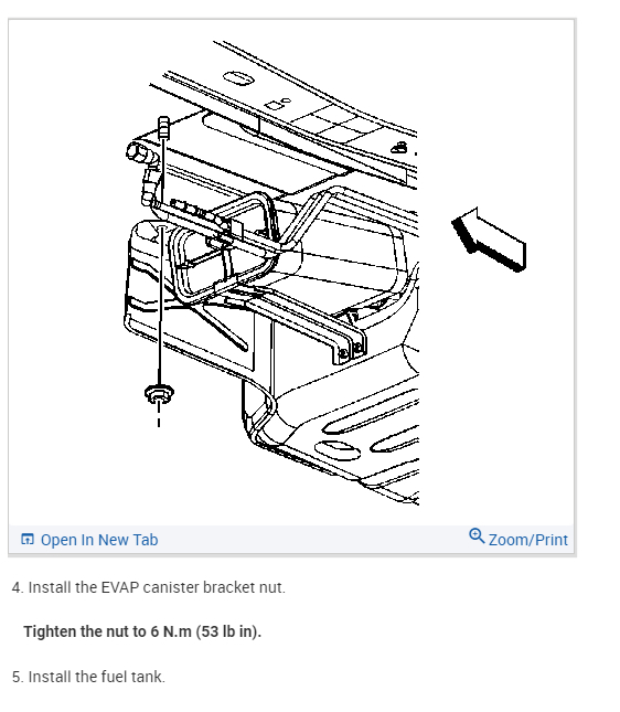

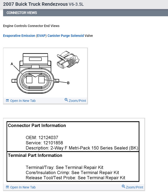

My son has the vehicle listed above he is trying to get checked and third code comes up. Do you have any diagrams on the locations of the emissions parts such as the canister purge valve etc? Thank you
Oct 13, 2021 at 1:03 AM
SQM
  • 6,383 POSTS

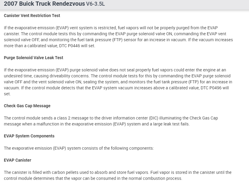

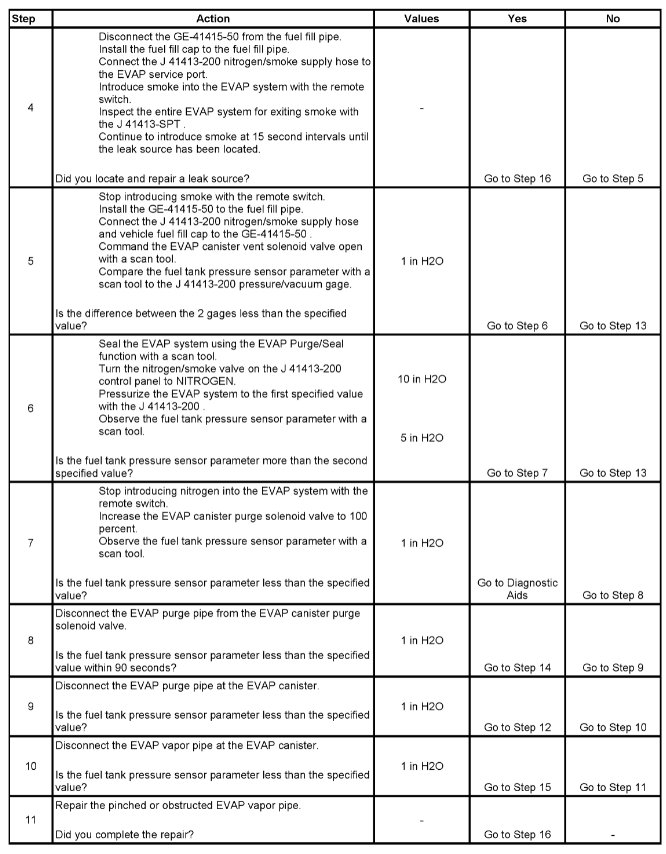

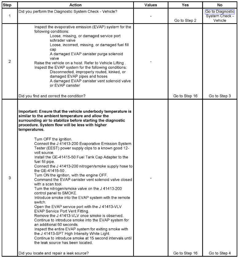

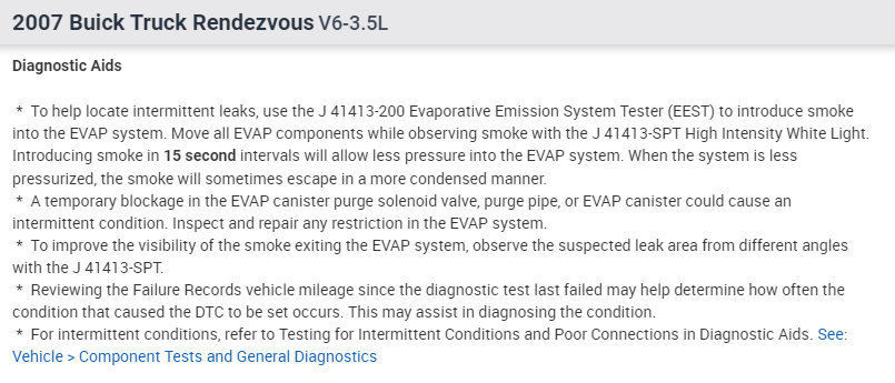

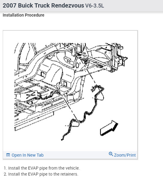

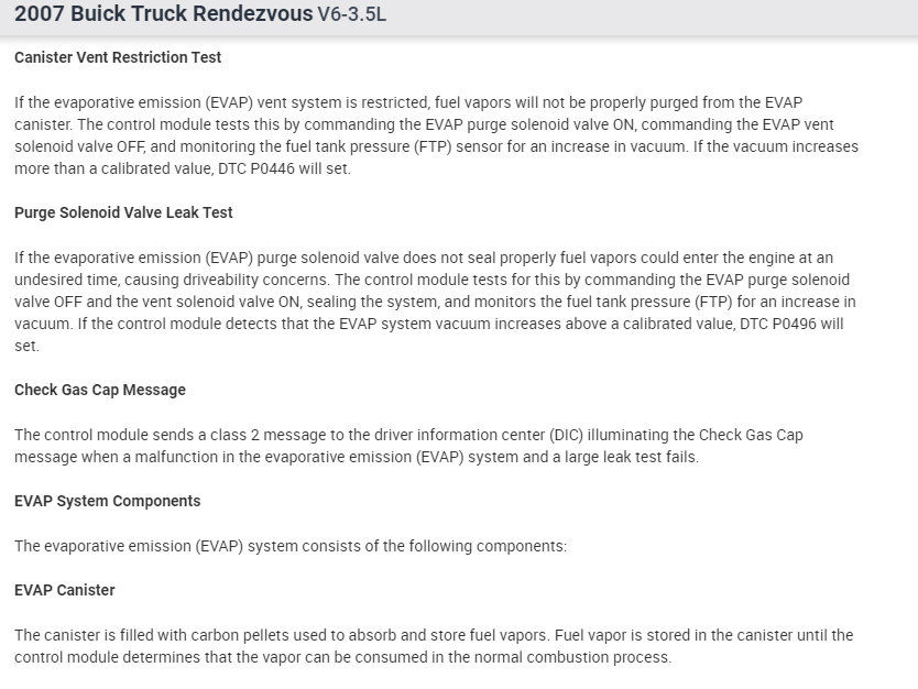

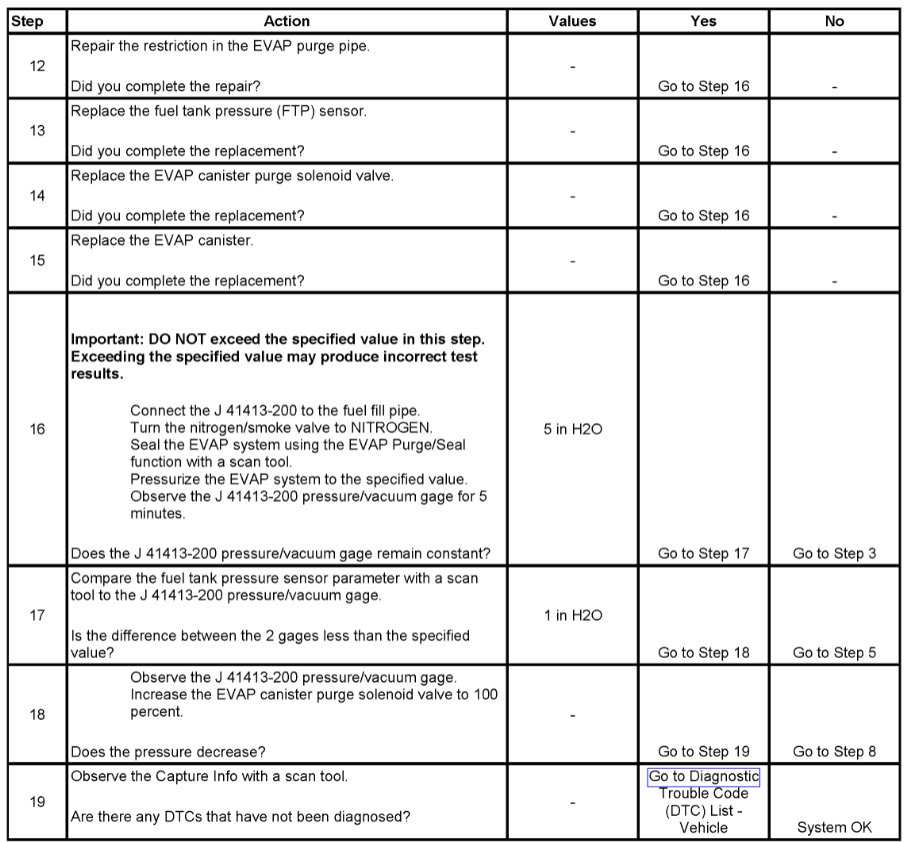

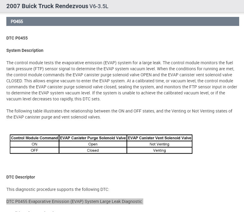

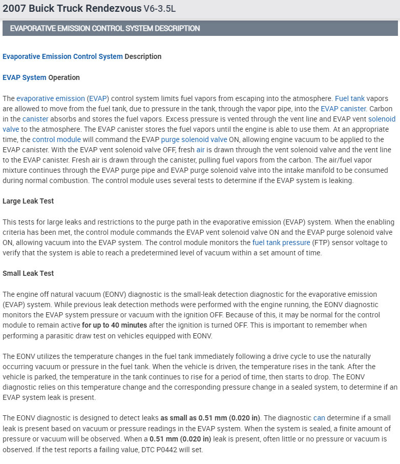

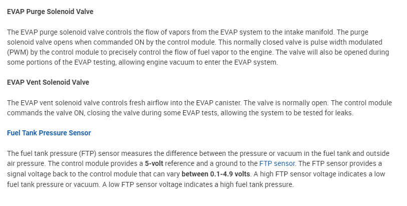

The code: P0455- Evaporative Emission (EVAP) System Large Leak Diagnostic
This gets triggered when there is a larger leak detected in the EVAP system. It could be a stuck open valve it can also be a cracked hose.
https://www.2carpros.com/articles/evap-system-code-repair
I have attached the trouble shooting steps for the P0455 (see below).
Also attached all the component diagrams and testing procedure for different type of issues.
