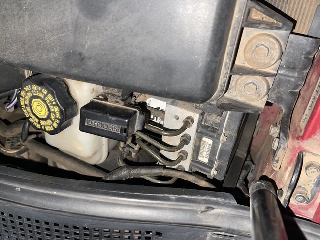

Problem: ESP light illuminated (always on)
Symptoms: Limp-Mode activated when ESP Off indicator trigger causing lost performance.
When to occur: Ignition on, no ESP OFF light, when car moving ESP OFF lights illuminated.
I have trouble to reset the DTC because it keep coming back.
I have faith that my ECU is still good condition because it if bad my car won’t crank/start.

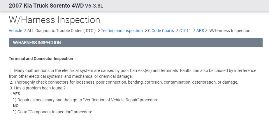

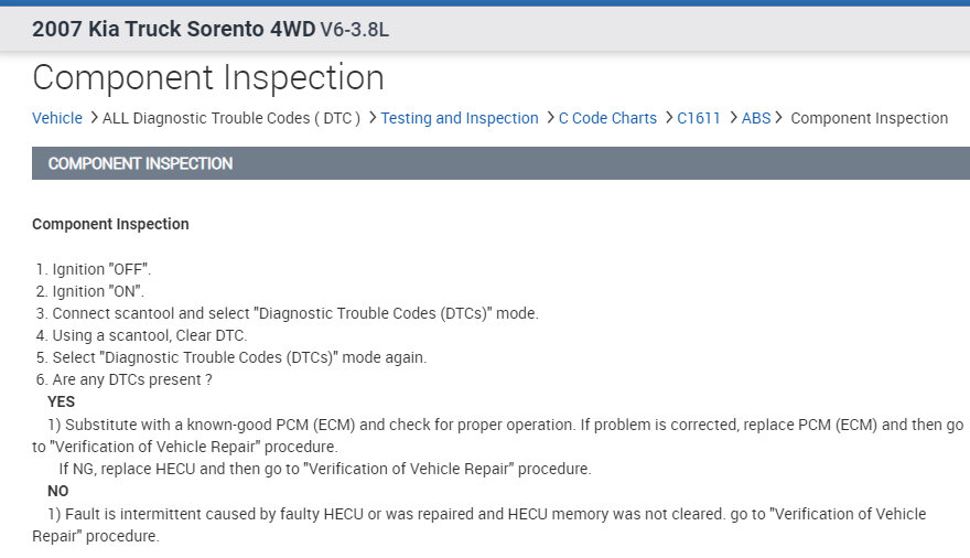

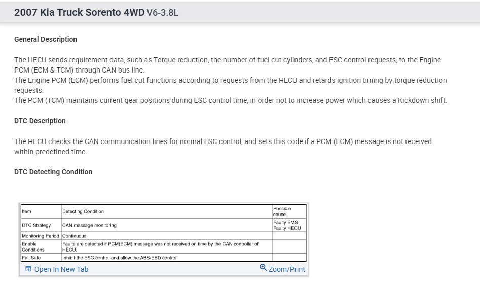

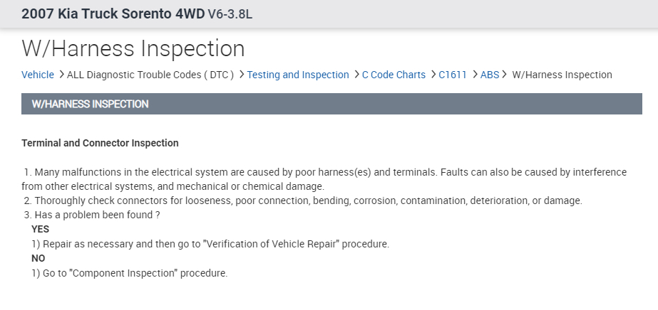

There could be an issue with the ECM/PCM with the communication between it and the ABS module.
Do me a favor. If you look below, I attached a general description related to the code, and then two checks that are recommended.
Take a look and let me know if you are comfortable performing them.

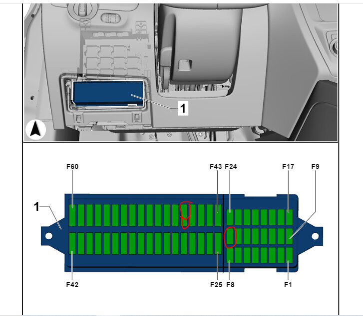

Hi, thanks for your reply, btw I need to confirm that I needed to check fuel pump fuses?
Jan 20, 2023 at 5:02 PM
SHAHRUL AZLAN SUHAIMI

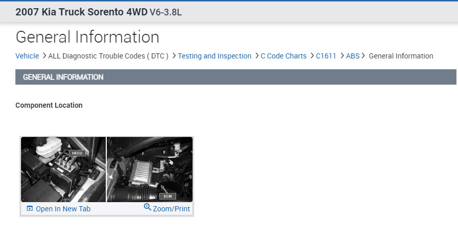

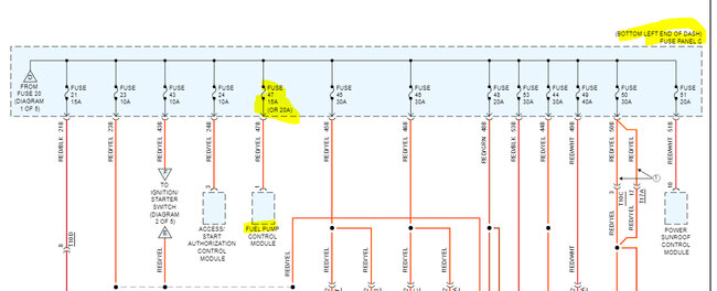

Update:
Image 3 already checked is good.
Image 4 unable to perform because I unable to locate those pin as attached picture.
Jan 20, 2023 at 5:17 PM
  • 110,241 POSTS
Are the locations for the fuses empty? I'm not sure why you are unable to locate them. Please explain.

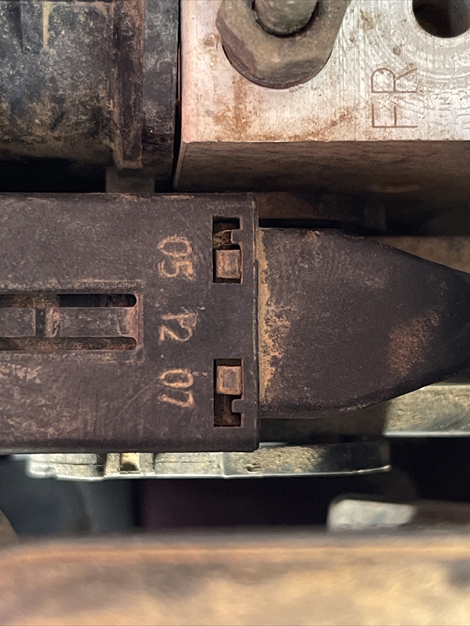

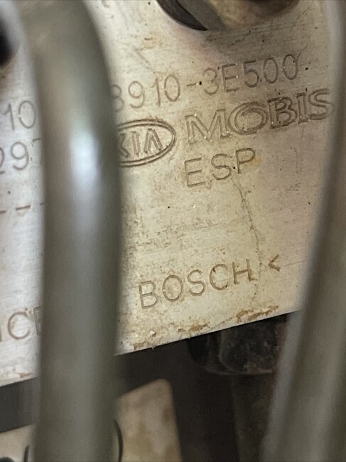

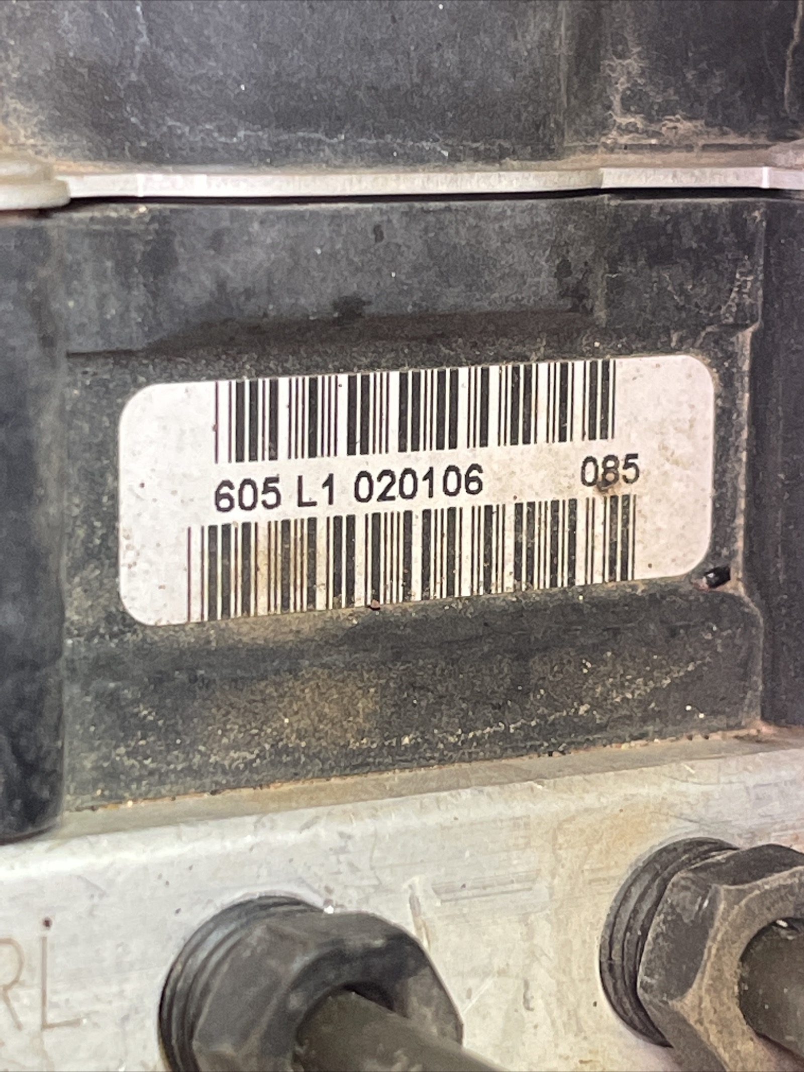

I searched around the fuse box and tried to locate the connector as you showed but it was not similar. Here is my part number and car VIN:
Model: BL-LHD(ESP) Y50 S/W 60067 / VER 0120
0 265 235 110
Part number: 58910-3E500
060208/1/2978
VIN: KNAJC526875649206

The pics I attached above didn't include a connector. If you are referring to pic 4, that is the fuse box in the vehicle.
Let me know if that is what you are referring to.
