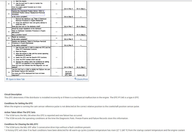

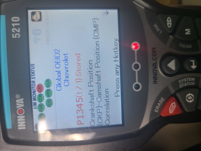

I just bought this truck. I was checking things out. I came up with code P1345. The engine runs fine. No misses or misfires. How do I repair this problem? I was thinking just to replace crankshaft position sensor.
Jul 23, 2021 at 1:41 AM

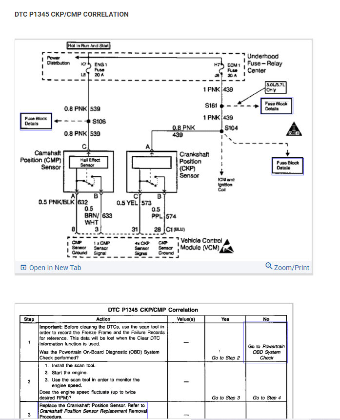

Good evening,

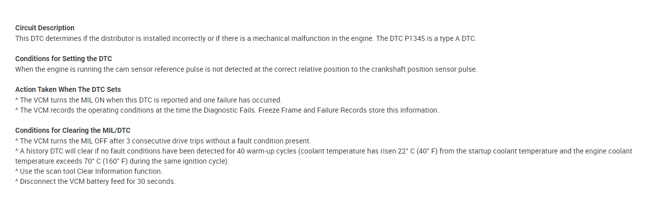

I attached the flowchart for you for the code. In most cases, it is the sensor but must be confirmed.
https://www.2carpros.com/articles/how-a-crank-shaft-angle-sensor-works
