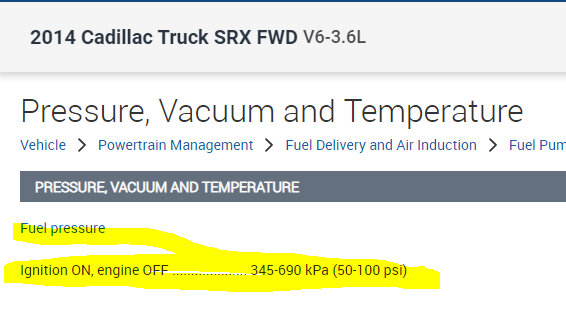

There are other things that can cause the code to set. However, it is odd that the converters are new.
I have a few questions. Has the vehicle ever been tuned up yet? Specifically, are the spark plugs original?
Also, have you checked fuel pressure to see if it is within the manufacturer's specifications?
If you haven't checked, I would. A lean or rich fuel mixture can lead to these codes. Here is a link that shows how it's done.
I attached the fuel pressure specifications below. Also, do you have a live data scan tool? If you do, we need to watch the O2 sensor voltages.
Here is a link that explains how that is done:
https://www.2carpros.com/articles/how-to-test-an-oxygen-sensor-02-sensor
I realize the sensors are new, but there could be a wiring issue causing them to not work properly.
Try these things and let me know what you find.
See pic below.
Sep 13, 2024 at 1:29 PM

Hi Joe,
Voltage for sensors is correct..
I considered plugs....
Have them already and will try to change today....
Also...Will drive more today...
To add a few more Drive Cycles..
Will also check the Fuel Pressure per your advice..
Thank you
