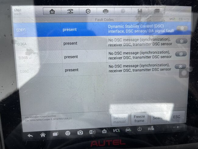

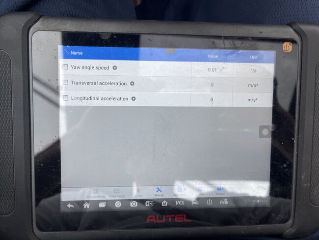

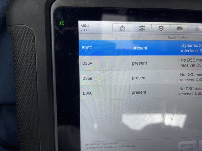

Dtsc light and warning message on, yellow brake light on, ABS light is not on. I checked the codes, they attached. If you delete them, they will go off and you can start the car and drive, but they come back after a few. I checked wheel sensors on scanner, and they all are working fine. Hard to differentiate whether it's an issue with the clock spring or abs control module and am not sure if the ABS control module is the same as the dsc module.

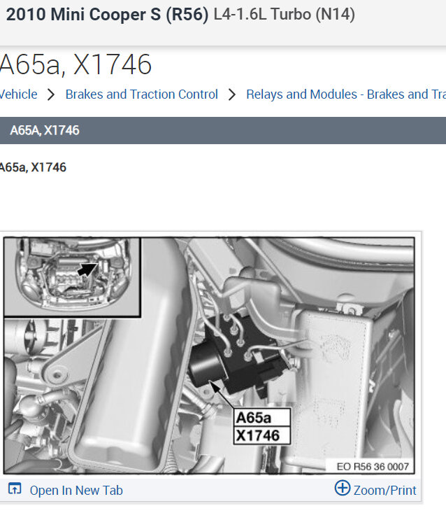

Yep, the traction control and ABS module are the same thing, which looks like it needs to be replaced. I would check the fuses first and if okay replace the module here is how. Check out the images (below). Let us know if you need anything else.

I doubt they need progi. Am just surprised why the ABS light is not on, brake pad, tract, toms and yellow brake light are on. I see a new brake pad light that was installed but its just hanging and it's still new but connected to the pads, but these codes are not related to that am sure.

Those lights are triggered by the ABS module, this is why I wanted you to check the fuses and if okay the ABS control module would be the next step.
