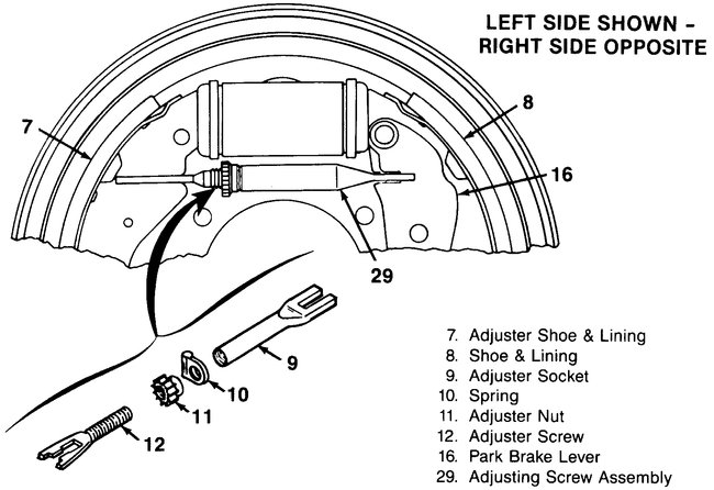

Or here are the directions from Alldata. The attached picture correlates with the directions.
____________________________
1988 Chevy Truck C 1500 Truck 2WD V8-350 5.7L
With Leading/Training Brakes
Vehicle Brakes and Traction Control Drum Brake System Brake Shoe Adjustments Drum Brakes With Leading/Training Brakes
WITH LEADING/TRAINING BRAKES
Exploded View Of Drum Brake Assembly.
Pic 1
Exploded View Of Adjusting Screw Assembly
Pic 2

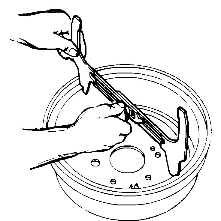

4. Using drum to brake shoe clearance gage tool No. J-21177-A or equivalent, measure brake drum inside diameter.
5. Turning the adjuster nut, adjust shoe and lining diameter to 0.254-0.508 mm (.010-.020 in), less than the inside drum diameter for each rear wheel.
6. Ensure stops on park brake levers are against the edge of the brake shoe web. If the parking brake cable is holding the stops off the edge of shoe web, loosen the parking brake cable adjustment.
7. Tighten parking brake cable at adjuster nut until the lever stops begin to move off the shoe webs. Loosen adjustment nut until the lever stops moving back, barely touching the shoe webs. There should be no more than 0.5 mm (0.019 in) clearance between stops and either web.

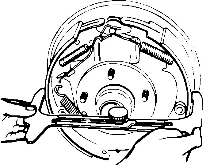

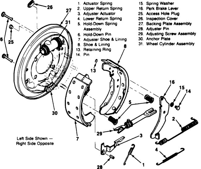

If you look at pic 3 and 4, they show how initial adjustment is done.
Fig. 7 Measuring Brake Drum Inside Diameter
Pic 3
Fig. 8 Adjusting Brake Shoes To Brake Drum Inside Diameter
Pic 4
8. Using suitable brake drum to shoe gauge, Fig. 7, measure brake drum inside diameter. Adjust brake shoes to dimension obtained on outside portion of gauge, Fig. 8.

So I ordered new drums, and hardware. Supposed to get them tomorrow. I went ahead and pulled drums today. Passenger side looked okay. Driver side was malfunctioning. The pin that holds the parking brake lever in place had come undone and was jammed behind brake shoe. The spring washer and clip were gone. I assume this was the reason for no parking brake (I know it was), as well as why the brakes were not releasing properly. The pin was pretty beat up.
