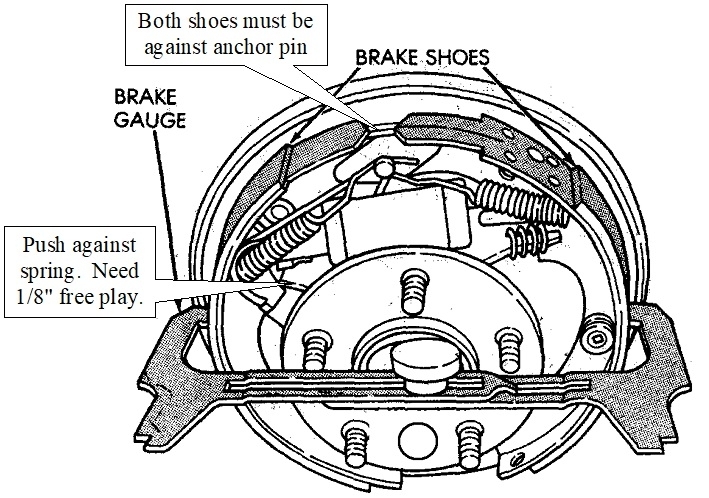

Actually it's quite common, but the cause can be elusive. With the drum off, look at the "parking brake strut bar" between the two shoes, right below the wheel cylinder. You'll see there's an anti-rattle spring on one end. Use your thumb to push against that spring. The bar should move a good 1/8th inch. If it's tight, look at the parking brake lever attached to the back of the rear shoe. That should be fully retracted so it's hidden from sight behind that shoe frame. It's most likely pulled forward due to a stuck parking brake cable. Another clue is that lever will move forward and back as you flex the parking brake cable right behind that brake assembly.
If the parking brake cable is just sluggish, use a large pry bar to retract the lever. At that point the play in the strut bar should return. If this doesn't help, post a photo of one of the brakes with the drum removed.
If it does help, do not try to lubricate the sticking cable. It must be replaced. When performing safety inspections on trade-ins at a very nice new-car dealership, we were only allowed to replace parking brake cables, or cut them. Cutting them was legal as long as it was disclosed on the window sticker. Even if lubricating them appeared to get them working properly, it was well-known that vehicle was going to come back sooner or later on a tow truck with a stuck cable.
If that strut bar is tight, also look at the anchor pin on top. Both brake shoes must be against that pin. If the parking brake is stuck partially applied, one or both shoes will be held away from that pin. When you push that shoe up to the pin, it will cause the other shoe to move away.
This drawing is of a different design, but the parts I described are the same as yours.

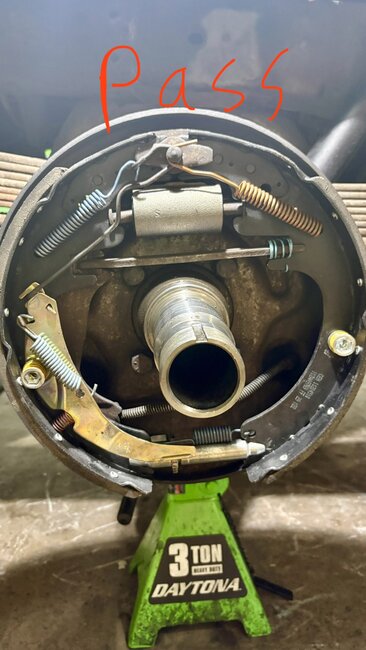

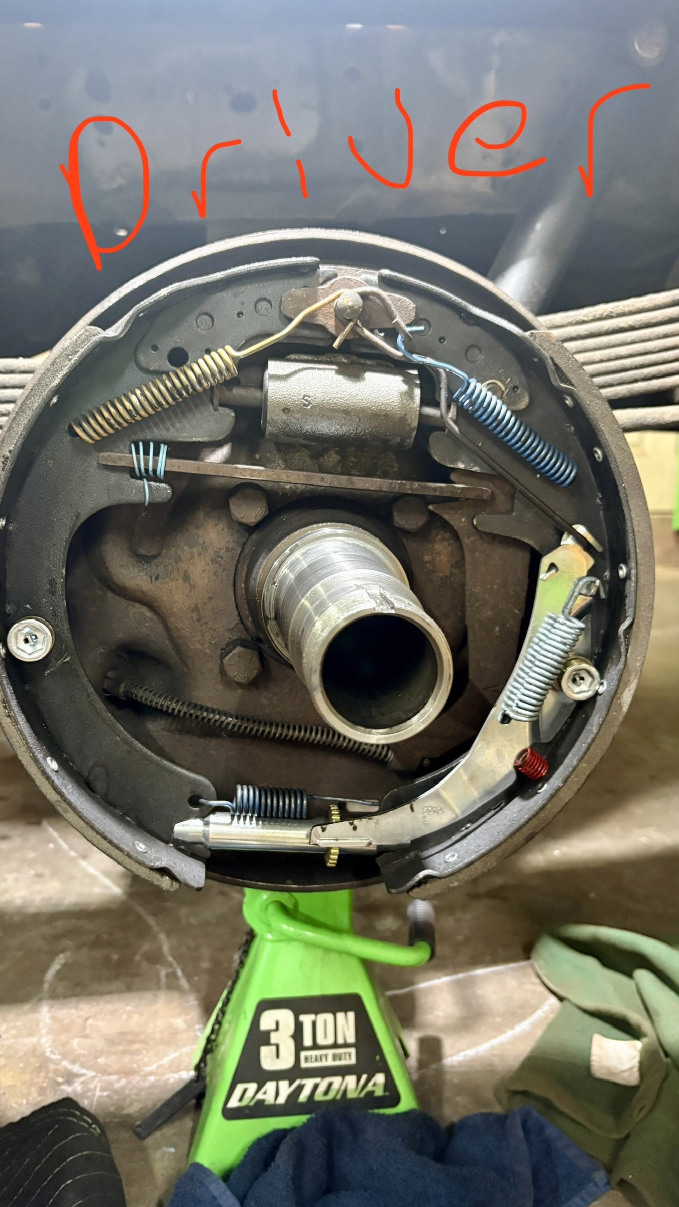

I will test the parking brake stuff, as recommended, tomorrow. Here are pictures of the current set up, in case that helps.

Driver side strut bar has no play at all, only when I pry the parking brake lever back with pry bar. Passenger side, same story but has very little play, but not 1/8”.

Dandy photos. Look at the parking brake lever on the right side and see how far back it is, hidden behind the rear shoe.
On the left side, it's pulled forward all the way to the fully-applied position. That's what took up the free play in the strut bar. Also notice on top, the rear, or "trailing" shoe is not touching the anchor pin on top. If you push that shoe up to that pin, you'll see the front, or "leading" shoe move away from the pin. Another sign of an applied parking brake.
I also noticed the star-wheel adjusters on both sides are turned down, or shortened almost as far as possible. Even with new shoes and new drums, they're normally adjusted out roughly a 1/4" of threads showing. With worn drums, and even more so with drums that have been machined, those adjusters will be extended a lot more. Shortening them as much as you have is in response to the tops of the shoes being held out too far. That's the only way to get the drums on.
On most vehicles there's three parking brake cables we're concerned with. Those are the two rear cables, one going into each backing plate, and the front one coming down from the parking brake pedal. There's also, at a minimum, one intermediate, or connecting cable that ties all the other three together. We don't worry about that connecting cable unless it's broken. It isn't in a casing so it can't stick. With the two rear cables, first look at the front end where the casing is snapped into a metal bracket welded to the frame. If this sticking is fairly new, right where the cable comes out of the casing, you'll see about an inch long section that's shiny, or cleaner than the rest of that cable. That shiny area shows the part that's supposed to be retracted back into the casing. Use a pry bar on the driver's side to force the parking brake lever back behind the rear shoe, to its retracted position. If you can't do that, that cable is rusted tight and must be replaced. Another clue to a rusted rear cable is if you flex the casing by hand, you'll see the parking brake lever move back and forth a little. It's doing that because the cable is not free to slide around inside the casing.
On the right side, grab that cable ahead of the casing, where it's exposed, and tug on that. What should happen is the parking brake lever gets pulled forward, then it retracts under spring pressure when you release the cable. If that movement takes place freely, that cable is okay.
If you're able to pry the left lever back to its retracted position, look at the right lever now. If it is still retracted, as in your photo, the intermediate cable was likely drooping, and now it's tight. More likely, if forcing the left lever back causes the right lever to move forward, there's too much tension on those cables. Either the front cable is sticking, in which case the parking brake pedal would not retract on its own, or the cable adjustment is too tight.

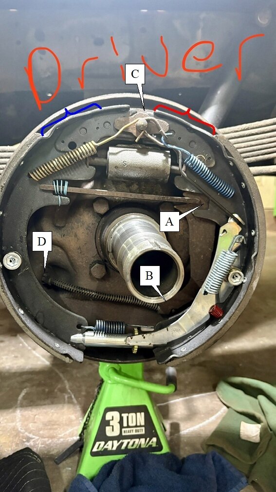

To add to the excitement, I added some callouts to your left photo to help me explain this better. If it's too difficult to see, copy and paste it into a typing program where it can be expanded. I use MS Word for this.
"A" shows the gap between the end of the strut bar and the frame of the rear shoe. It's much larger on the left brake, indicating that parking brake is applied.
"B" shows the same condition. The lever is pulled as far forward as possible.
"C" shows where the rear shoe hasn't retracted back to the anchor pin. They can't move out any further on top, so under hard braking, the bottoms of the shoes get pushed out which activates the self-adjuster. That makes that brake self-adjust up too high until the shoes are dragging.
I added "D" in case you need to replace a cable. There's three or four tangs that must be squeezed in to let the cable be pulled out of the backing plate. If the cable is being replaced, it's faster and easier to just bend those tangs to break them off. To access those in back, use a pair of pliers behind the backing plate to rotate the casing until you can get to them.
The red and blue brackets at the top are the same length. The red one shows how much shorter that lining is on the shoe toward the front of the truck, (leading shoe).
Let me know what you find with these cables. The rest of the job looks fine.
