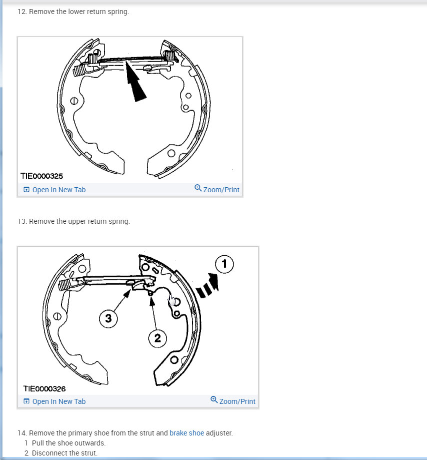

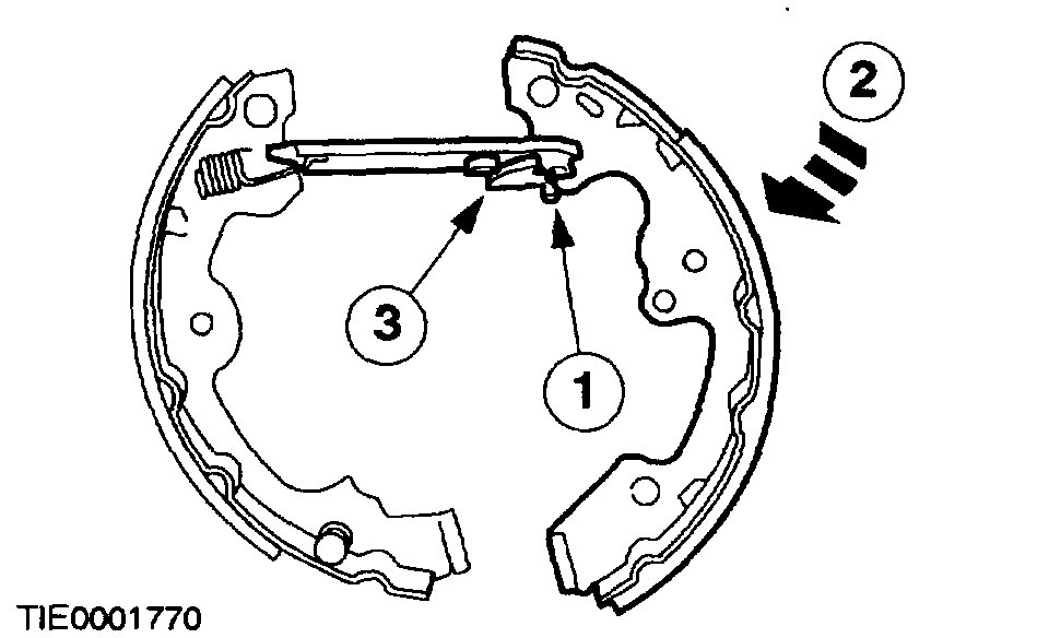

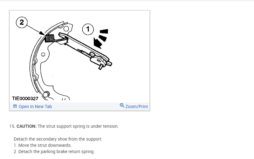

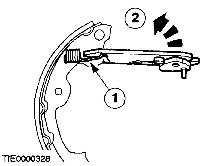

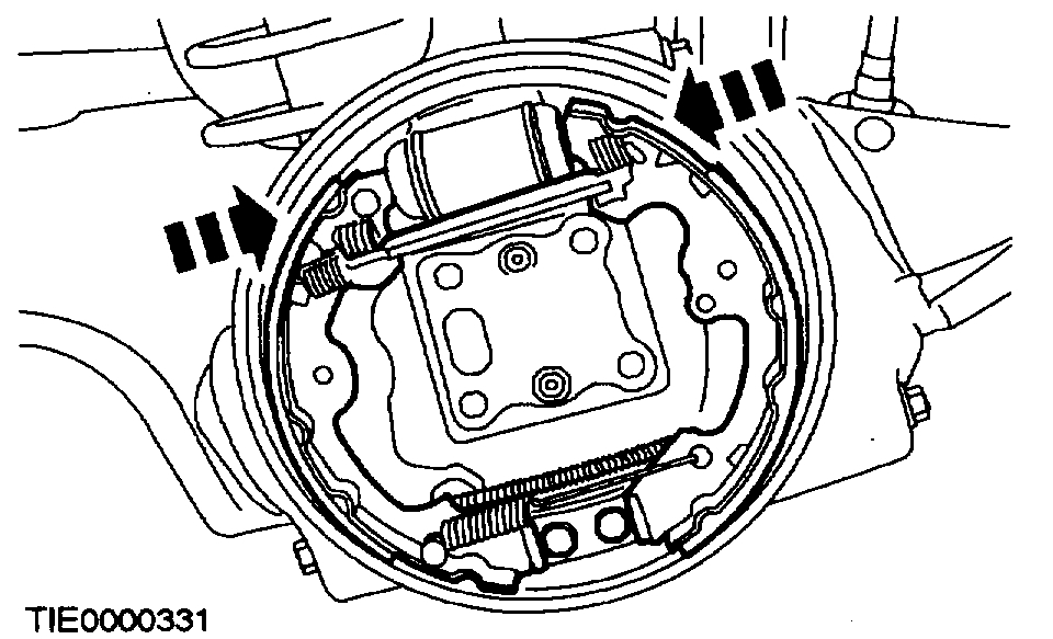

Having trouble with the adjustment bracket? Right rear drum. New shoes and hardware, drum and wheel cylinder.. everything looks the same as parts before. How can I get the spring on under adjustment bracket and make final adjustments? I thought I had it pretty good, but yet didn't seem like tooth was fitting where it should be. do I really need all my springs?
Frustrated with it. Help.

You definitely need all the springs. Here is the complete process. Are you "assembling" the shoes with the springs and then attaching the parking cable and then putting them up on the hub?

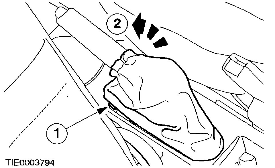

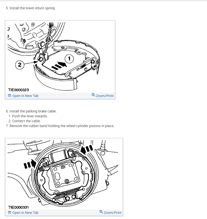

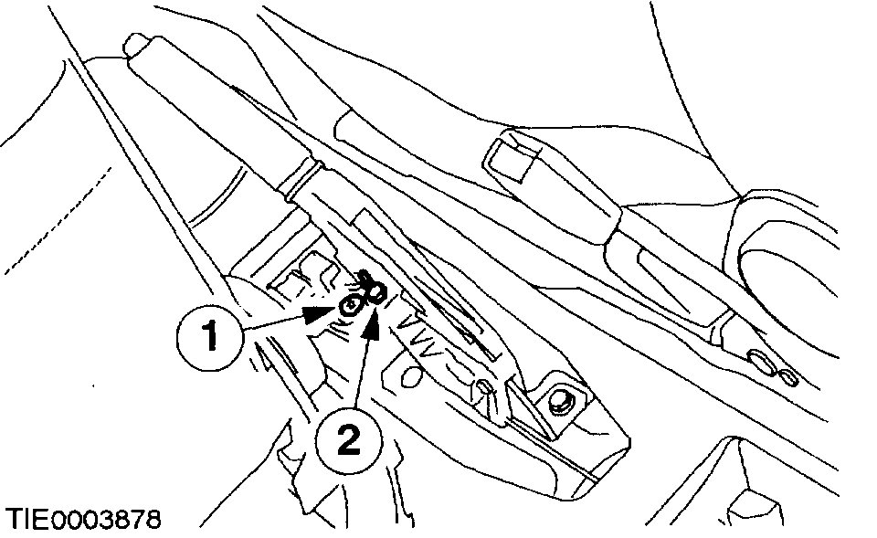

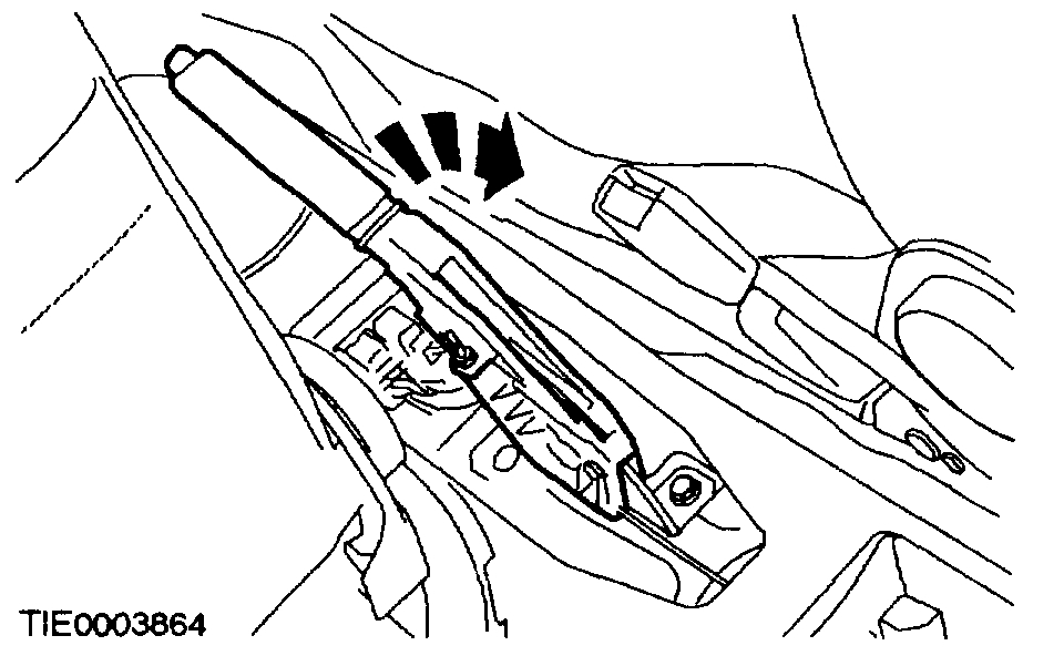

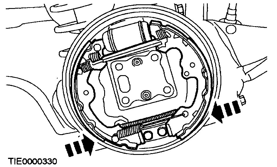

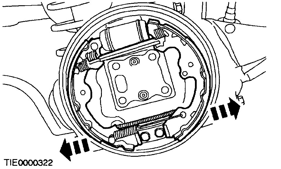

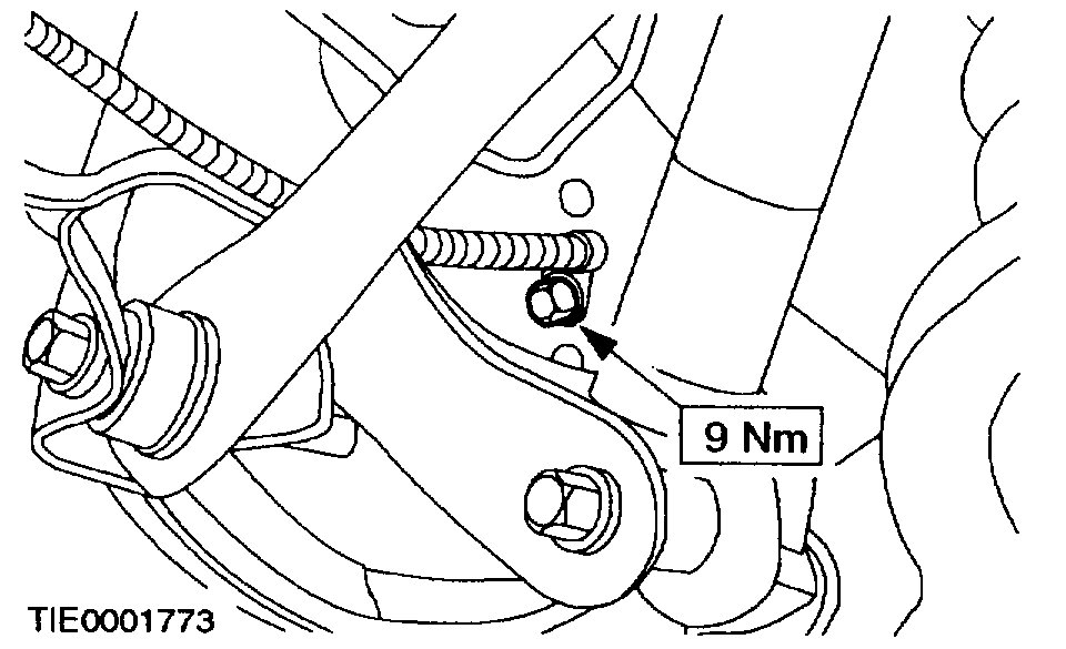

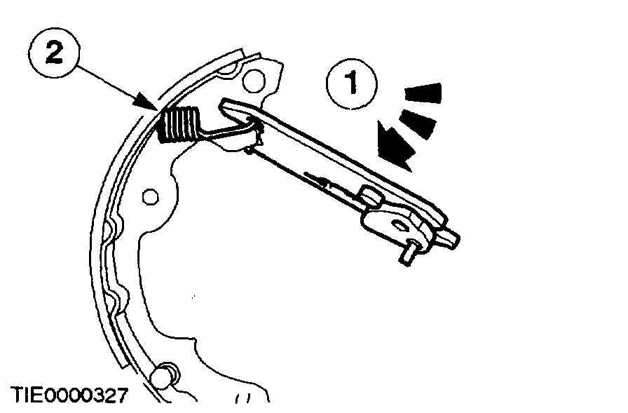

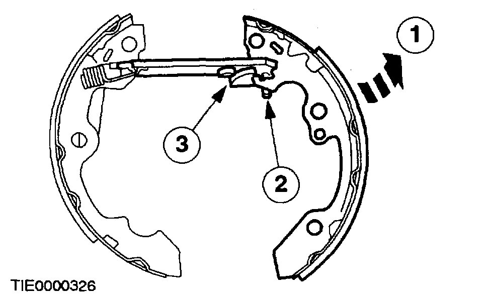

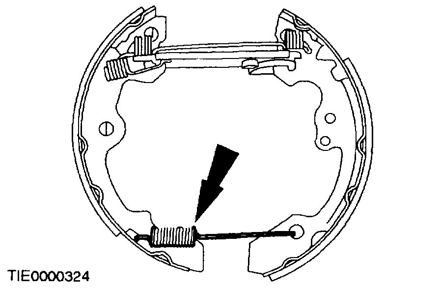

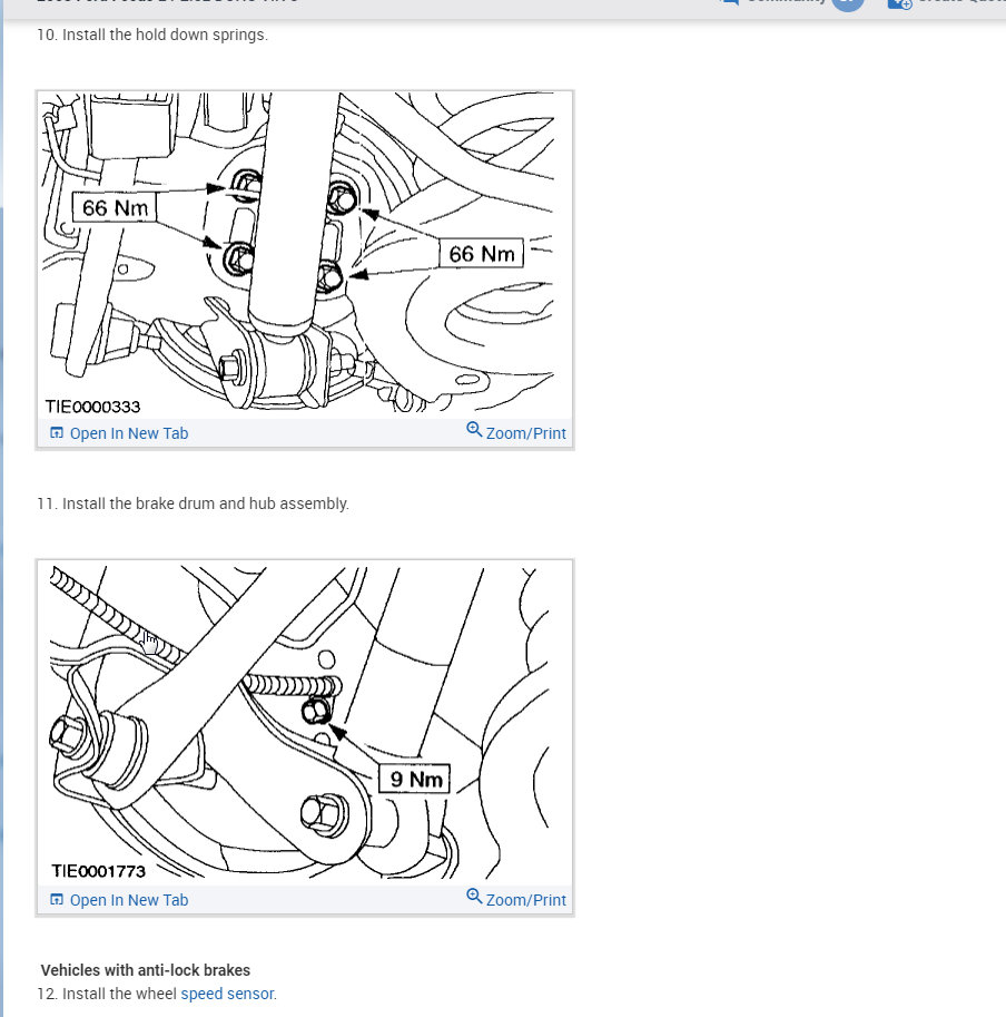

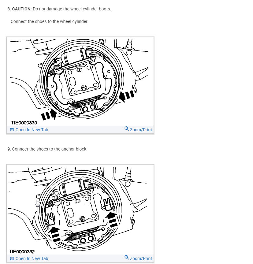

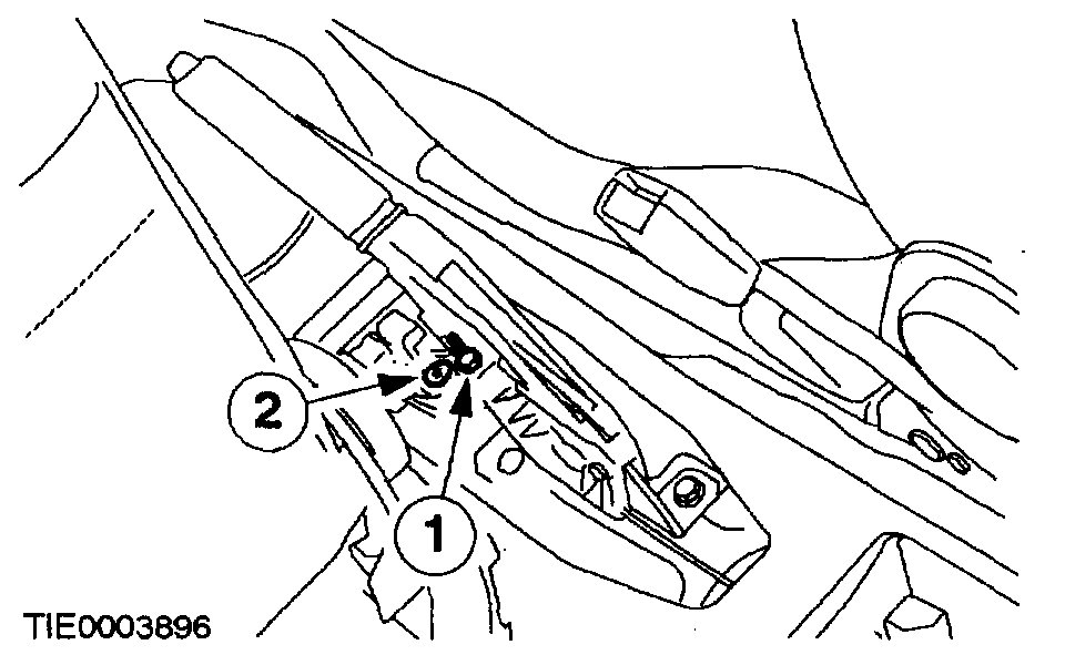

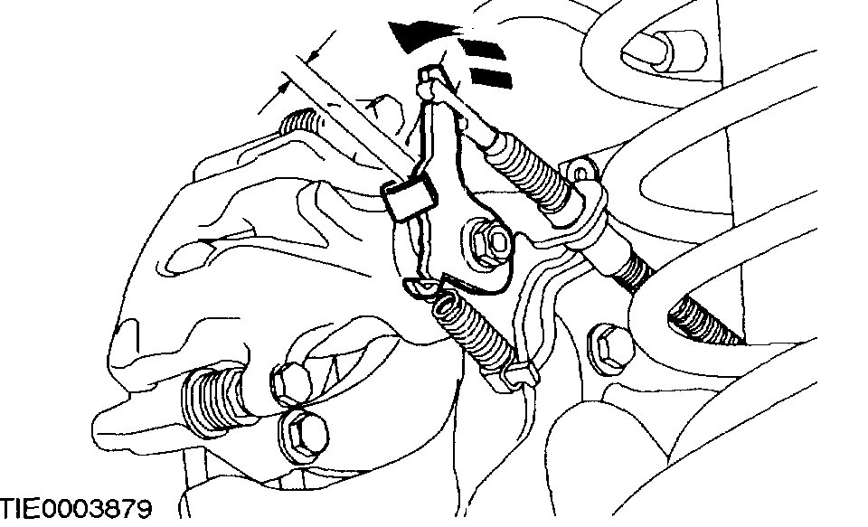

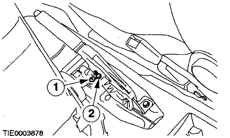

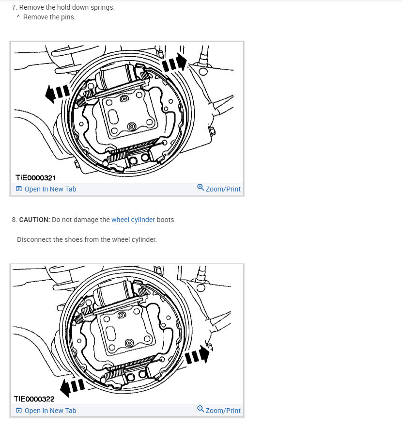

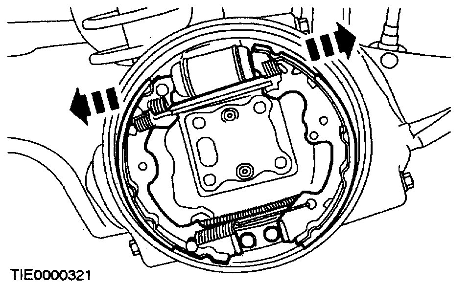

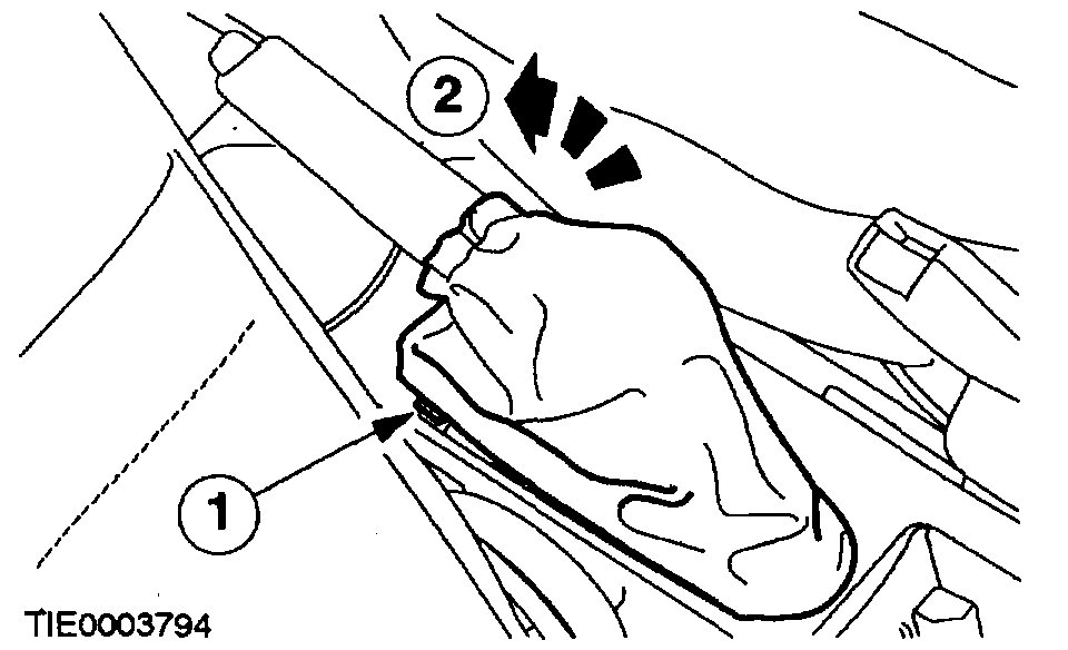

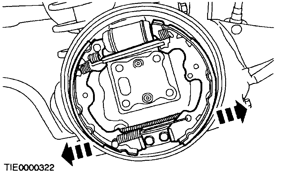

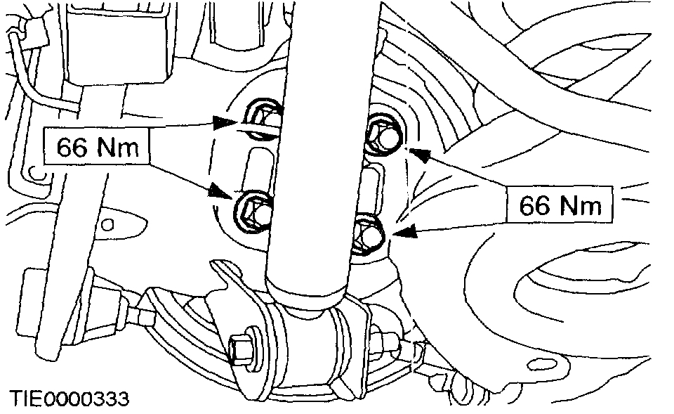

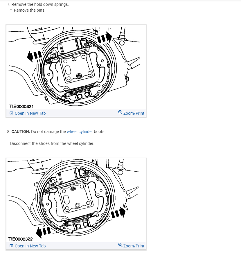

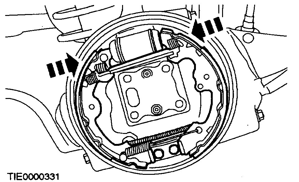

I know the feeling. Hang in there. I am going to provide the directions from A to Z for shoe replacement and adjustment. Take a look through the directions to confirm everything is together correctly and if the directions for the adjuster and adjuster spring install help. All of the attached pics correlate with these directions. I realize you don't need all of them, but I'm adding everything in the event you skipped a step.

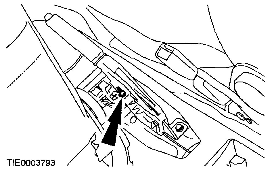

1. Remove the parking brake control boot.
1 Detach the boot clip.
2 Remove the boot.
2. NOTE: Make sure the rear brakes are at a cool temperature.
Release the parking brake control to its lowest position.

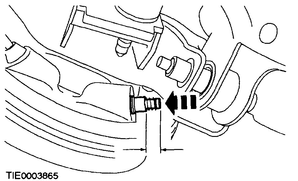

3. Loosen the parking brake cable adjustment nut until there is no tension in the cable.
1 Remove the retaining clip.
2 Loosen the adjustment nut.

pic 3
Vehicles with anti-lock brakes
5. Detach the wheel speed sensor.
pic 4
All vehicles
6. CAUTION: Do not remove the brake drum by means of the hub retaining nut.
Remove the brake drum and hub assembly.

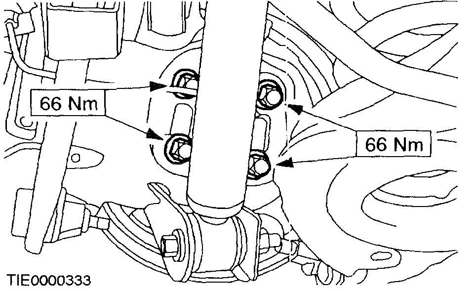

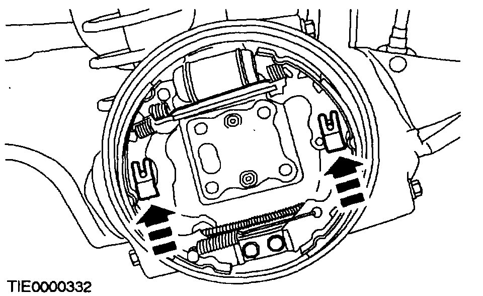

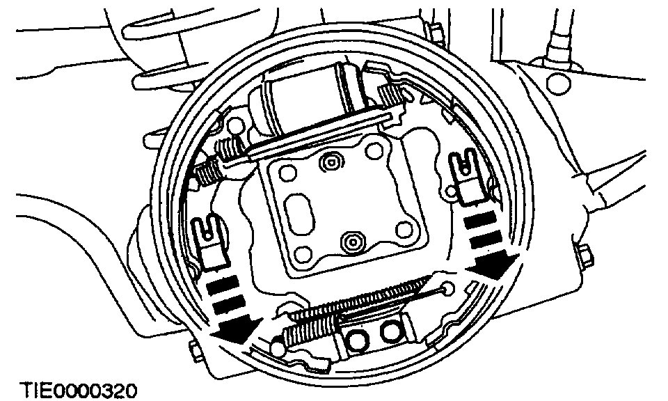

7. Remove the hold down springs.
^ Remove the pins.
pic 6
8. CAUTION: Do not damage the wheel cylinder boots.
Disconnect the shoes from the wheel cylinder.
pic 7

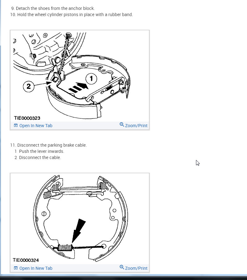

9. Detach the shoes from the anchor block.
10. Hold the wheel cylinder pistons in place with a rubber band.
pic 8
11. Disconnect the parking brake cable.
1 Push the lever inwards.
2 Disconnect the cable.
pic 9
12. Remove the lower return spring.
pic 10
13. Remove the upper return spring.
pic 11

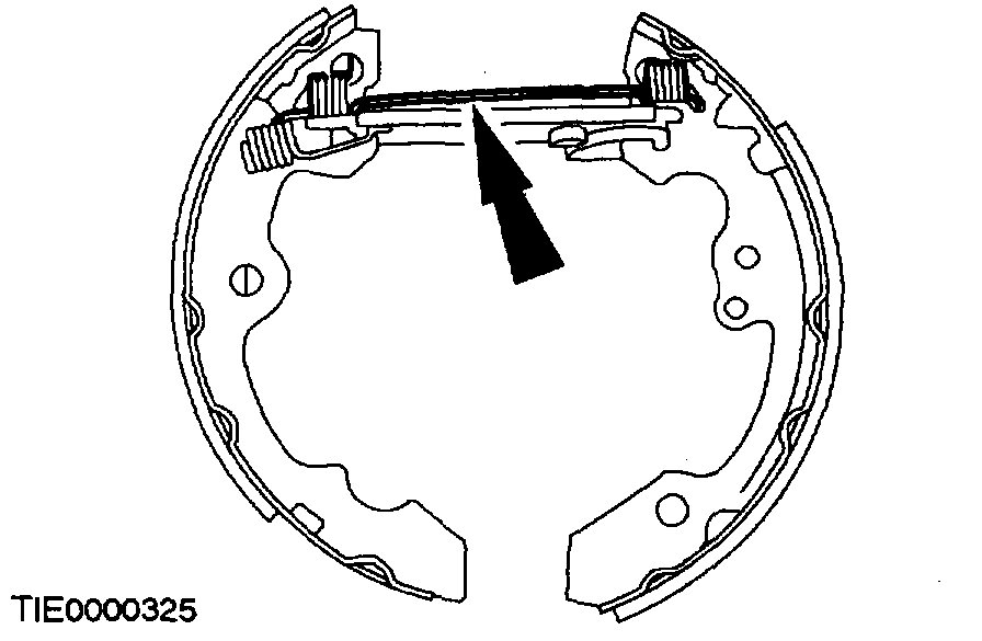

14. Remove the primary shoe from the strut and brake shoe adjuster.
1 Pull the shoe outwards.
2 Disconnect the strut.
3 Release the strut.
pic 12

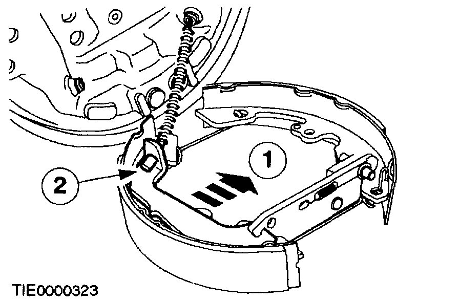

15. CAUTION: The strut support spring is under tension.
Detach the secondary shoe from the support.
1 Move the strut downwards.
2 Detach the parking brake return spring.

2. Install the strut support to the secondary shoe.
1 Install the parking brake return spring.
2 Move the strut upwards.
pic 14

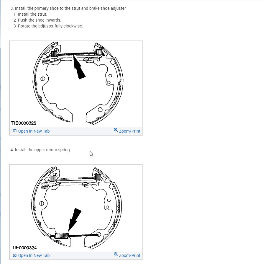

3. Install the primary shoe to the strut and brake shoe adjuster.
1 Install the strut.
2 Push the shoe inwards.
3 Rotate the adjuster fully clockwise.
pic 15
4. Install the upper return spring.
pic 16
5. Install the lower return spring.
pic 17
6. Install the parking brake cable.
2 Connect the cable.
7. Remove the rubber band holding the wheel cylinder pistons in place.
pic 18
Connect the shoes to the wheel cylinder.
pic 19
9. Connect the shoes to the anchor block.
pic 20

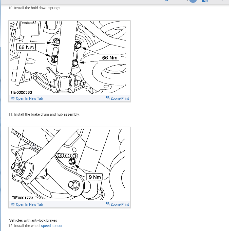

10. Install the hold down springs.
pic 21
11. Install the brake drum and hub assembly.
pic 22
12. Install the wheel speed sensor.

14. NOTE: The internal auto adjuster must be set and the brake shoes centralized to the brake drum.
Rotate the rear wheels and apply the brake pedal four times.
2 Remove the boot.
