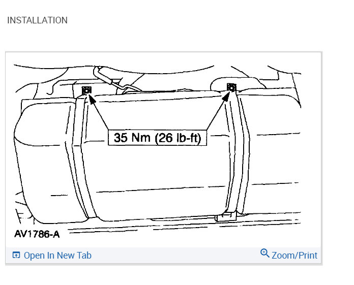

The car is running about 20-29 lbs of fuel pressure under a load it drops and goes into limp mode. If you stop and restart it resets itself. It’s a 1999 Saleen so basically a supercharged setup. It has two Bosch 130 fuel pumps. Just changed them for new ones today. New fuel filter. New fuel pressure regulator. Traced vacuum lines today and found a few issues. I put new vacuum plugs that were cracked. It was throwing a P0190. I cleared it and haven’t come back. Any help or suggestions would be appreciated.

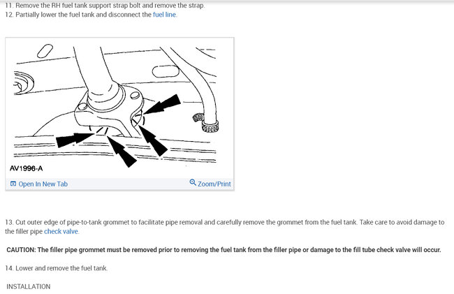

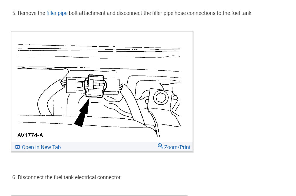

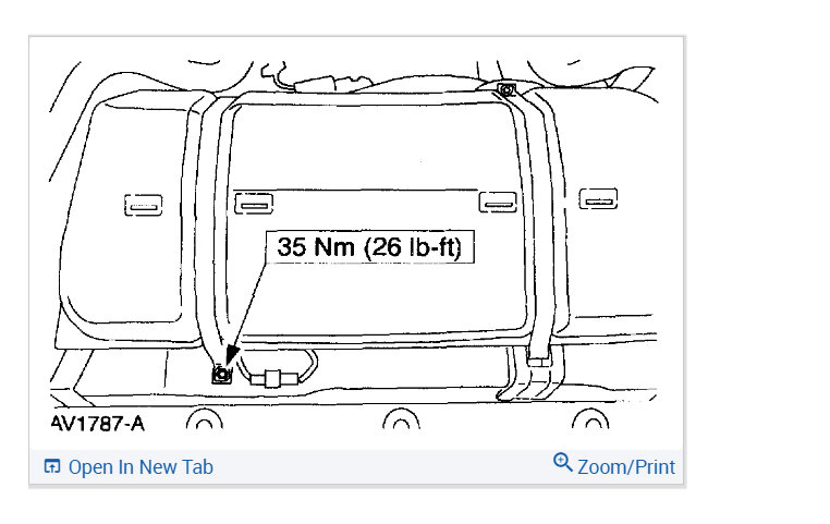

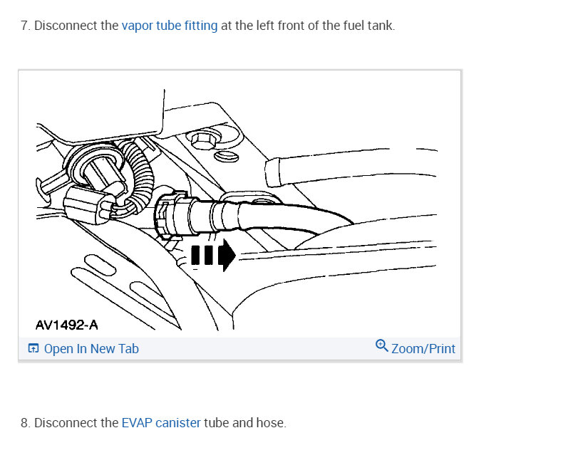

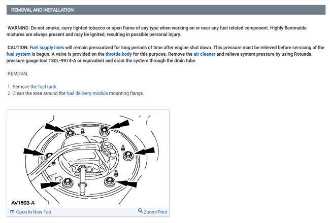

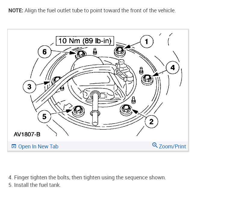

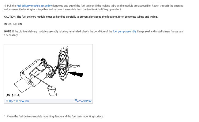

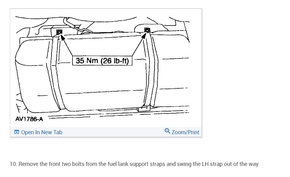

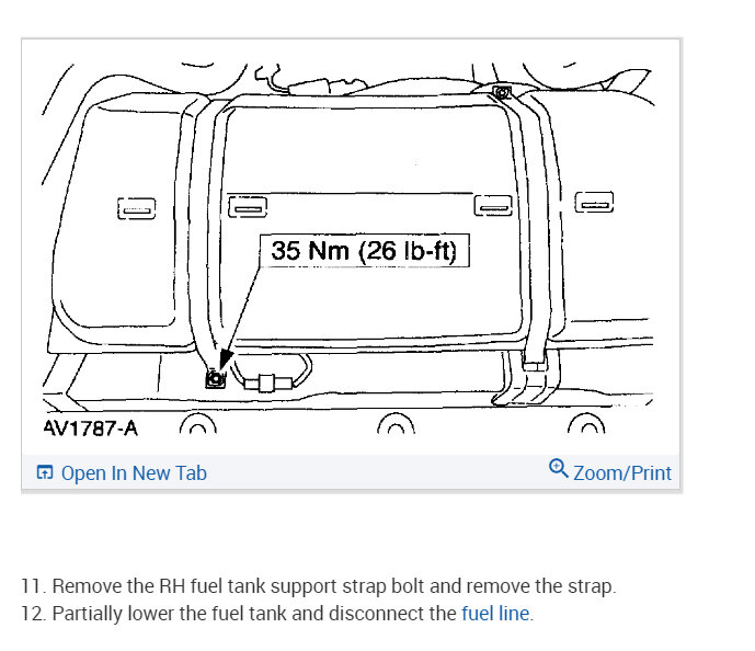

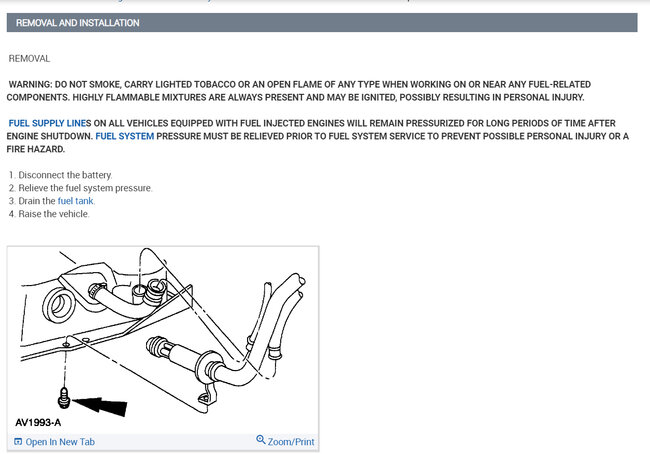

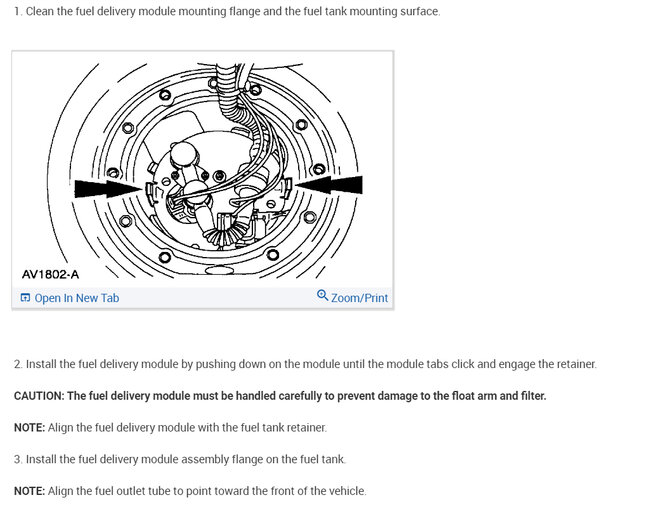

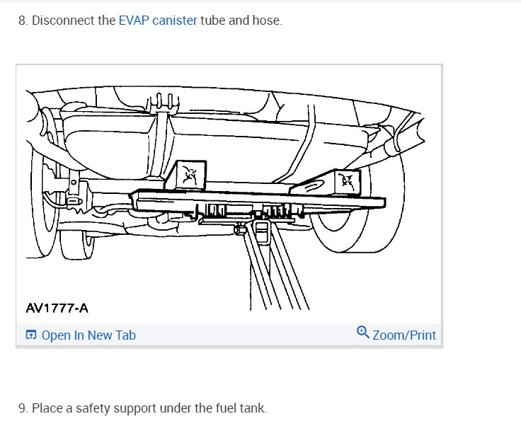

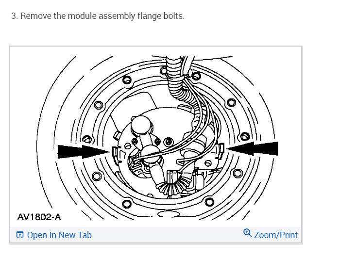

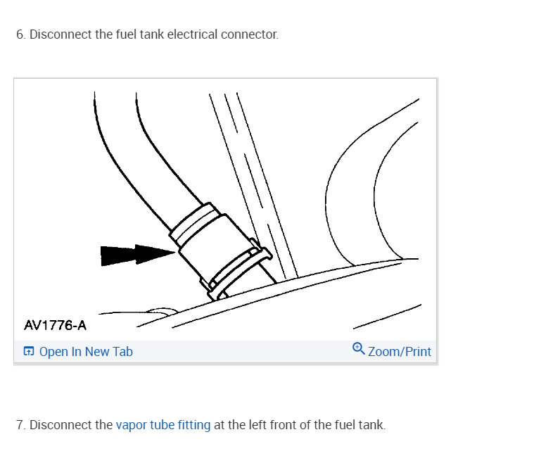

It has two Bosch 130 fuel pumps? Is this some kind of race application? If the fuel pump is good then it could be the fuel sock at the pump is clogged or you have a bad fuel pump, it is a deadhead system so there is no regulator which only leaves the fuel pump as being bad. Here is how a stock application is changed out. the video shows how to drain the tank:
https://youtu.be/Q5MH2gnyFH0
Check out the images (below). Let us know what happens and please upload pictures or videos of the problem.
Feb 6, 2023 at 3:02 AM

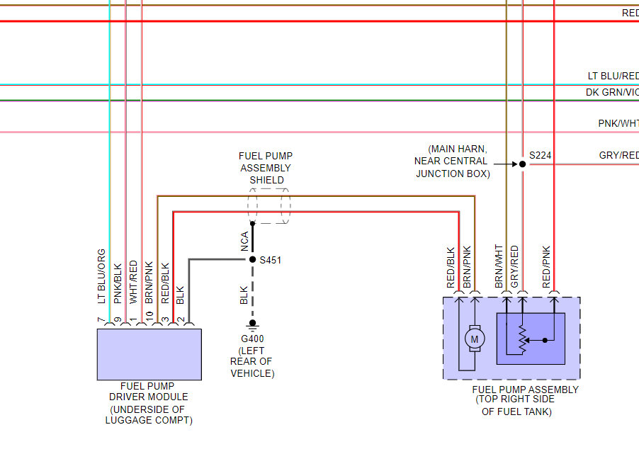

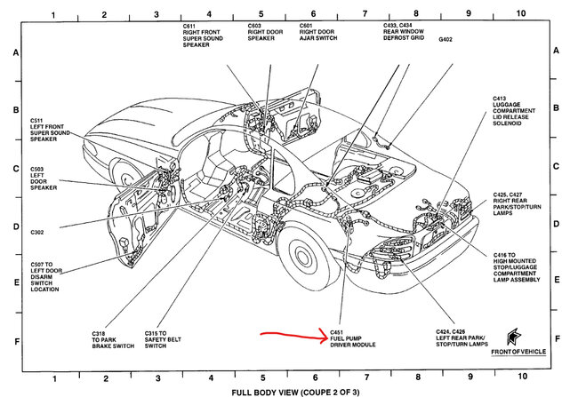

Are you sure the gauge is correct? It is a deadhead system so there is not to much to it. Pump and power, can you confirm you have 12 volts to the pump? Here is a guide to help and the fuel pump power wire color (red/blk) so you can do the test.
If the voltage is low, I would change out the fuel pump control module and check the ground as well. Check out the images (below). Please let us know what you find.
