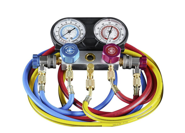

You can also get a gauge set and check the pressures yourself. I will add an image of them for you.

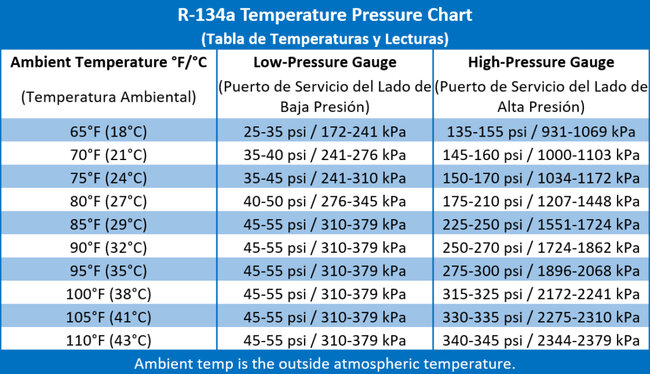

I am also adding a temperature chart for you. These ranges are approximate values. Keep in mind if you do use gauges to check it, some refrigerant will be lost.

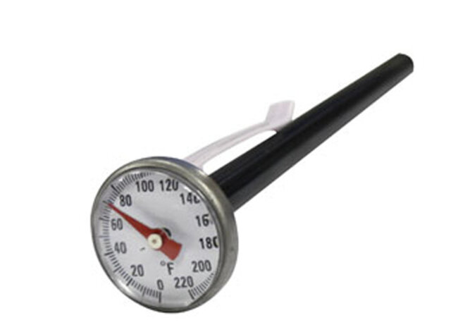

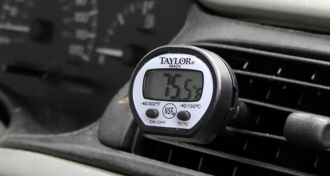

A good accurate way to measure the temp coming from the vents is with a food thermometer or something similar. He could use this to keep an eye on the temperature. They have ones that clip onto the vent as well.
