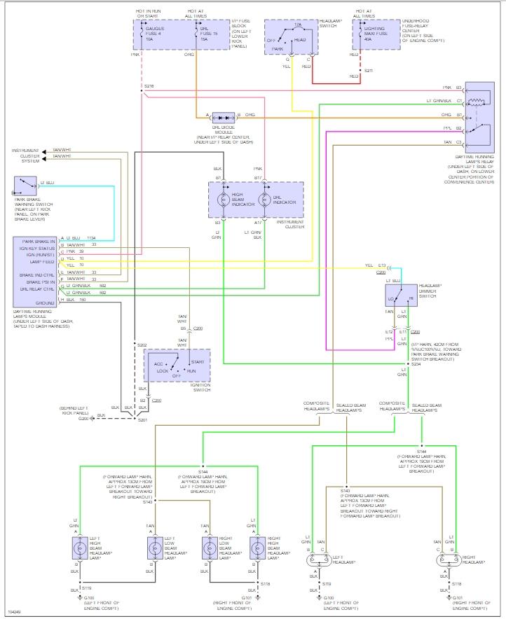

I have pulled the fuse to my daytime running lamp system because i did not want to burn up my H.I.D bulbs quickly. what i want to do is disconnect the system right at the headlight itself if possible and disconnect the low beams from the daytime running light system and wire the system to light up accent lights built into the aftermarket headlights i have know. how could i wire the system to run the accent lights on the drl system with out any low beams coming on unless i manually turn them on.

I,m not sure what you are asking do, but here is a wiring diagram for the DLR's
