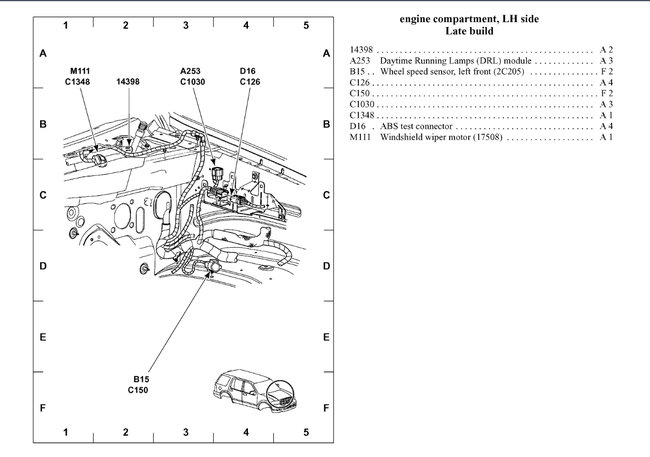

I am trying to figure out the location of my DRL module. It is is a four door, XLT. This is a 4.0.
Thanks
Feb 11, 2018 at 1:26 AM
  • 55,583 POSTS

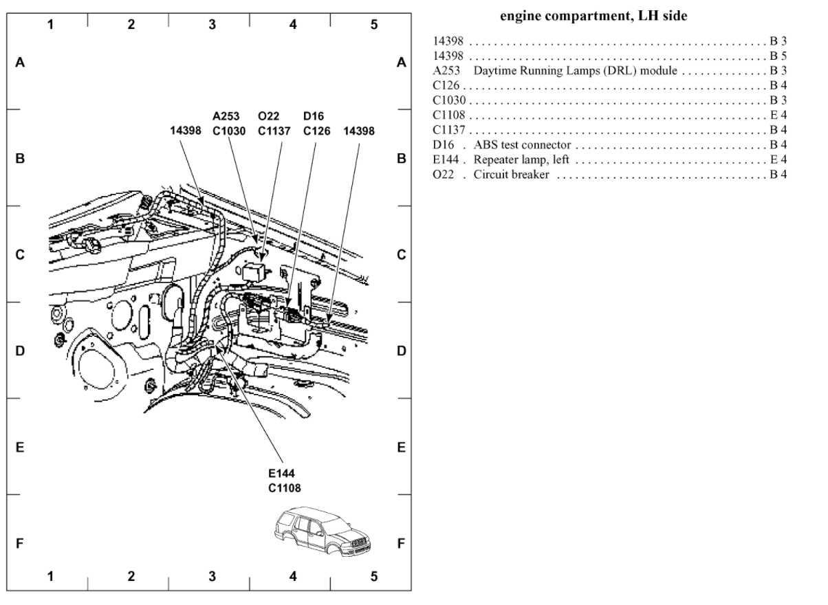

The DRL module is located on the left side of the engine bay. Here is a diagram so you can see what I am talking about. Check out the diagrams (below). Please let us know if you need anything else to get the problem fixed.
