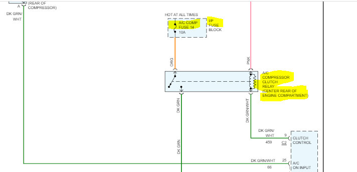

Driving with a bad air compressor.
Aug 10, 2023 at 12:11 AM
  • 110,244 POSTS
Are you referring to the AC compressor or something different? If it is the AC compressor, as long as the pulley still turns freely, it shouldn't hurt a thing. However, if it is locked or damaged, it will damage the belt.

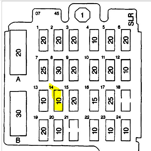

If you want, you can remove the AC compressor fuse in the instrument panel fuse box. It is fuse 14 in the box. See pics below. If that is removed, the compressor will not receive any power.
Let me know if that is the one you are referring to or if it is something different. Also, let me know exactly what is happening.
