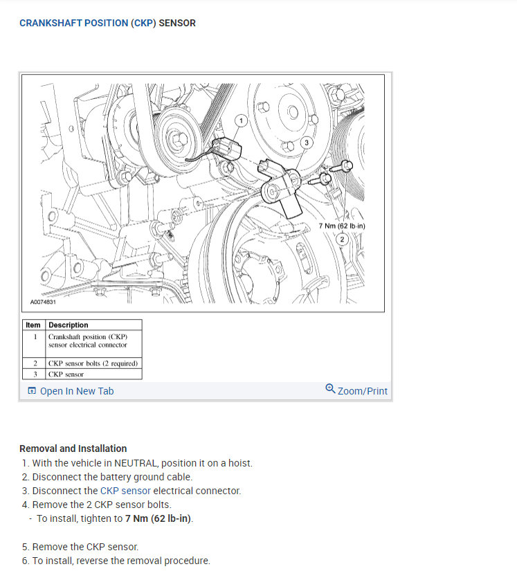

My vehicle was running great then while driving it started to sputter and shut off but would start back up. got it home will not start up. replaced crankshaft position sensor and camshaft position sensor still no start. I tried to check for spark could tell i did the starting fluid into throttle body. i thought maybe gas, so i replaced fuel filter. With both new filter and starting fluid no fire. I must also note i didn't relearn the new crankshaft position sensor as i don't have the machine to do it.
