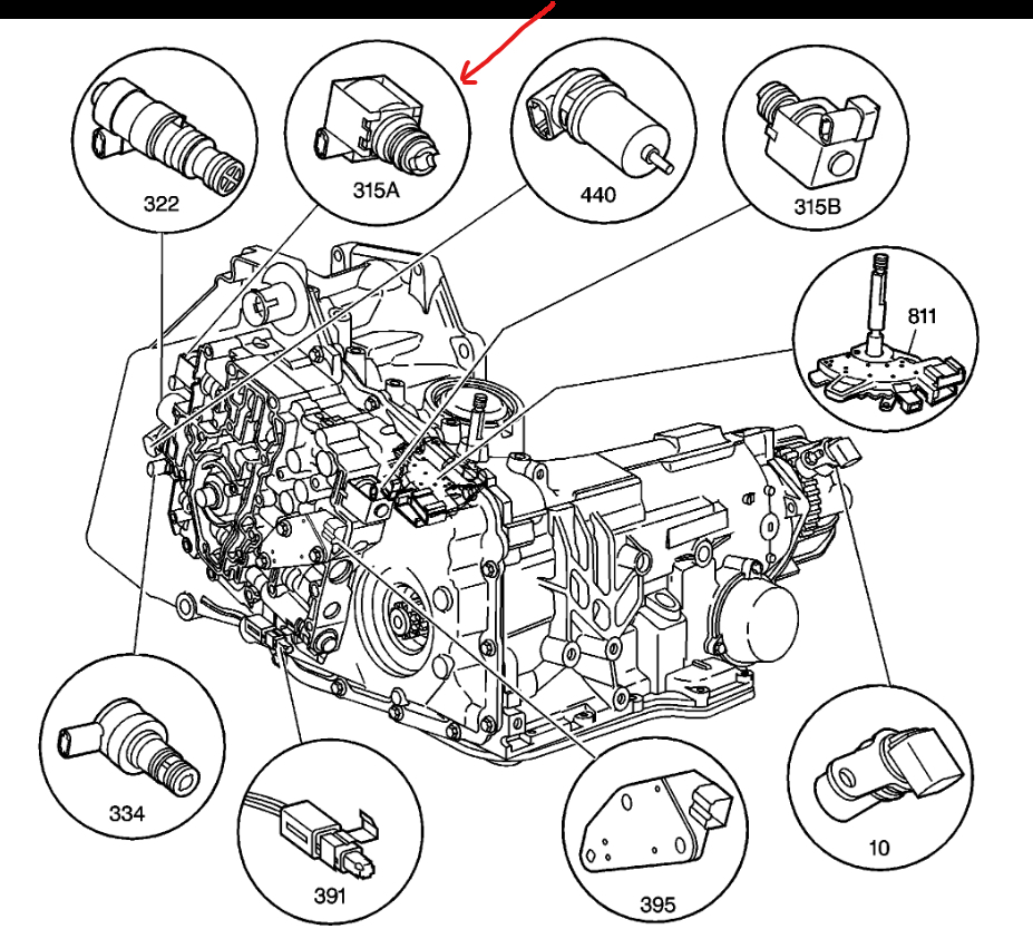

Car will only go forward in second gear.
Aug 27, 2023 at 4:53 AM
Experienced Mechanic
55,604 POSTS

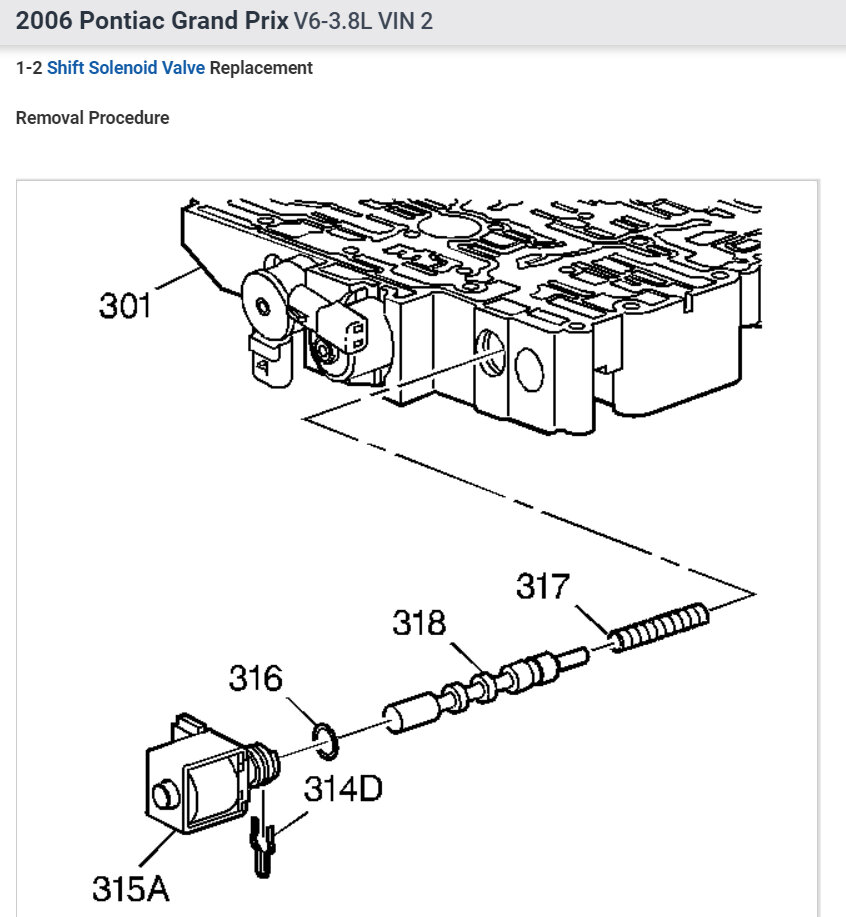

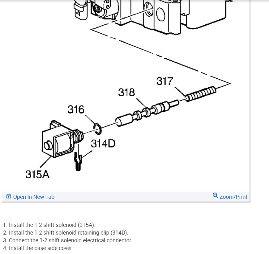

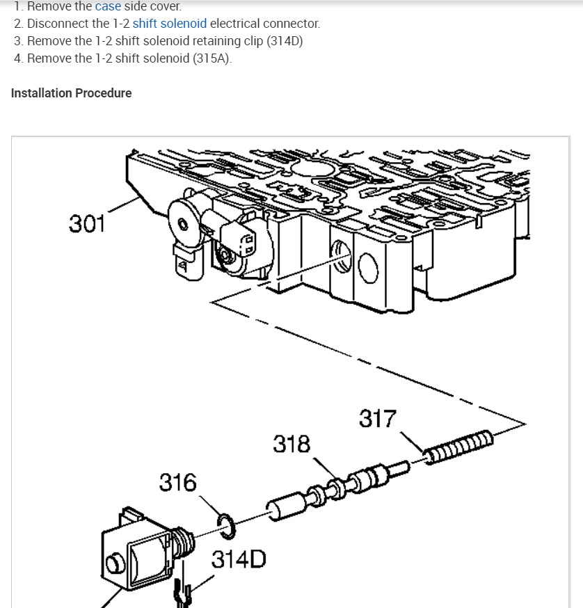

This can mean the first gear shift solenoid needs to be replaced but we should run the codes first, here is a guide to help:
Here is how to change the shift solenoid out in case you need it. Check out the images (below). Please let us know what happens.
