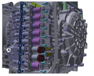

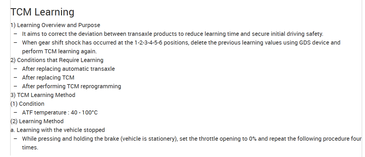

Does it make any strange sounds while it is in gear and not moving forward? If not the transmission can have a hard part broken inside so the unit will need to come apart and inspected. The only other thing I can think of is the pressure regulating control solenoid but usually it will have a code for it, also you can try a relearn which I have provided. This can also be a bad TCM, I would remove the electrical connector and look for corrosion at the connector. Check out the images (below). Please upload an image or a short video in your response, so I can see what's going on.

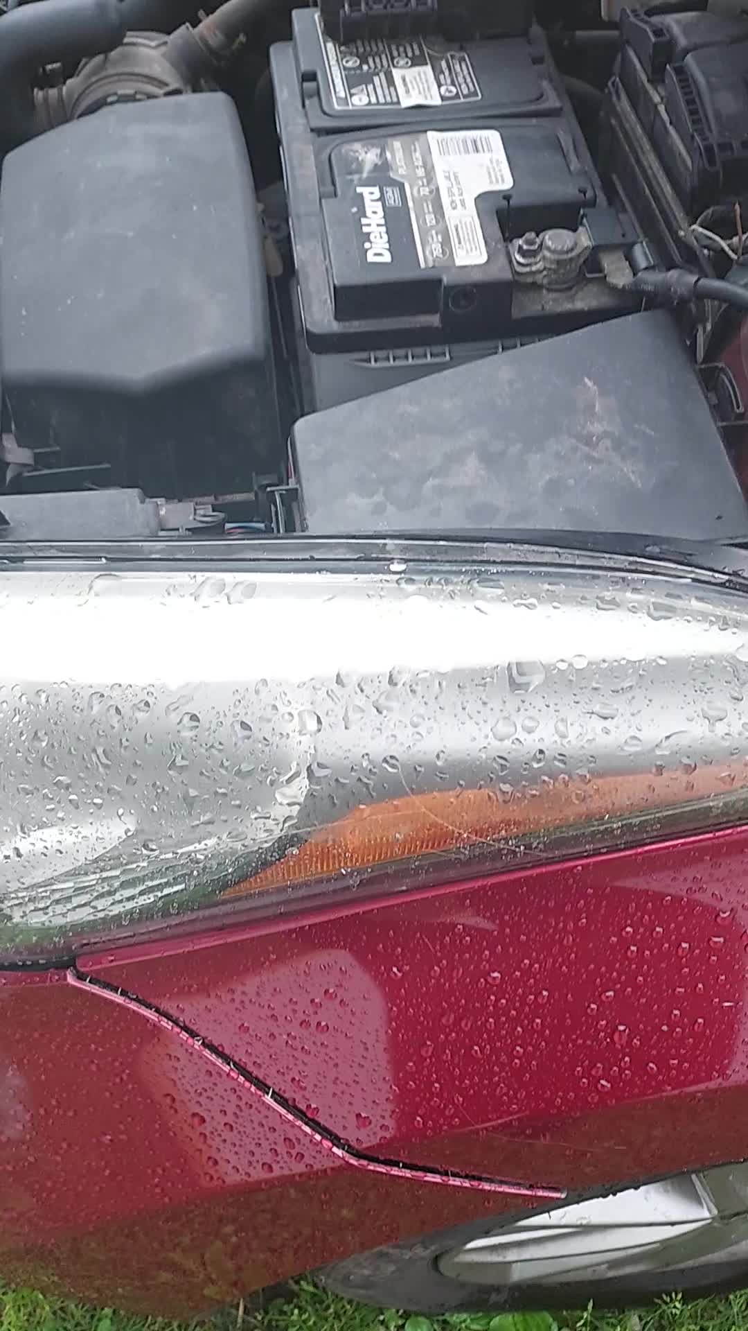

which electrical connector should I take pics or videos of? also, I took it to a auto shop for some repairs (body repairs) and when I got it back the people that worked on it messed up a few things and I had to have someone else fix what they messed up. so I honestly think that they may have did something to it because it didn't start acting up til after I got the car back.

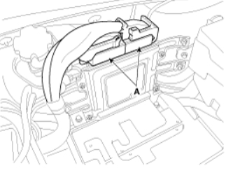

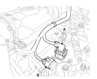

Yep, that might be true but until we find the problem we don't know. Since there is no codes chances are there is somethin wrong inside the transmission or the TCM is bad. I would check the electrical connectors first though. One is at the transmission case and the the other is a the TCM near the battery, here are the locations. Check out the images (below). Let me know how it goes

I'm going to check those connections today and send some pics. in the meantime here is a quick video I took when it first started happening.

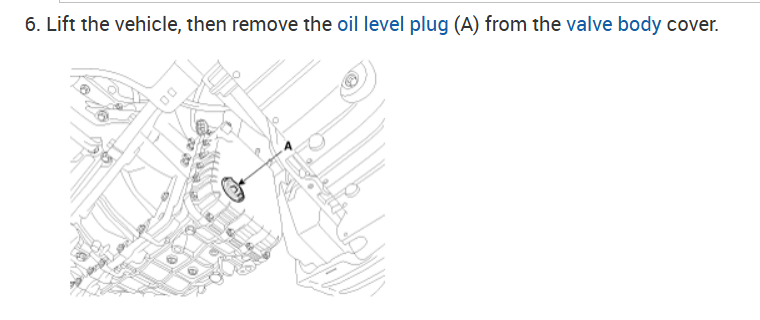

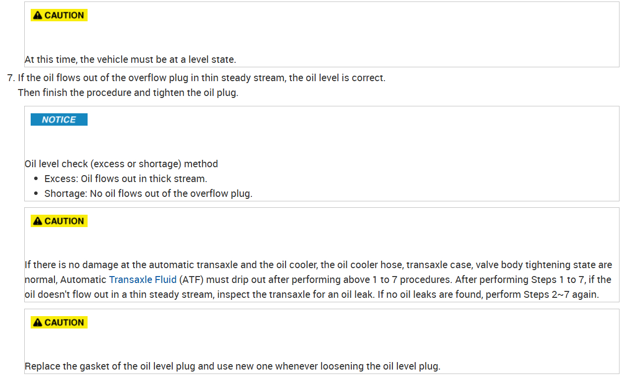

Thanks for the video, it is either low on fluid or the transmission is broken internally, you can hear it when the engine is running. Here is how to check the level. Check out the images (below). Please let me know what happens.
