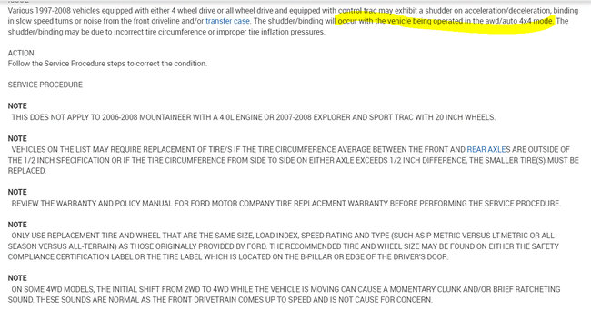

The vehicle listed above has an automatic transmission with the four auto 4 x 4 low transfer case. When driving down the road in four auto I have a really bad vibration almost feels like a bad u-joint, but if I put it in for high and drive it down the road the vibration disappears. I’m stumped.
Jan 22, 2022 at 6:35 AM
  • 110,244 POSTS
That is an interesting one. The idea that it happens in automatic 4wd leads me to think the system doesn't know if 4wd is needed. Basically, this is a rear-wheel-drive vehicle until the vehicle speed sensors identify variations between the rear and front wheel speeds.

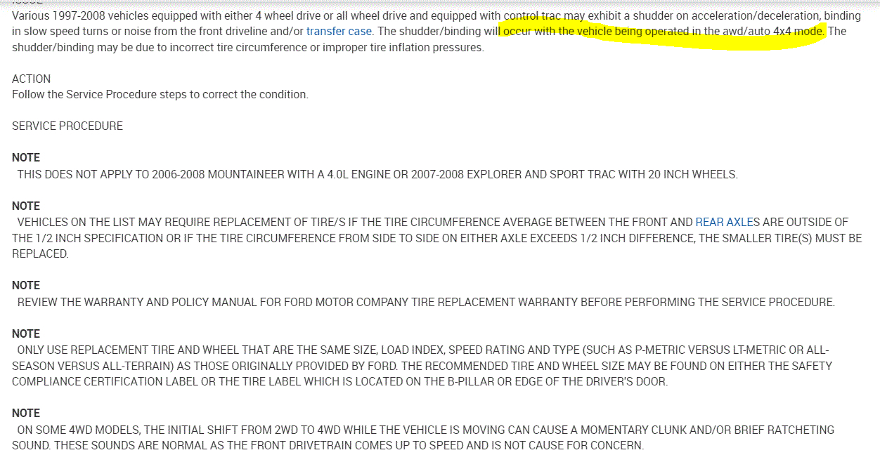

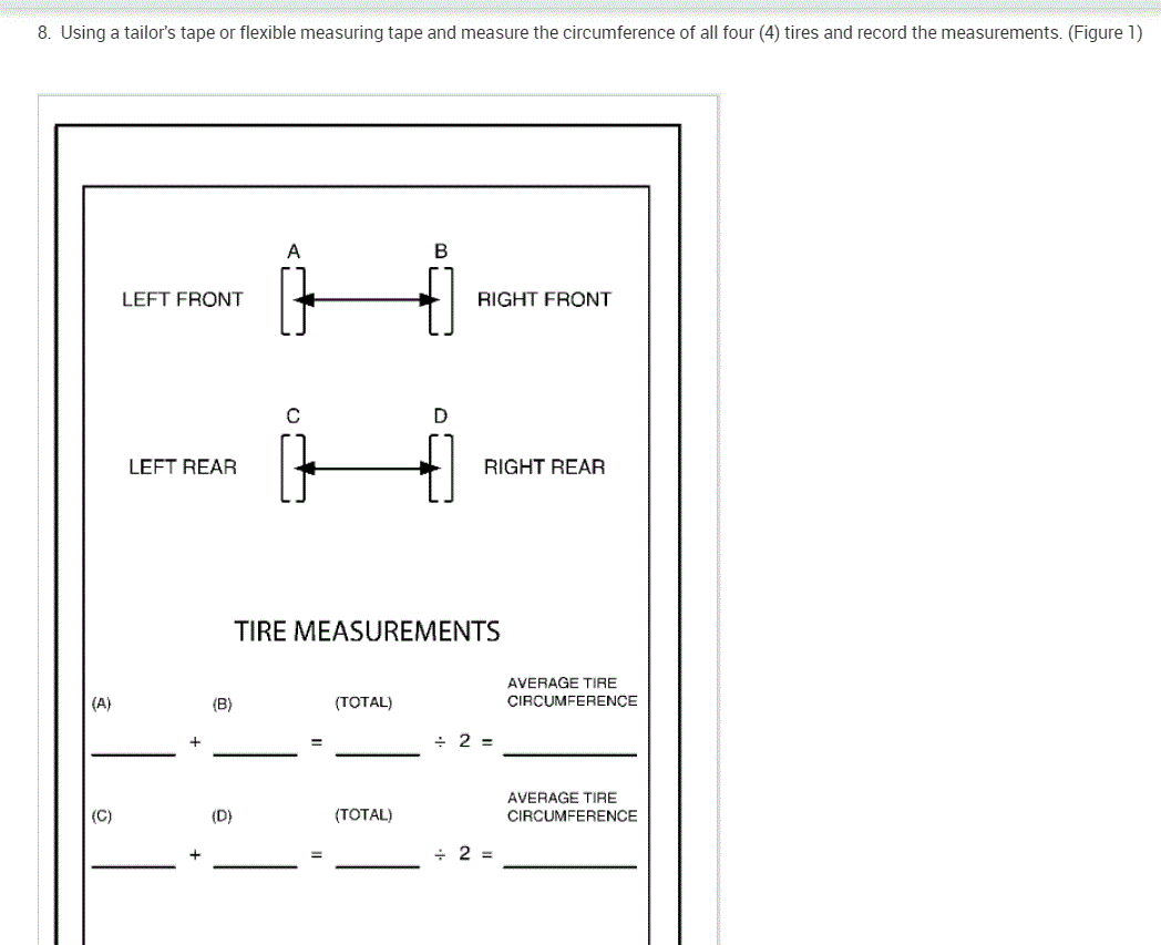

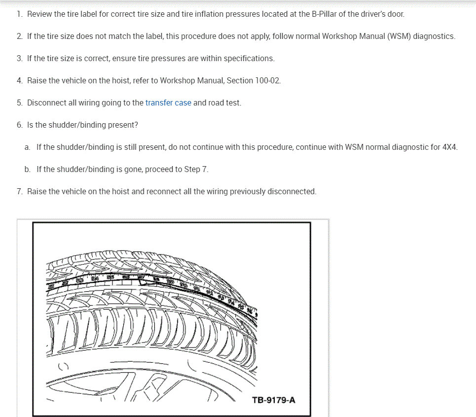

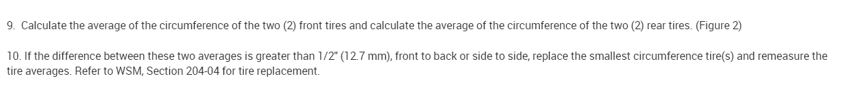

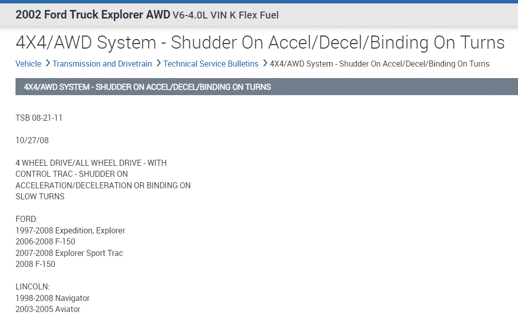

I have to ask a question. By any chance are the tires different sizes or do you have good and worn tires mixed? I was able to find a technical service bulletin related to a shudder only when in 4wd auto. Take a look at it below and let me know if you feel it fits what you experience.
