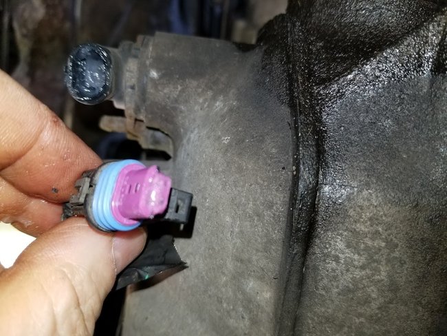

If the transmission output speed sensor is defective the speedometer will remain at zero. When driven fast enough to cause the transmission to shift, it will shift with a damaging hard jerk. The car computer will set a P0722 fault code and the dash display will read "power steering". The power steering motor will not receive a signal to operate.

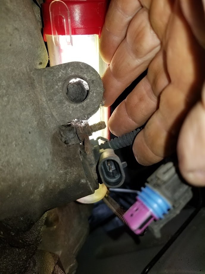

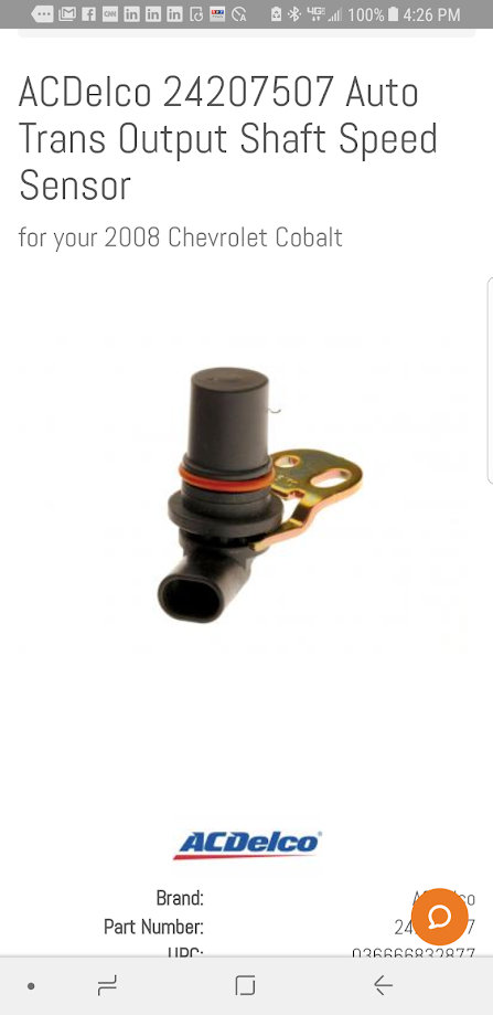

The transmission output speed sensor is located on the passenger side, the back side of the transmission, near the firewall, above the right drive axle, and can be reached from beneath or from above. The connector has one release tab and is very water tight. The wire colors are violet and yellow. They connect to the engine control module (ECM). When the sensor is defective, this causes a P0722 code. One hex bolt and O-ring hold the VSS. Replace the O-ring if disturbed. Clean the area before removing the VSS to keep specs of dirt out.

Yes, replacing the VSS and clearing the fault fixed the dead speedometer, the "power steering" fault, and horrendous rough shifting. The engine speed showed on the OBDII software. Driven more than one hundred miles and still going strong.

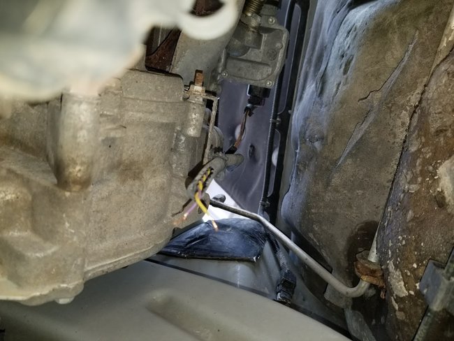

So, we are looking for a bunch of metal under the hood with a black plastic female connector. Great. Pictures help not at all if you don't explain what we are looking at.
Aug 4, 2023 at 5:51 AM
  • 55,649 POSTS
Sure, here is a better shot of the VSS location. Check out the images (below). Please let us know if you need anything else to get the problem fixed.
