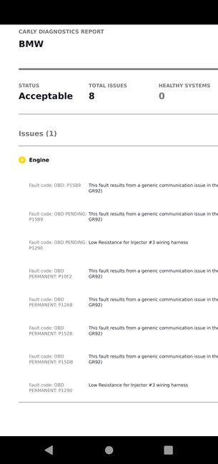

I keep getting fault code 120408 with attached codes: 801c11
00429A
0028b6
801222
118002
002EF7
I'm no mechanic here at all by any means, all i know is from the extensive reading and research I've done on my own. The wastegate was stuck closed. I was able to get it freed up. The charge pipe was loose, I was able to get it back sealed and on snug. I've replaced MAP sensor, boost pressure sensor, HPFP, and the vacuum line from the top of the engine to the breather box. The car drove so much better. But these codes won't clear, and the attached codes are really throwing me off. I'm also getting the code U1164, I have repeatedly checked the connections to the ECU and tried clearing that code as well, with no success. Thank you in advance for your help and your patience with me and please forgive my terminology ignorance here. :)

Yes, the charge pipe has been checked and secured. I have a picture of the p codes.

Thanks for the updated codes. Interestingly, some I show and others not. After going through them and thinking you were hearing a noise, the one that caught my interest was the P10F2. That isn't a generic communication code as mentioned on the printout. It indicated the charge air pressure is too high in relationship to the barometric pressure.
Have you checked the wastegate? Its purpose is to divert excessive exhaust gases away from the turbo. It controls the speed of the turbine preventing it from spinning too fast. I'm questioning if that is what you hear.
The P12A9 indicated a pressure difference also and is related to the after-run. The after-run determines whether the ambient pressure, intake-manifold pressure, and charging pressure sensors are all registering a single pressure reading.
The remaining codes are not found in my manual for this year, make, and model.
