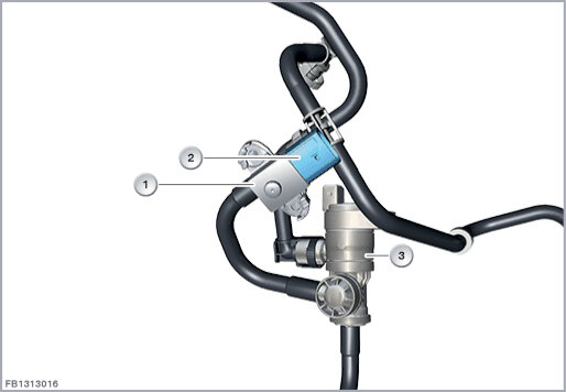

I cannot seem to find the part number for differential pressure sensor, can you locate it?
Jun 21, 2023 at 11:56 PM
MATHGEN
  • 128 POSTS
The Venturi nozzle pressure sensor is a differential pressure sensor installed in the tank ventilation line near to the intake manifold in the engine compartment.
This differential pressure sensor in the tank ventilation line is used for diagnosis of the second discharge point of the tank ventilation system. The Venturi nozzle pressure sensor is only required in the US version.
The part number I came up with is 17137448091. After a short search, it seems this part has been discontinued by the manufacturer.

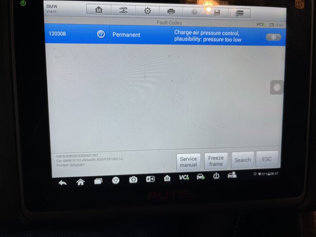

I replaced the pedal with the sensor and still getting one code which has nothing to do with it. Only code i get when i drive it a bit and get the message is attached. I can tell the turbo boost is not there. I also replaced the harness to the tank vent sensor. Only thing i did before installing any parts was adjusting the waste gate length as these always get loose. Do you think its possible that this adjustment could be what is causing this boost code? Maybe i adjusted it too tight or too lose?
Jun 27, 2023 at 8:46 AM
MATHGEN
  • 128 POSTS
Yes, if the actuator rod is not set correctly it could hold the wastegate open a bit and open too much. This would affect boost performance.
Jun 27, 2023 at 9:25 AM
