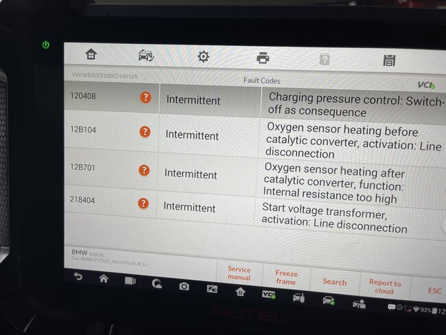

I have experienced this problem for 2 weeks. It’s showing up when accelerating and disappear after one day, and return again when push up gas. I scanned the car and the codes as you seen. Any ideas?

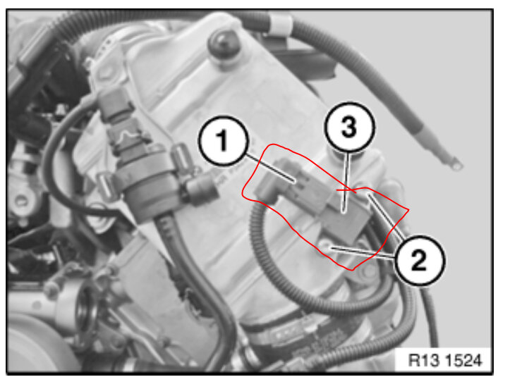

The codes are likely related to the charging pressure switch. However, the codes you have indicate what appears to be an electrical issue.
I attached a pic below of the switch's location. Check the wiring to the switch along with the wiring. Make sure nothing has been damaged.
See pic below.
