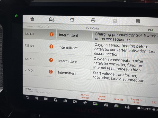

Drivetrain malfunction?
2014 BMW 750LI
69,000 MILES • 4.4L • V8 • TURBO • 2WD • AUTOMATIC
RATEB AL-FAKHOURY
I have experienced this problem for 2 weeks. It’s showing up when accelerating and disappear after one day, and return again when push up gas. I scanned the car and the codes as you seen. Any ideas?
Apr 26, 2023 at 3:51 AM
  • 110,194 POSTS
The codes are likely related to the charging pressure switch. However, the codes you have indicate what appears to be an electrical issue.

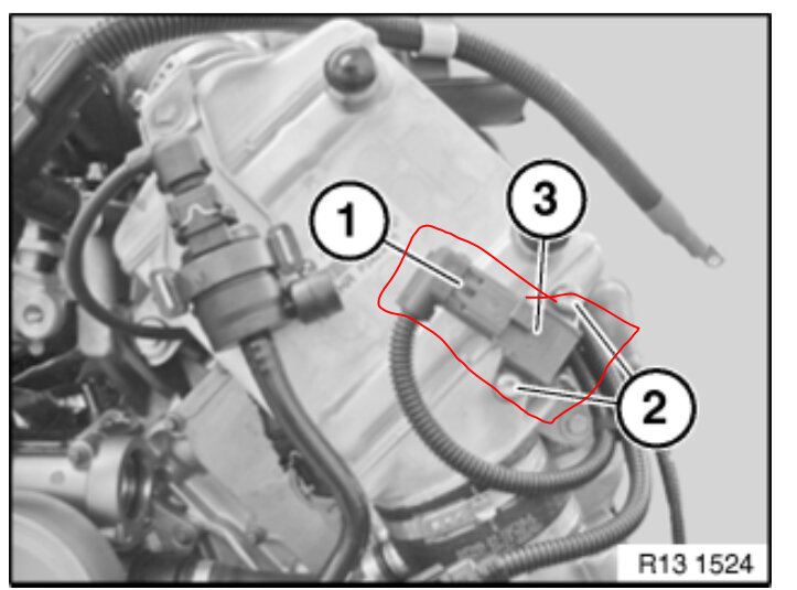

I attached a pic below of the switch's location. Check the wiring to the switch along with the wiring. Make sure nothing has been damaged.
See pic below.
