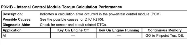

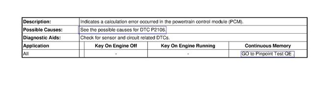

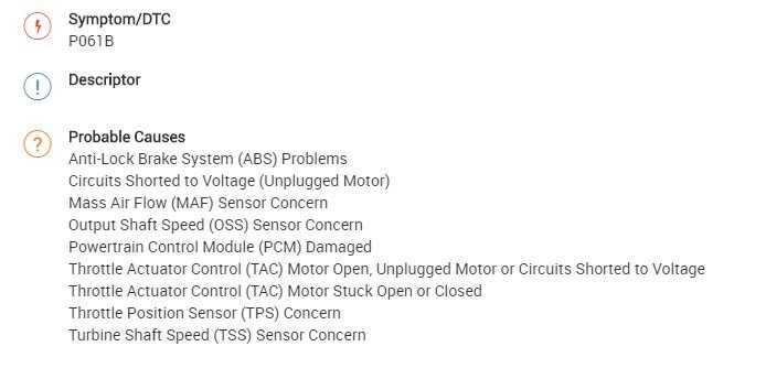

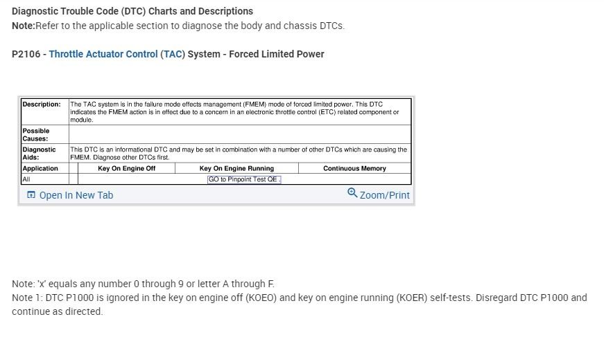

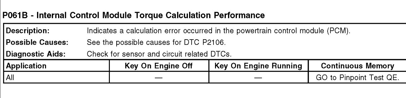

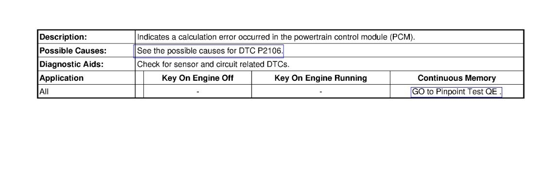

Here are the codes are per AutoZone: P061B, internal control module torque calculation performance and P2106 Throttle actuator control system-forced limited power.
Feb 28, 2020 at 12:13 AM
Okay, thanks.
This looks like a communication issue with the ECM and the other modules.
It could be either a re-flash needed or the ECM itself. The fact it happens in wet weather only could be from a connection at the ECM or the throttle actuator. I would clean the connections and use dielectric grease for a better connection.
