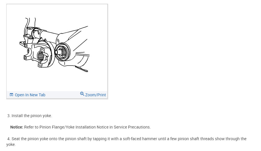

I replaced the driveshaft yoke on the axel. But I didn’t count how many turns or mark it before I took it off. Now I noticed a vibration when I take my foot off the gas. How do I find the torque the nut needs?
Jul 24, 2023 at 4:50 PM
  • 110,248 POSTS

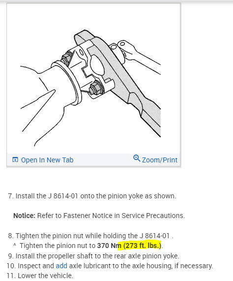

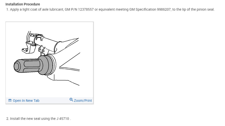

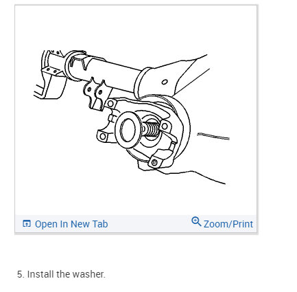

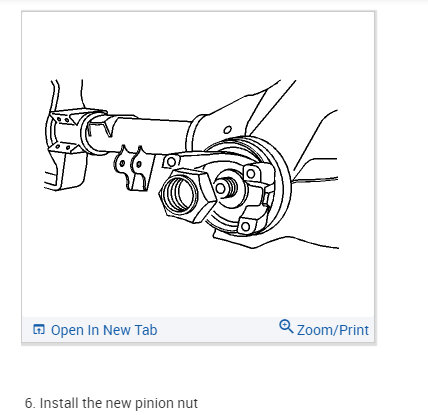

There are two different differentials that were used on this vehicle. If you have a 9 3/4", I have the directions for reinstalling the yoke.
I attached the directions below. Let me know if this helps or if you have other questions.
See pics below. Note: The directions came from the directions for replacing the pinion seal. That is why it mentions the seal.

The information I provided is for a 9.75" differential. If that is what you have, it will work. As far as removing brakes and all, that should have been done before the nut was removed to determine how much torque was required to turn it. Then, in small increments, the nut is retightened to achieve the same.
