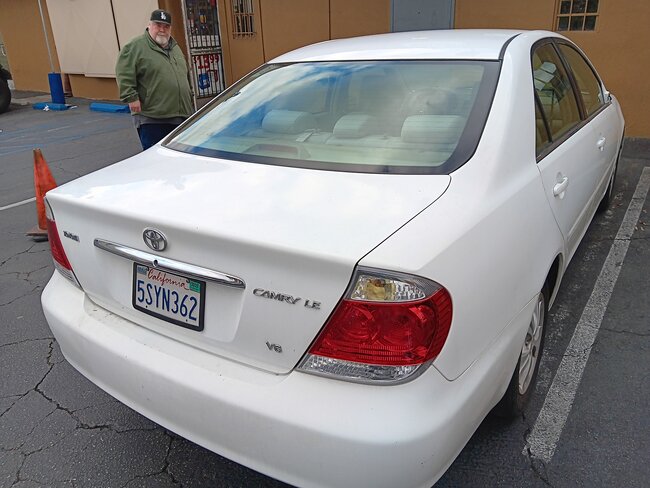

Car shakes violently when accelerating over 30 MPH. Otherwise, everything works well. Just bought the car and need to get it fixed.
