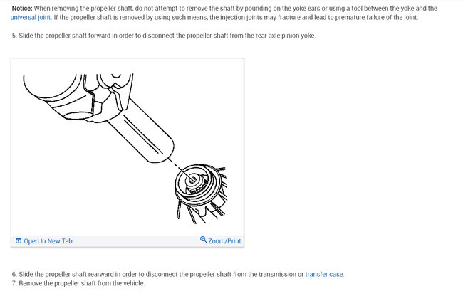

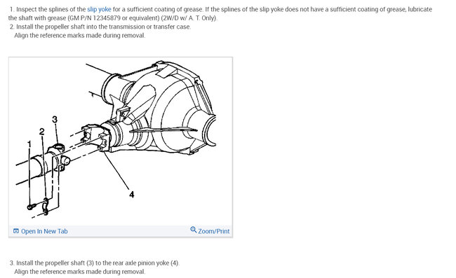

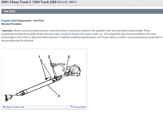

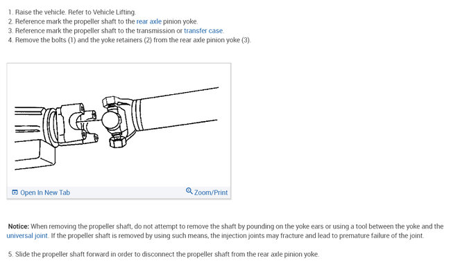

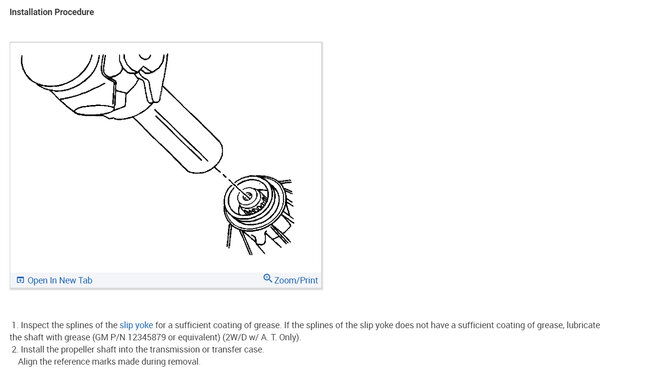

Are you sure it is the spider gears that are bad because a bad ring or pinion gear will make it, so the driveshaft doesn't turn. Anyway, remove the driveshaft from the differential and see if you can turn the driveshaft. This will help us see which side the problem is on. Here is a generic guide to help you step by step with instructions in the diagrams below to show you how on your car:
https://www.2carpros.com/articles/how-to-remove-a-drive-shaft
This video may help you as well. It shows how to get the axles and spider gears out.
https://youtu.be/ytqXLSjHNm0
